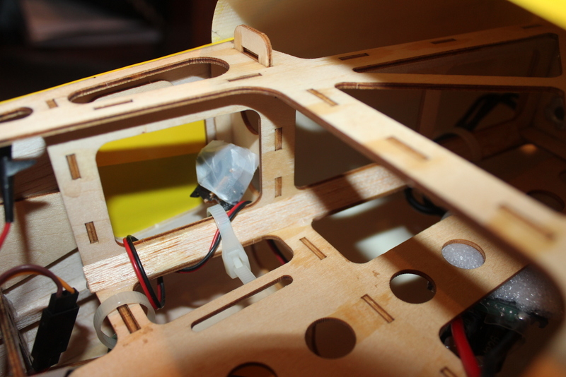

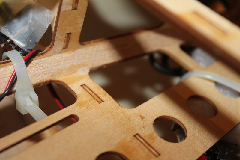

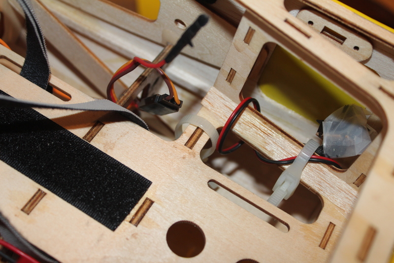

Get home and upon close inspection notice the arming switch is zip tied under the battery tray wrapped in scotch tape and he is also running a Castle 10A BEC

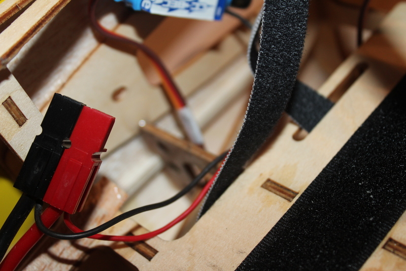

Whew...that tired me out. Question......I never run external becs why would he have a Castle 10a BEC wired to the esc plug that the lipo plugs into when the Air Boss 80 has a 5A BEC 4.8 to 8.0 V?

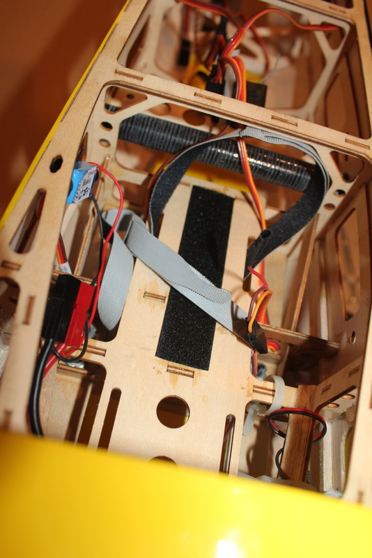

I'd prefer not to run it the way it is wired as to many things look awry besides the non arming. The casle Bec is wired into the ESC plug and thats two wires to come loose. Also....I have include some rather bad quality shots....I will get better ones tomorrow. Is there any way to rewire the Airboss bec to the arm switch and uninstall the Castle 10ABEC? I think EF would have called for it if were necessary(an external bec).. Here are my quick pix...Tomorrow I will pull the cowl and get better ones.
Sorry about the angles...I have a big DSLR and the plane is in an awkward place on the bed I shot the photos on. Thanks!

airboss is plenty fine for your application. The 5245 is one of EF's recommended servos, they've done plenty of testing on it.
If you want to remove the castle bec, just cut the wires off where they're attached to the main ESC leads, and remove it (apply electrical tape where needed).
Then, get rid of the tape from the red wire that was removed from the airboss servo style plug, and reinsert it into the plug.
Then use the setup as designed... the arming switch should work right away unless it was modified.

OK..so cut the Red and black BEC wires from the esc plug and then unplug servo wire from aux1 in RX. Then plug red wire that is wrapped with tape back into Airboss servo like lead and mount arming switch correct? Oh...forgot to mention Gary...he had a glacier 6S 3300 w/him and yet said he had to mount a small weight to the bottom of the tail in front of the rear tailwheel...Have you heard of the MXS having CG probs like that? He said he was, for 3 flights, running the Lipo against the CT tube sleeve almost......the weight was 50 mm long x 12mm wide x 1mm thick. The CF tube fits incredibly tight in the sleeve and the left wing still will not mount flush against the fuse along the fuse/wing interface with the 1/16" gap starting at the teh trailing edge moving 4" toward the leading edge...Culprits...high sot on fuse where cross brace penetrations through the fuse from the factor are 1/32 high? He could not have flown this plane as I put MEGA force on the wing and the left wing tabs would not approximate. Don't want to break the dremel out yet!
