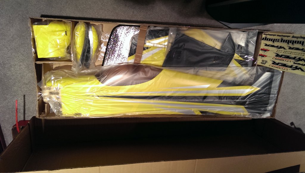

Here's a pic of the Vyper.......Sorry about the orientation...Got her from Shannon at Only Fine Helis. What is the fundamental diff between the V1 and V2?

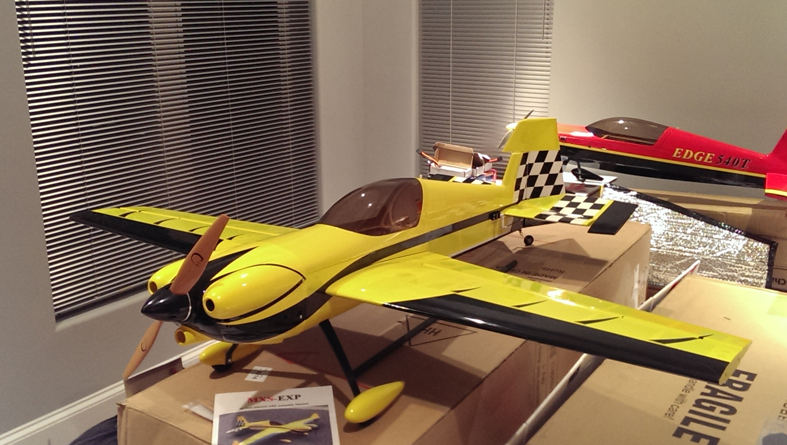

mxs.jpgThanks Snowdog!
Here is the infamous EF 64" MXS-EXP that is banned from flight til I mount the arming switch.
I hear there were three versions of the MXS...is that so?
My flying buddy had one and said he sold it after two flights as he did not like the feel if it vs the EF EDGE 540T....FWIW..NADA.
