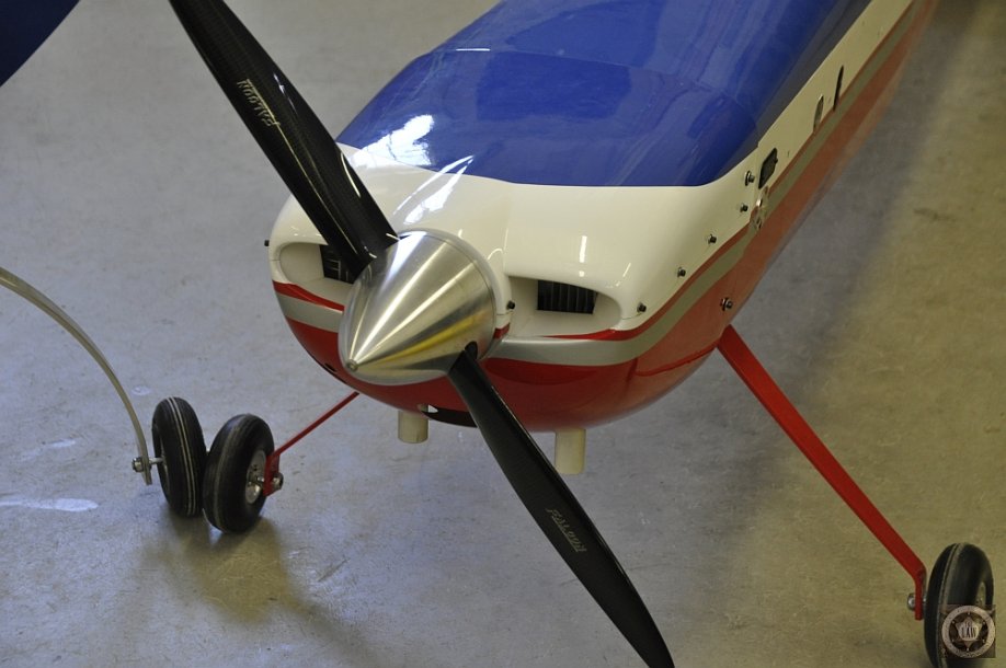

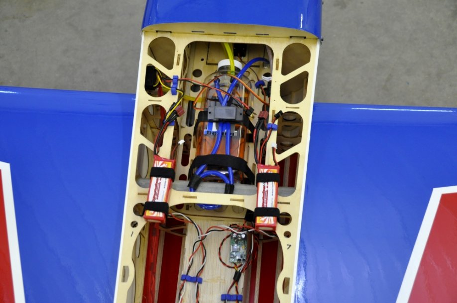

Well I removed 6.5oz by re-calculating the CG, removing the battery tray, changing from A123's to LiFe batteries (same mah). I also added in some mixing and rates so my snaps don't look like a monkey http://www.GiantScaleNews.com/forums/images/smilies/205.gif a football.
That two piece cowl sure does look good.. wish this one was a two piece.. but im not taking the chance screwing it up
