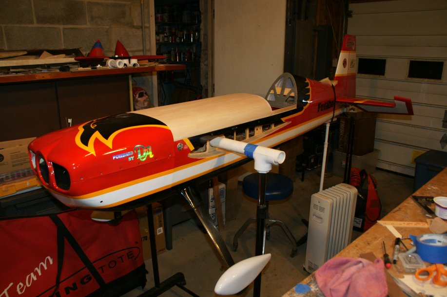

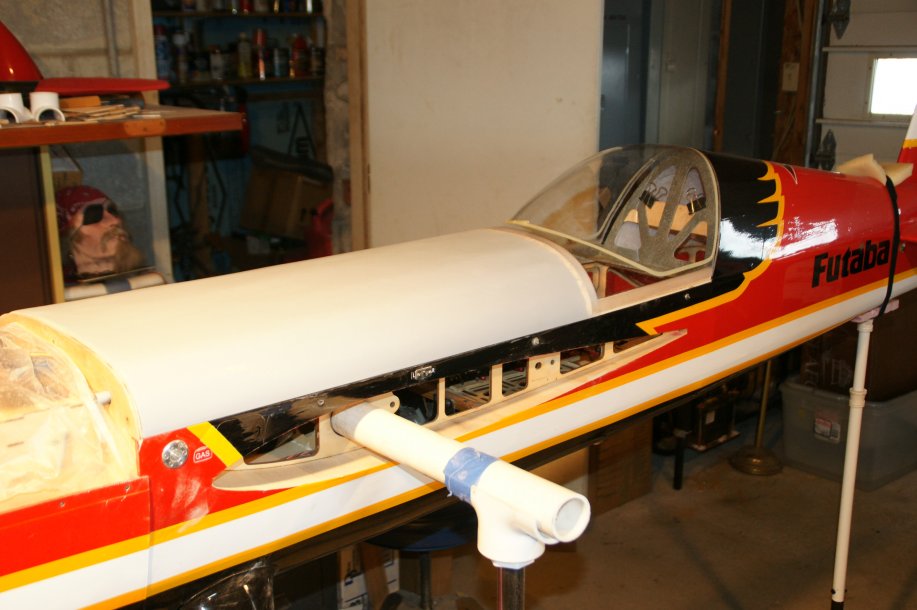

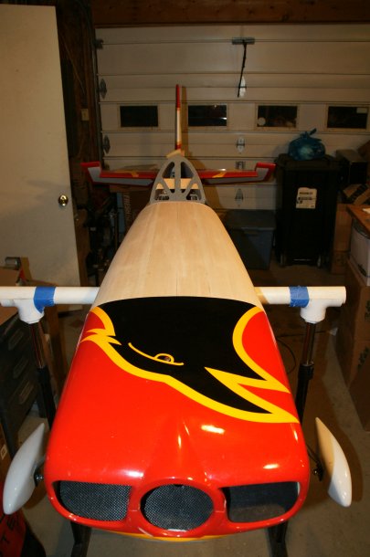

Sheeting done and ready for glassing. I'm really happy with the way this turned out:banana-dance:.
Next up is to finish cutting the canopy and mount. I'm going to flush mount it on the deck, so I left a small relief around the front (above the panel) and along the side rails. Then it's paint time.

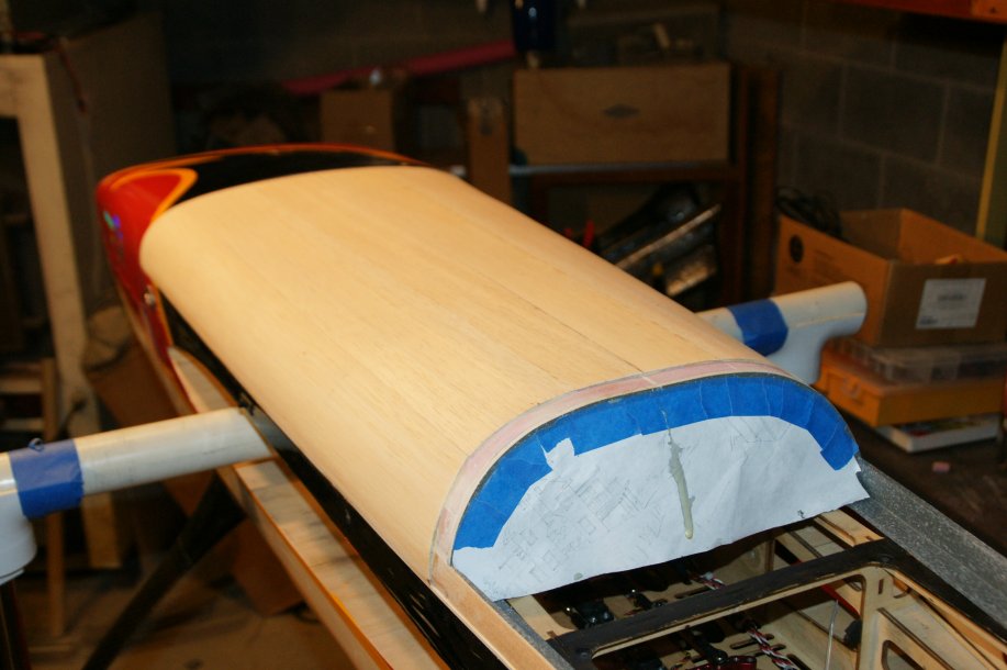

Meanwhile a little more done on the Raven canopy. Primed and sanded. Canopy trimmed for a flush mount and roughed up on the inside where it meets the wood for gluing. Will pick up some Goop tomorrow and get'r glued. Trim tape shows where the paint line will be. Capt Jack waiting patiently on the bench :pirate:
