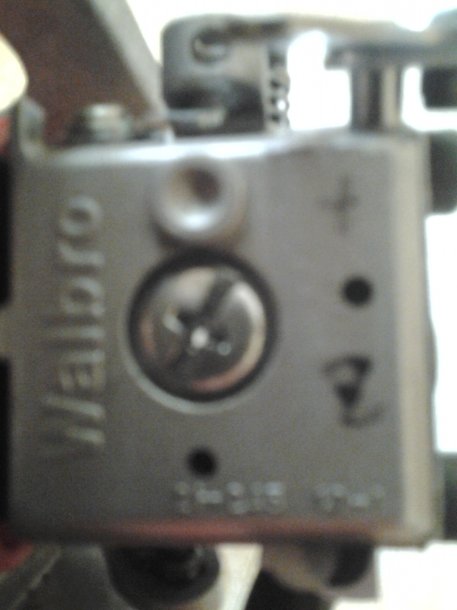

I'm going to soak that reed in gas today & try to start it again if it quits raining. If that doesn't work, with the bran new carb & all, I'll have to send it in to DA I guess.

Wet the pump side of the carb, the one with the single screw holding it on, once wet she should pull fuel, if all else fails, squirt some fuel down the mufflers, with igni. off, turn prop threw compression a few times, igni. on flip, vroom vroom.

Sounds good & I will try that also !! Once we tried putting gas in the cylinders through the plug hole, turned prop a little & out went all the gas !!
Thanks ChickenBalls !!
Oh, what's this mean, I can't figure that out ? !!
"Wet the pump side of the carb, the one with the single screw holding it on,"
Ooops, I know now what you mean !!
Thanks again !!

Looking at the 150 its on the bk side, the screw will look like this, just loosen it an squirt some gas in there to get it wet.

I just got done trying to start it again, but it won't even pop. I wet the carb inside the plate & soaked the reeds in gas for a while, put gas down the mufflers. She just won't do anything. Looking at the spark again, it looks awful weak to me. Now I'l probably have to wait a month for it to warm up again. I had to bring the eng. & batteries in the cause it's going to get cold & winter like again, so we'll see what I can do when the weather warms up again.
Big thanks again for everyone's help !!
