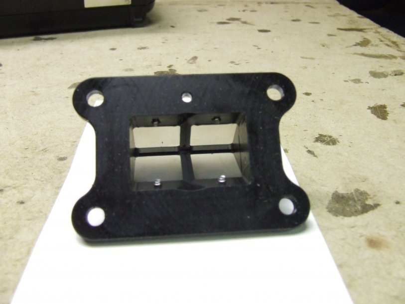

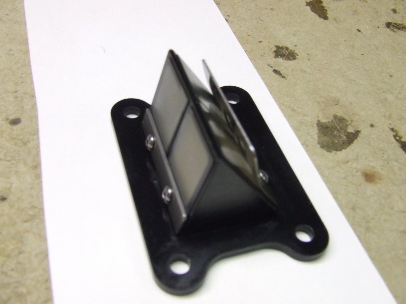

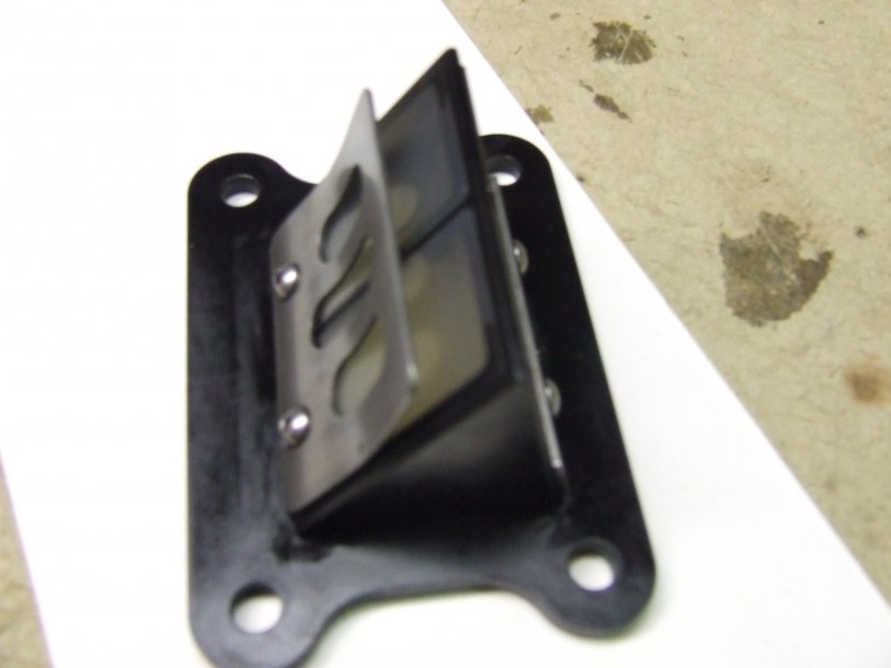

I got the reeds out & I don;t think they're stuck. The little pedals, little square & rectangle pieces will move outwards a little when I push lightly on them . Unless that metal piece is bent, which I'll bet it;s supposed to be, I can't see anything wrong with them. Here's some pictures I took of it !!
