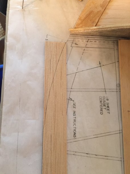

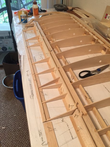

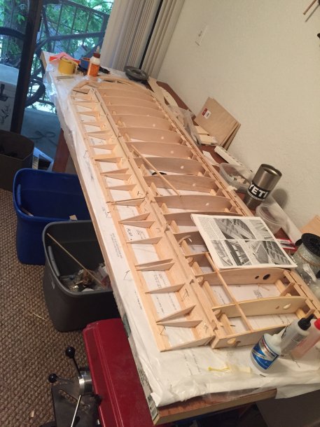

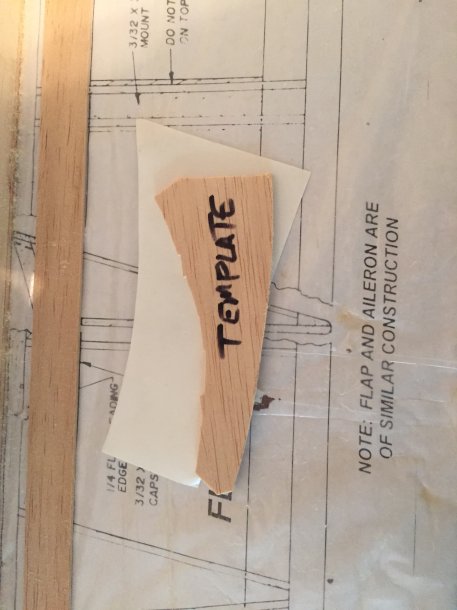

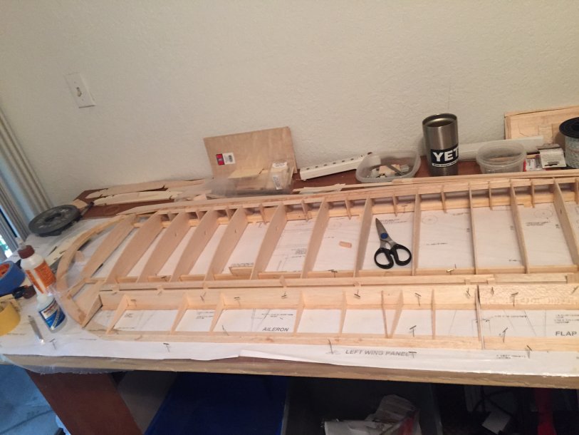

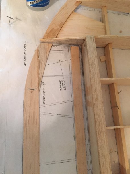

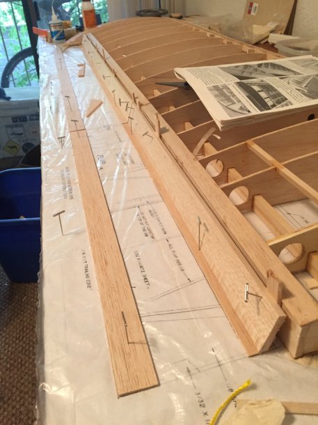

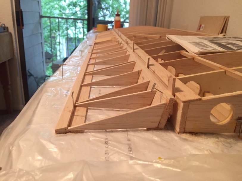

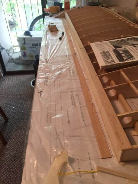

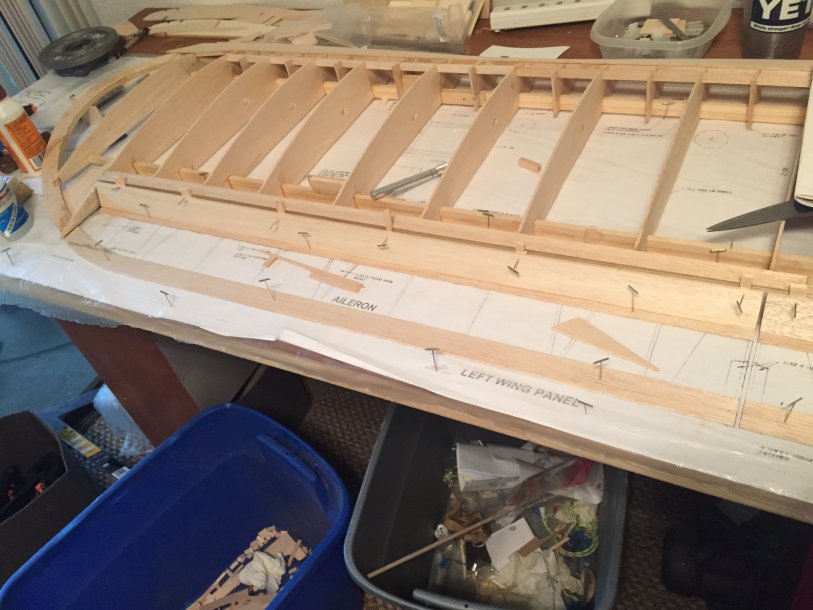

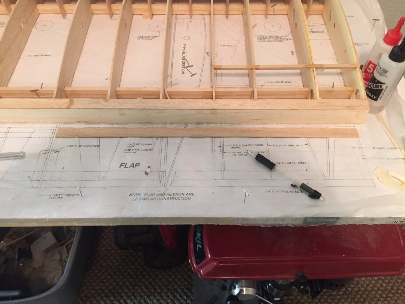

I built up the flap and aileron. It was fairly simple just followed the steps, and they went together really quickly. All the pieces popped out with ease, and minimal sanding.

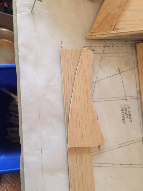

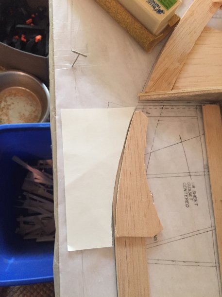

One thing, you're required to create the curve in the trailing edge of the aileron, so I created a simple template out of scrap so that it'll be the same on both sides. Whenever I make a template out of scrap I always label it with magic marker so I don't throw it away.

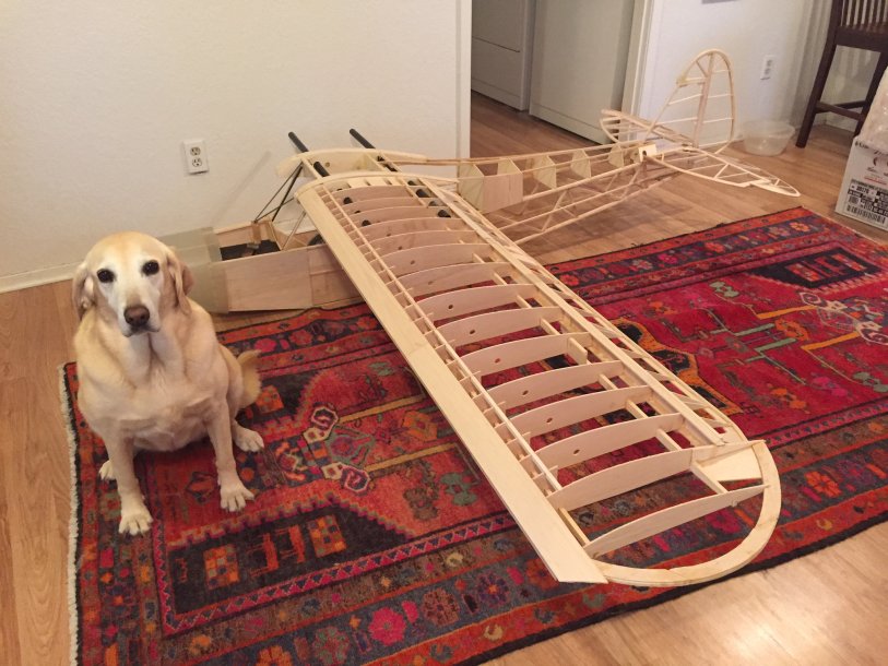

Of course after finishing the wing, I had to mock up the plane to get a sense of the size. My trusty model Pearl is always helpful. Can't wait to be finished with this bird. It's going to be awesome!

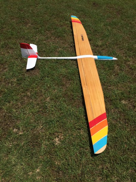

So, I had a little hiatus from the build. I started flying and practicing for IMAC, did alright up in Arkansas. I've had a flurry of buying and selling planes... and I also snuck in another build. I built an Airtronics Sapphire sailplane that I've had for a long time. I'm planning on posting the entire build as well on GSN. I documented it very well, and could only find one other build thread for a sapphire on the entire internet... so I want to make sure GSN has the other one. Here's a photo of the completed sailplane, and it fly's amazing by the way!
Our poor flying field is underwater here, and just when the water started to recede TS Billy hit the other day and the adjacent lake flooded it over again. Our whole club in a band of vagabonds at the moment finding various fields to fly at. We've had some of the other clubs invite us in, which has been extremely generous! Frequent flying has become difficult, but now the Super Cub build is heating up, and will finish strong here in the next several weeks! I'm getting very excited!
