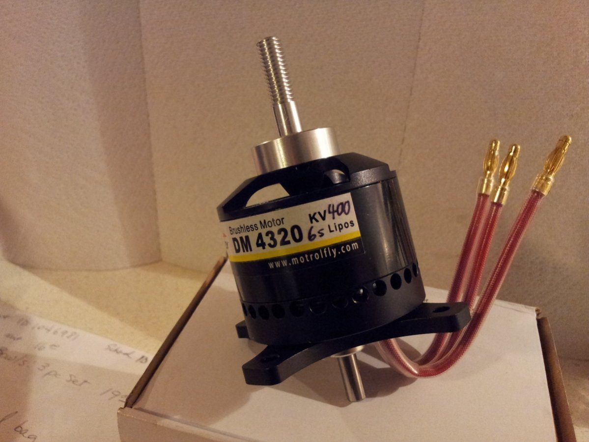

rcbirk, did you remove the blind nuts before bolting the motrolfly on?
i did, but if using threaded standoffs you dont have to. definitely have to redrill for the motor though. shouldve come with a paper template in the box for the motor as the x mount is not removable

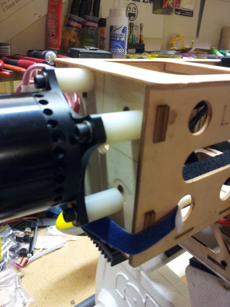

Here's how mine looked...you can see the original holes that didn't line up.
I removed the blind nuts.
