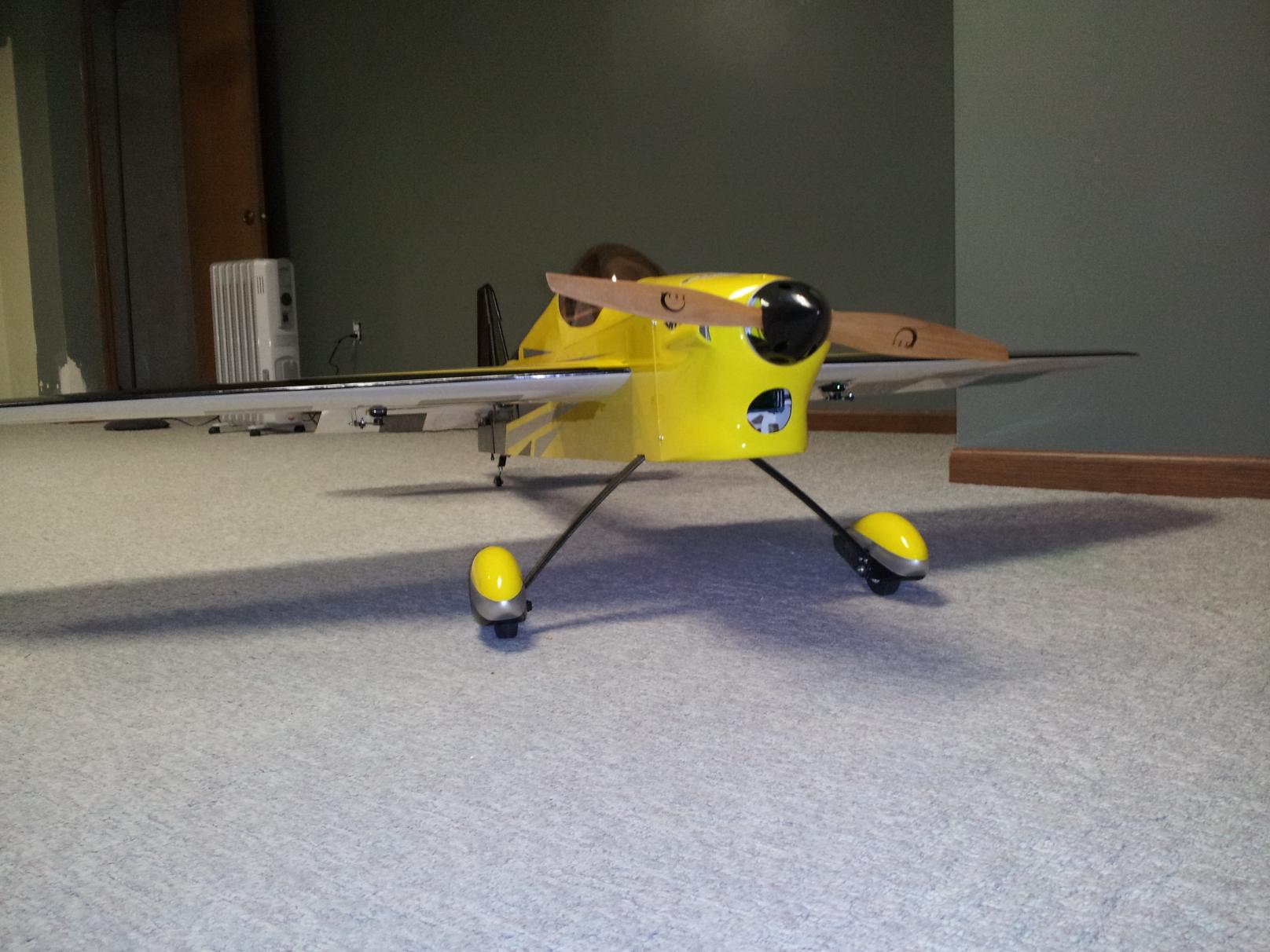

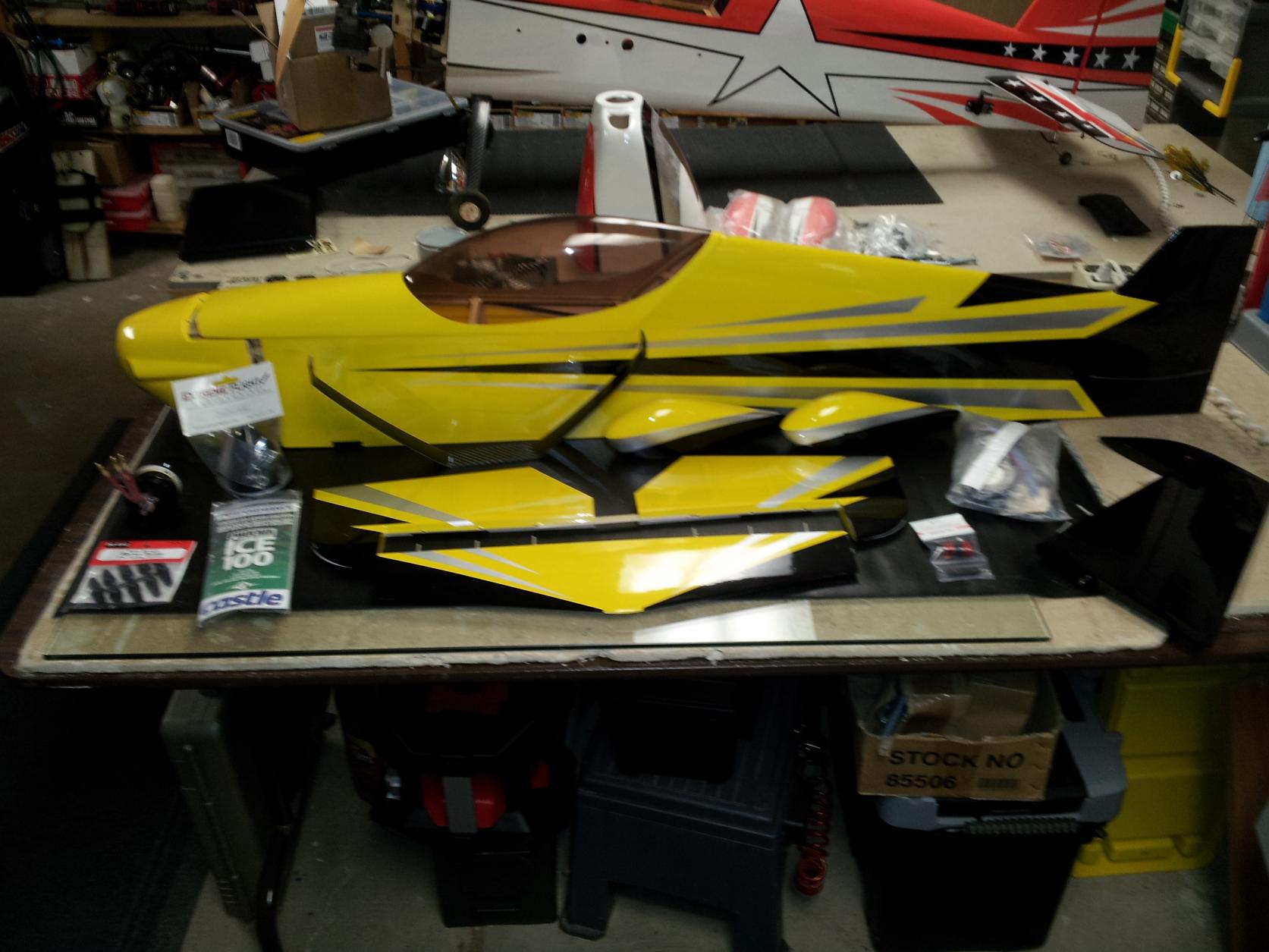

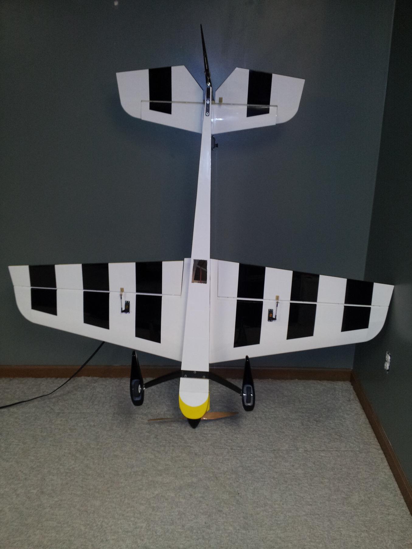

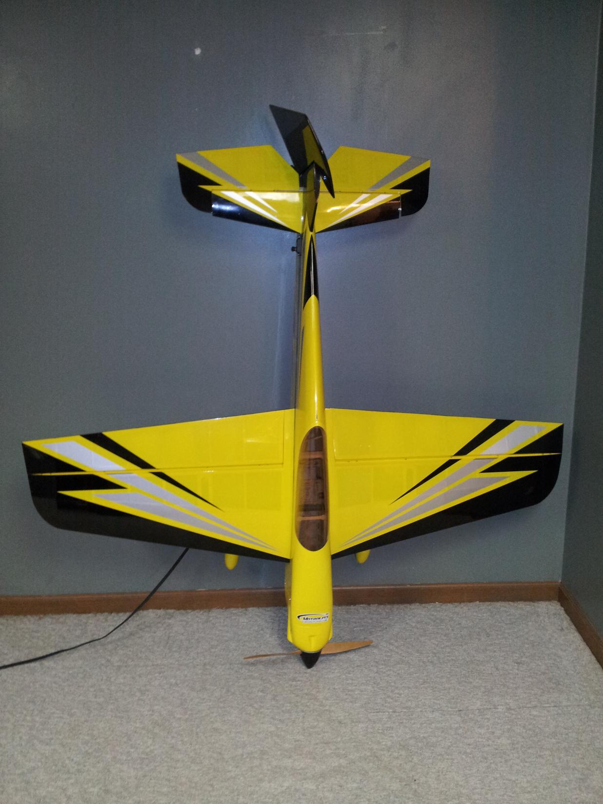

Upon opening the box, you know you have a high quality aircraft just like any other 3DHS airframe. Beautiful, vibrant covering scheme with high contrast will stand out amazingly well against any sky back drop. Covering came out tight, and hatch fit almost properly out of the box. (will go into greater detail later). One nice thing that 3DHS has started doing on their ARF's is putting a lot of the bolts in the fuselage as it is packed in the box. The big advantage of this is that you dont have to go fishing through the different part bags and pull out screws and test them all out until you find the correct size, and then hope that it is the correct length and is not supposed to be used somewhere else. They put them into the firewall, tail wheel bracket holes, and landing gear holes for you as seen in the pictures below. The pull pull wire is also pre-routed through the outside of the tail if you choose to do a pull pull setup. See my article on CG for determining pull pull or push pull configuration. It ended up working out with this particular setup that I can use push pull, which I prefer for simplicity and positive control, but everyone has different opinions and with this setup you can use either one.

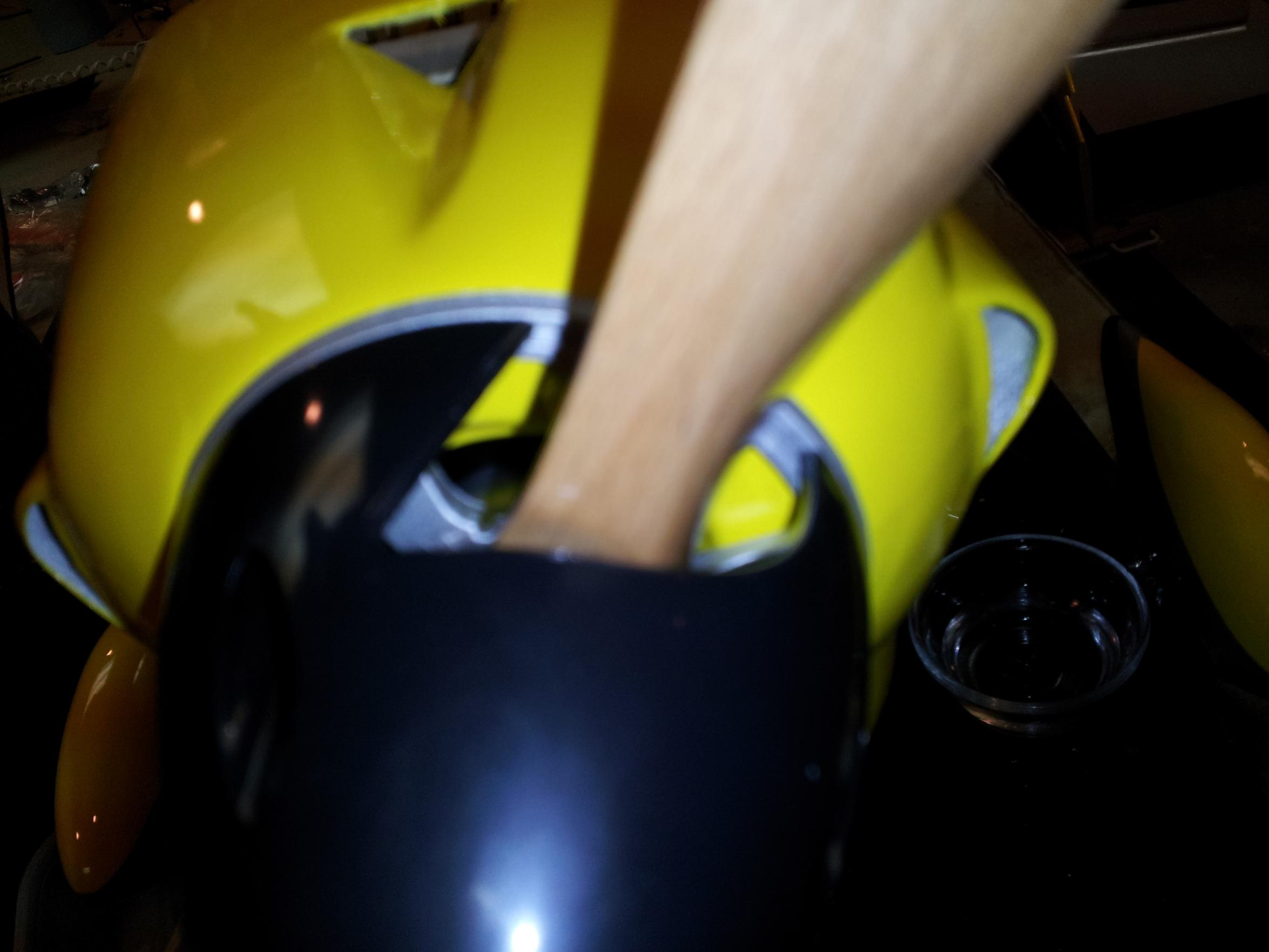

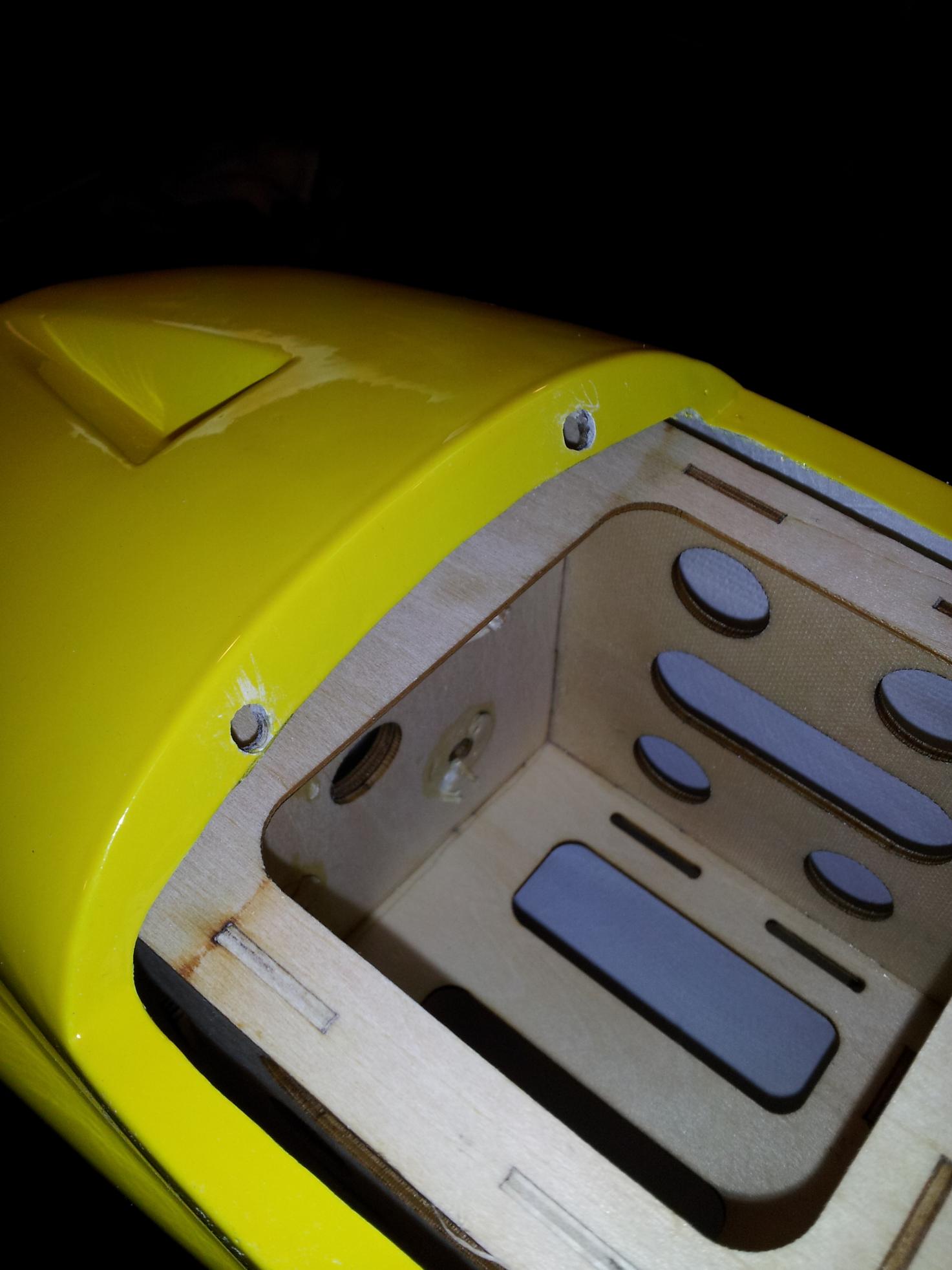

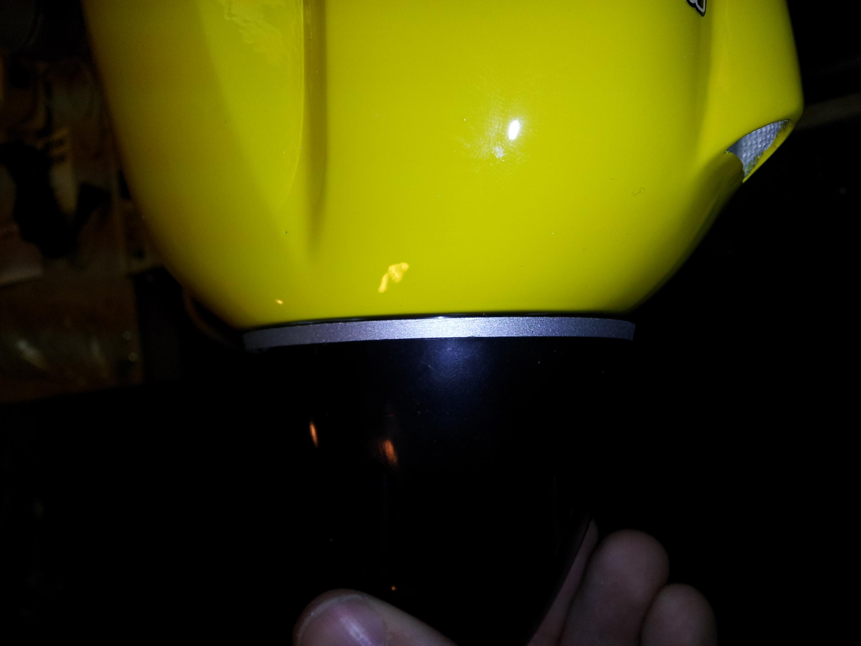

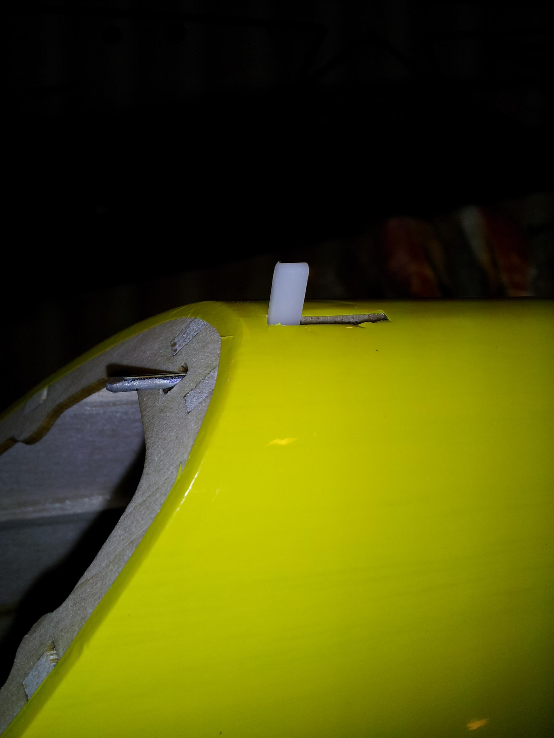

You can tell by the fit of the parts that 3DHS knows what they are doing, however there are a few pit holes to watch out for and be aware of while putting this models together because afterall, they are assembled by factory workers in china who really dont care about how easy it is for us to put together our toys. The first thing I like to do is check cowling/canopy hatch fit, especially since it seems that just about every plane I have ever owned has flung the canopy off at least once. Always always always make sure the latch fully engages. Anyone who has built multiple 3dhs planes can tell you it is vital to making sure that your canopy stays on while you are wringing out your plane. It just so happened that on my vyper the latch was not fully engaging. To check this, first install the cowling. The vyper uses the same tab and receptacle style that the 71 slick uses, so it is very quick to mount it with screws and not worry about canopy hatch fit. Once cowling is installed fully, slide on the hatch. There are two important things to check. The first is that the white tab that is sticking out of the fuse is all the way forward as seen below, exactly as when the hatch is not on.

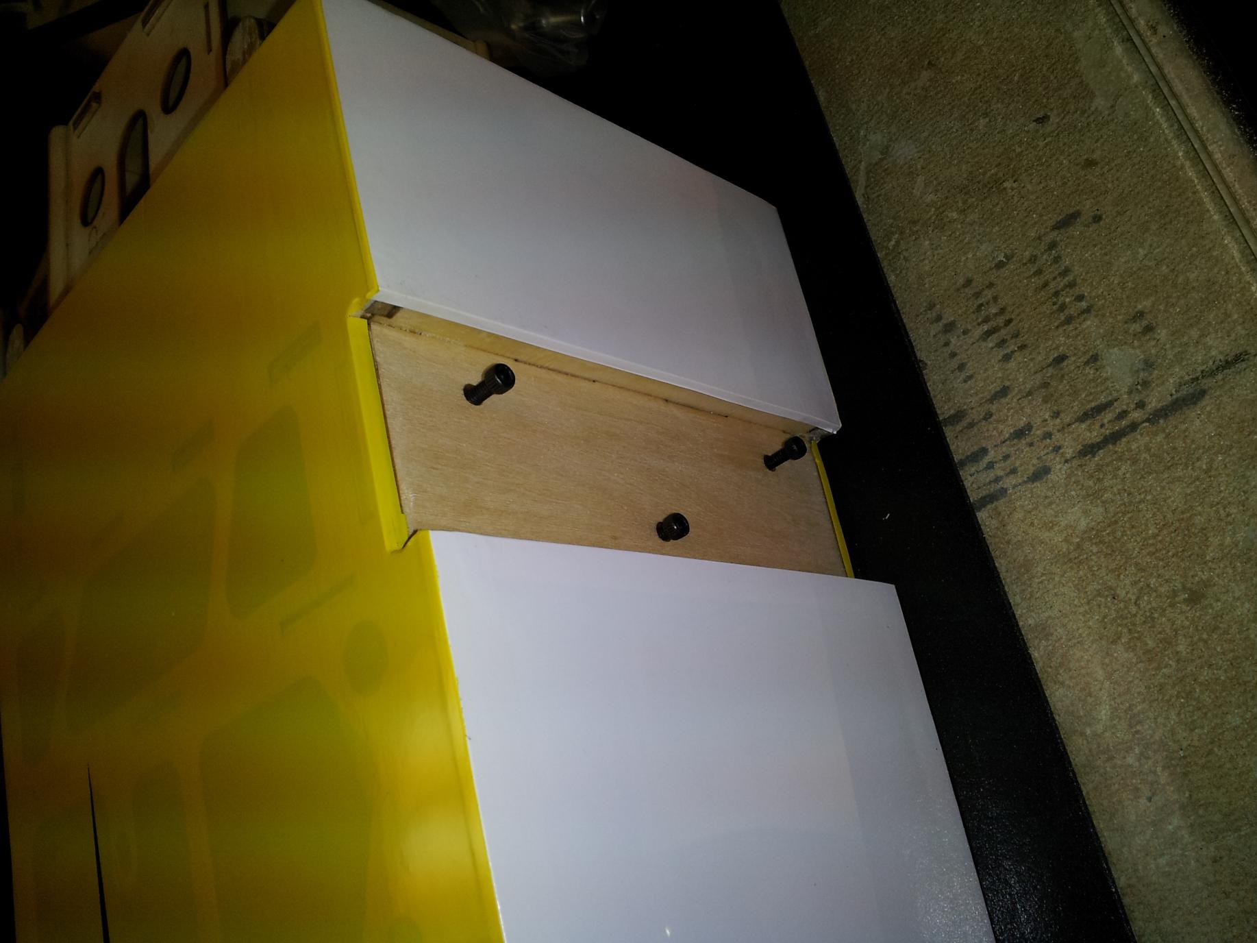

To fix this, enlarge the holes for the locator pins in the cowling until desired fit for the latch is reached. Make sure to do it a small amount at a time as too much grinding out can cause a loose fit for the locator pins and the hatch can fly off. I just use a dremel with a pencil grinding bit to enlarge the holes

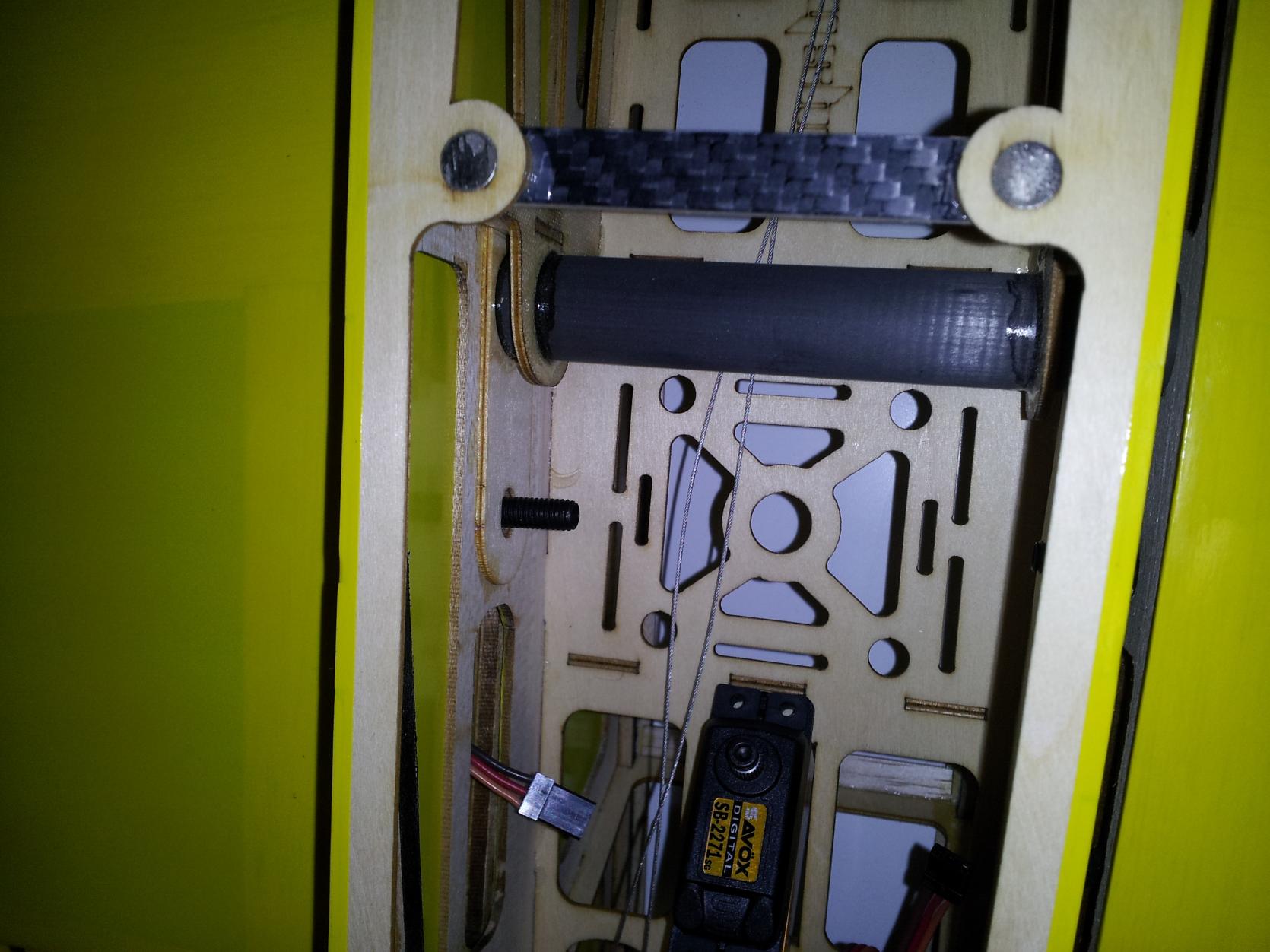

The other thing to make sure is that the pin is fully engaged. I talked to Ben Fisher about this a while back, and he said to make sure approx. 3mm is sticking out through the inside of the canopy. If the tab on the outside of the fuse is all the way forward and you are not getting the required amount of pin inside the canopy, take a pair of pliers and gently pull on the pin to get more length. Sometimes in assembly at the factory the pin gets pushed in, and it just takes a few seconds to ensure a secured canopy during heavy 3D and high speed flight.

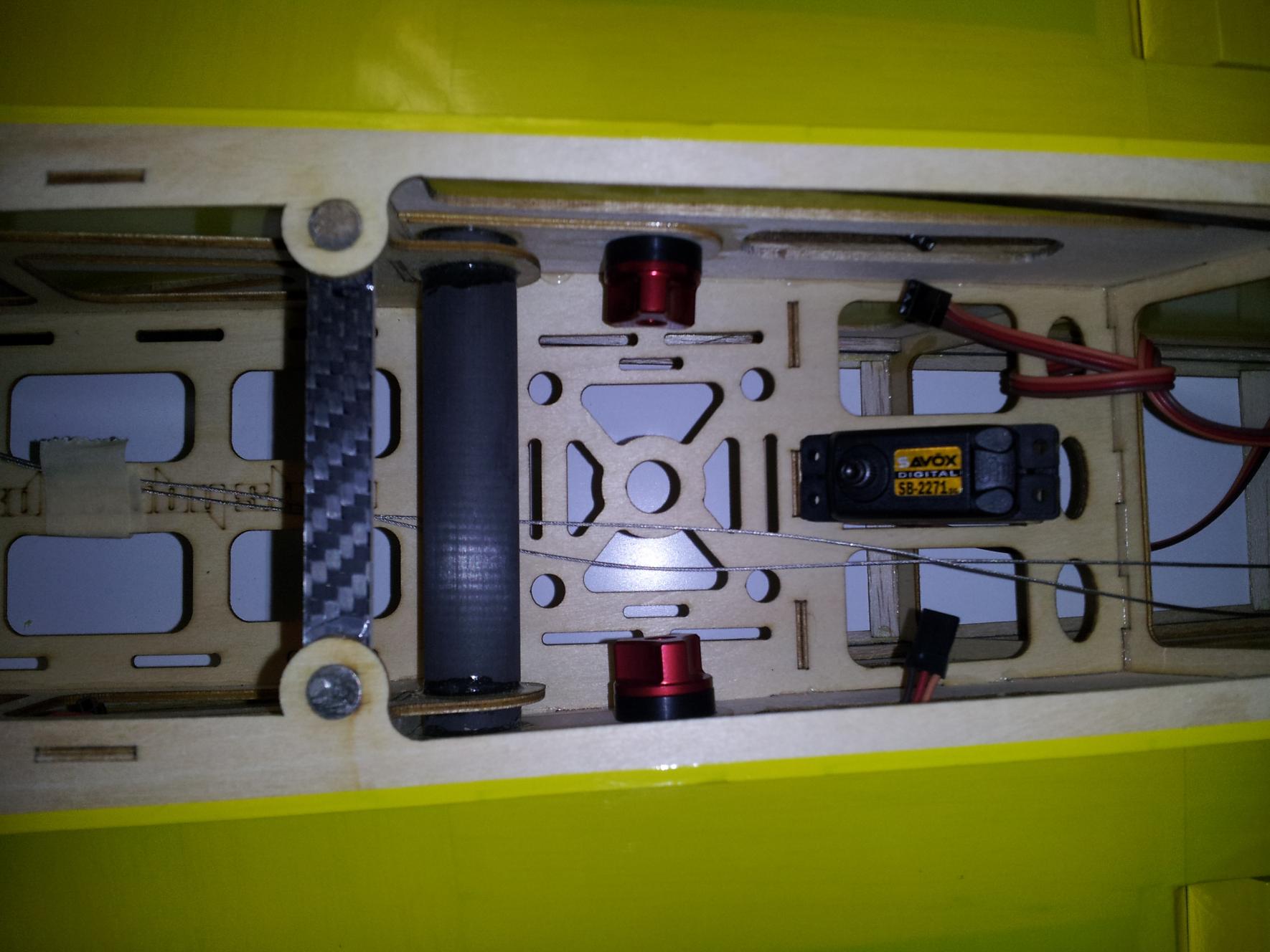

As mentioned earlier, I decided to go overboard with servos this time around. Servos are one of those items that you really get what you pay for and they can make or break a setup. I have always wanted to try brushless servos, and this plane has given me the perfect opportunity to try them. I will be doing a separate review on these servos, so stay tuned! Spoiler: They are wicked fast on regulated 8.5v!

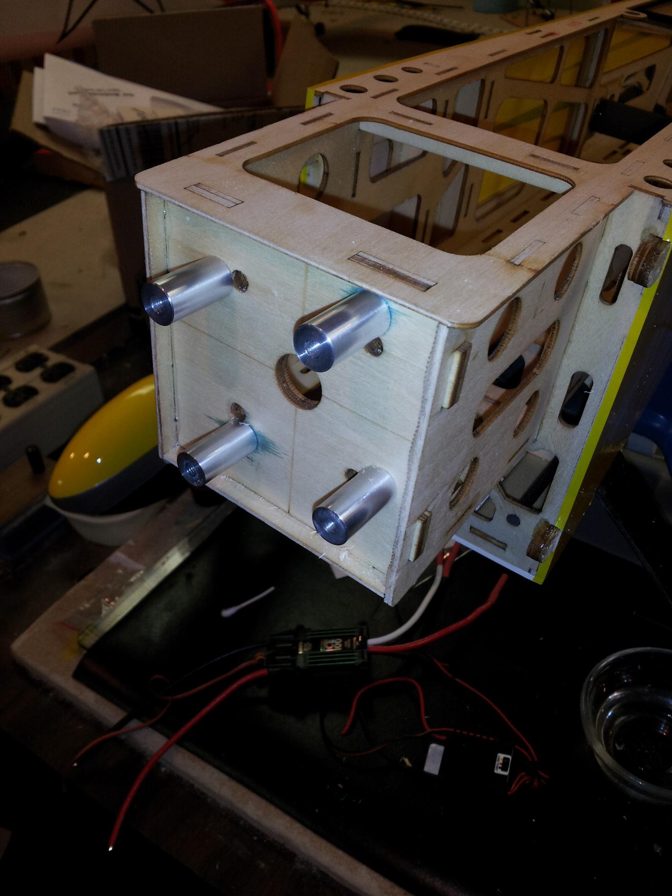

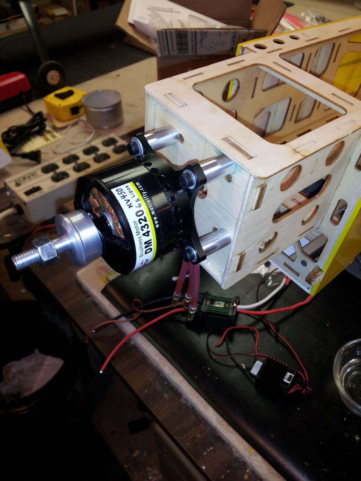

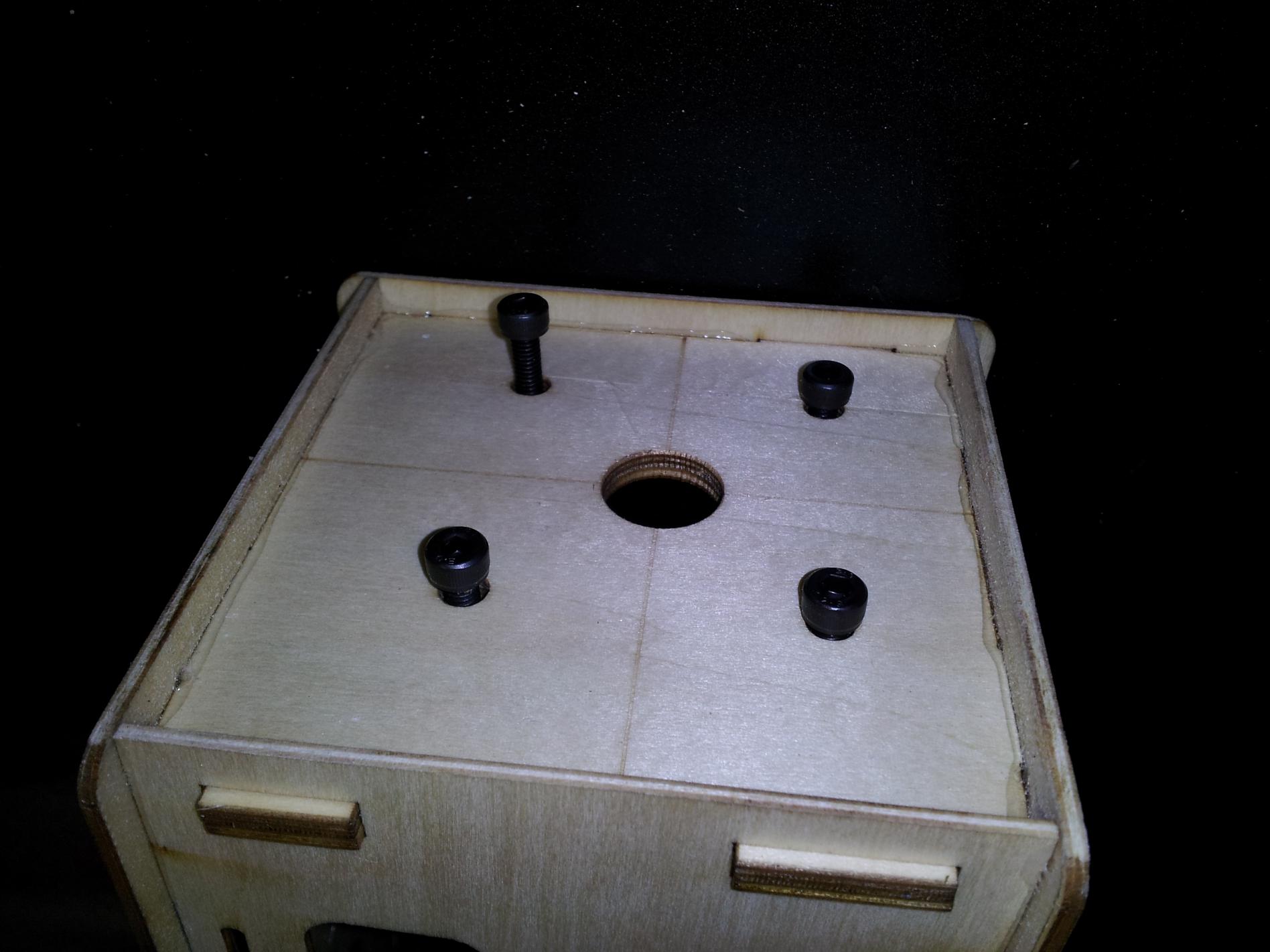

The first item I tried out was custom standoffs from Craig over at customstandoffs.com. There were a few reasons I wanted to try them out. The first is I love the look of them and the rigidity they give the whole motor mount, especially with these high torque brushless motors we use. The main reason is that with this motrolfly, I had to redrill the firewall. I cannot reiterate how much I despise blind nuts, especially installing them. By getting the standoffs threaded, I could just put a bolt and washer on each side (one on the motor side, one inside the motorbox on the firewall) and all done! Also note how tight the spinner gap is with this setup.

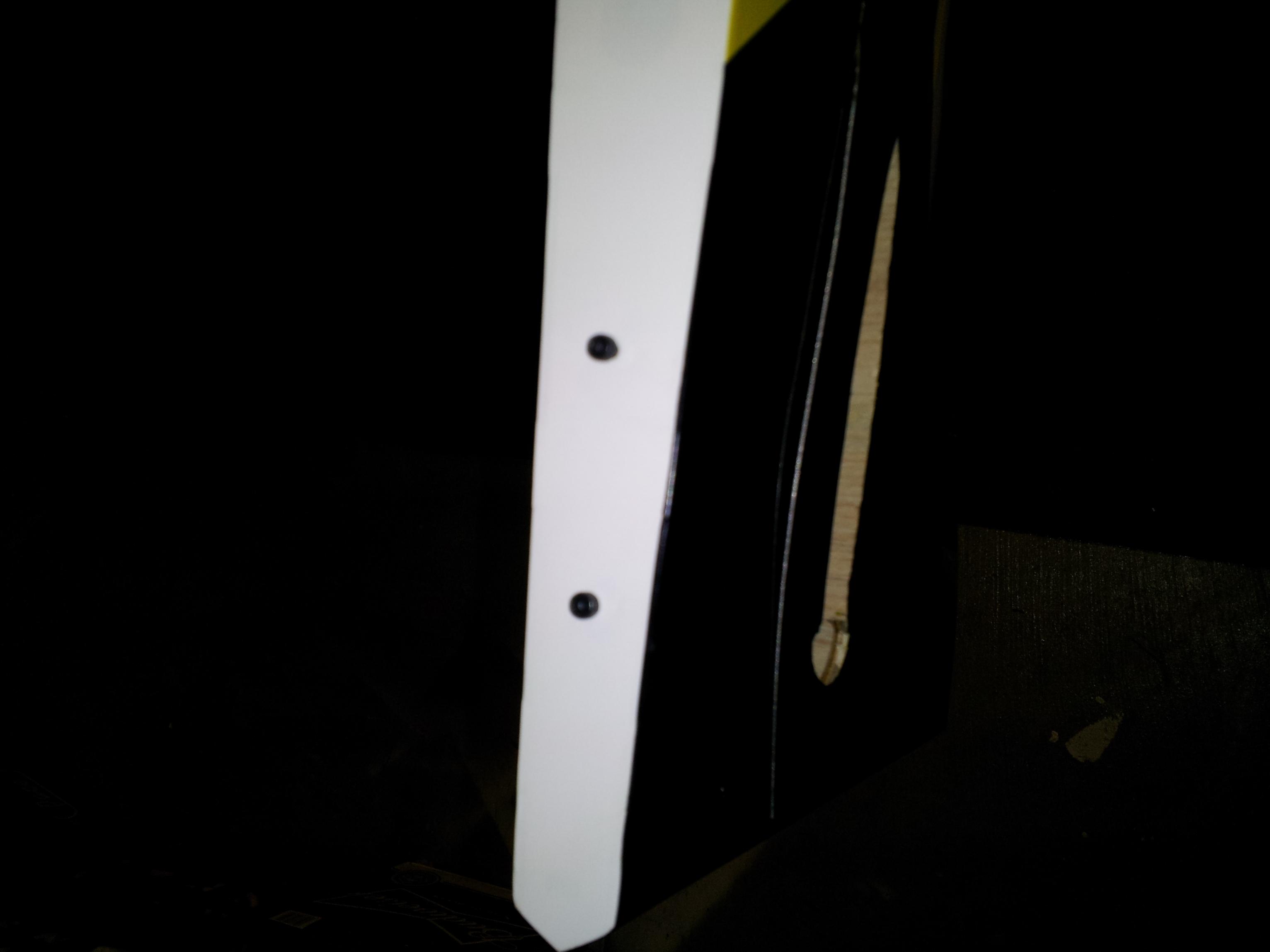

The next item I tried out is from Azar over at aztech aeromodel. I ordered a set of the Secraft Wing Bolts. For all of the 3dhs 25% planes (65-74" wingspan), the M6 is the one that you want. The great thing about this is that you can loctite the threaded shaft into the blind nut in the wing, and just thread the head on when you install the wing, which I have found much easier.

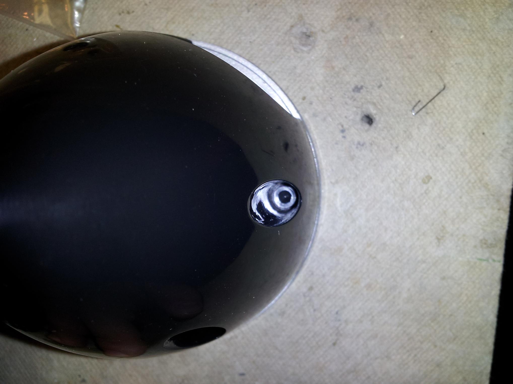

One thing that is very personal is spinner choice. I dont like spending the money on CF spinners, and really dont like cutting out slots or enlarging slots for my prop to fit through. Luckily, the kind folks at extreme flight have the gem of a spinner in their Elite Spinner series. There are quite a few things I really like about these spinners, such as the lightened aluminum back plate, extra wide prop cutouts, and very inexpensive listed price. They even recently started including hex bolts instead of phillips head with their spinners, as seen below. They even include an extra hex head bolts. Its really just icing on the cake, especially when they retail for just $9 for a 3" spinner. A picture of the size of the prop cut out is also shown.

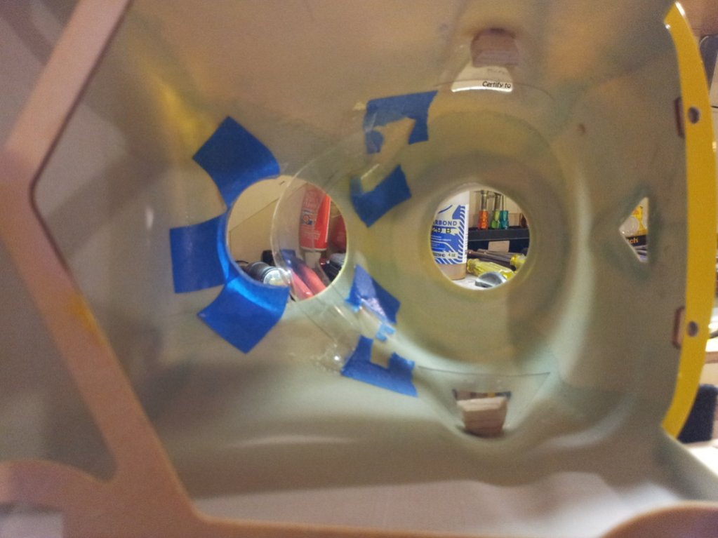

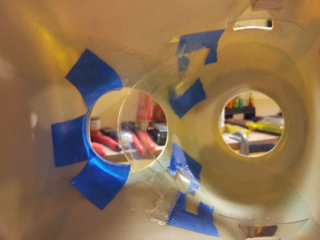

Did you do anything with respect to venting inside the cowl?
On my 65" Vyper I had to glue in some scoops to force the air at the motor and ESC.
This is after I burnt up a Scorpion motor; I didn't want the same thing to happen to the Motrofly that I put in there as a replacement. After a few flights on the Motrolfly it was still very warm after an easy flight, so I decided to put the scoops in, and now it seems to run much cooler.
