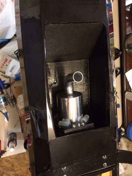

Had to add some paint... Very pleased with the performance and noise reduction.

Looks awesome Alky. I am so glad to hear that there is no power loss. The U shape design concerned me over the typical Y design because with the cylinders offset one exhaust make the single point before the other. I just could not see that being the most efficient but apparently it does not. I am remembering back to my racing days of Hooker headers where every tube was an equal length ti the collector.
Alky6
Thanks. Yep, 2-strokes are funny animals and the exhaust is even more strange. What we think intuitively usually doesn't hold true. Have had many many "good" ideas for the two-stroke boat racing exhaust that failed miserably. Had some others that were often odd that seemed to work! It's crazy! I am just pleased this exhaust system works well. I do have a couple points on the curve with a slight delay, but I think it may be due to my throttle curve and some jetting issues to still work out (or could be attributed to what you have already pointed out). Other than that, it's great.
