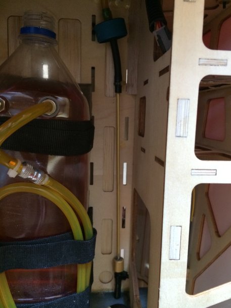

Does anybody do a brass tube in their tank and if you do do you run out of fuel on really long downlines?
check this out:
pay attention to 19 or 20 seconds
i just came out of a 1/2 cuban 8 with a 45 degree downline.

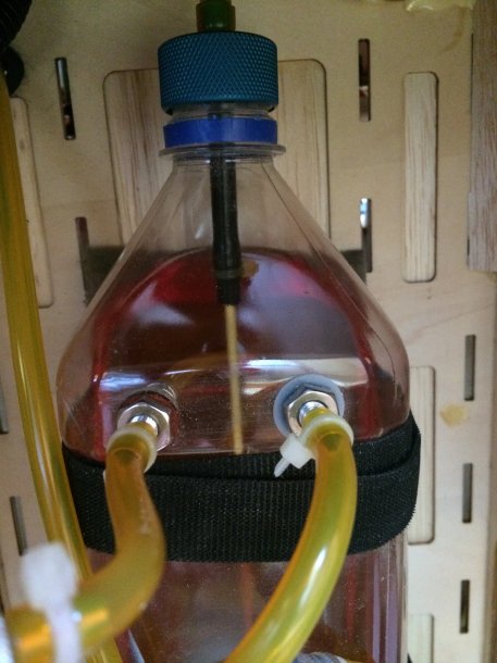

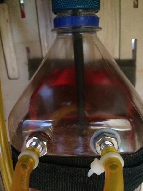

this is a picture of the tank before and after i made the mods:
in the video, this is with the tank set up using the brass tube. In the video the motor wanting to shut down from the air bubbles, this was common to occur after about 5 minutes of flight, once the fuel level was about 1/2 of the 1.5 liter tank.

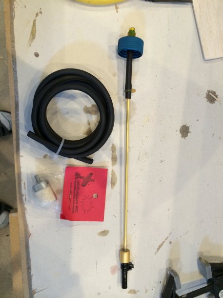

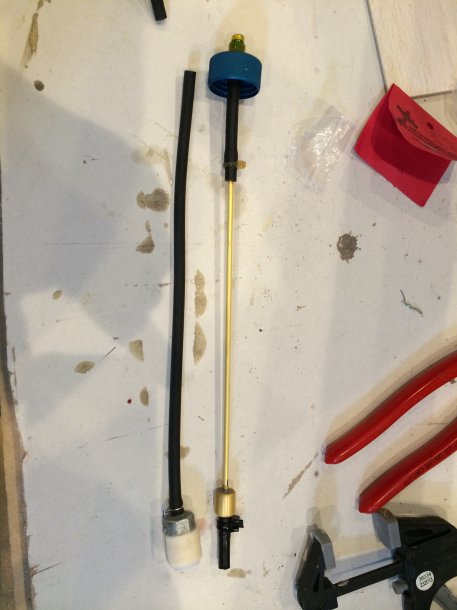

once i removed this brass tube and went with the Viton, the problem has been 100% solved. I also have discovered, Viton tube, and standard clunk, this can still happen. SO i went have changed my other planes to the felt clunk, and now, no more hiccups.
i am ashamed to mention this, but sometimes, a few times only, by the grace of God, i have landed the airplane, and the tank did not have a drop of fuel left!!!
The felt clunk really helps to keep the flow of fuel to the carb.

I've talked with a few other guys that have experienced this same issue and the the common thread is high idle. It's neither right or wrong, some guys prefer it like you and most of the IMAC fliers do. The thing is the design of the brass tube in the long thin "water bottle" tanks is to keep the clunk from folding over and getting caught up on it's self if allowed to fall forward on down lines much like the standard glow fuel tanks set ups. In "normal" conditions the total length of the clunk line from pick up to the carb nipple is usually plenty long enough to provide fuel to the carb reservoir to maintain a normal idle on down lines for the altitudes we fly from. Try this test to see what I mean. Time how long it takes for your engine to die at standard idle once you notice the first air bubble headed to the carb on an emptying tank. Several seconds. Plenty of time to be doing the maneuvers and recover. However, add in a high idle speed and that time is drastically shortened hence the problem you had before changing to the all Viton line. I've been flying the original design for a full 4 seasons now along with others in my club with zero issues but then again none of use use high idle either. Like I said, neither right or wrong here, just trying to shed light on what's going on and the design is sound for the majority of fliers.

Scott, that is very interesting indeed. my problem has been fixed with the felt clunk & piton line. Just goes to show, more than one way to skin a cat. IF it works for you that way, that is great. I guess if anyone else has similar problem, they can try your suggestion and get rid of the high idle. Thank you for sharing that with me.
