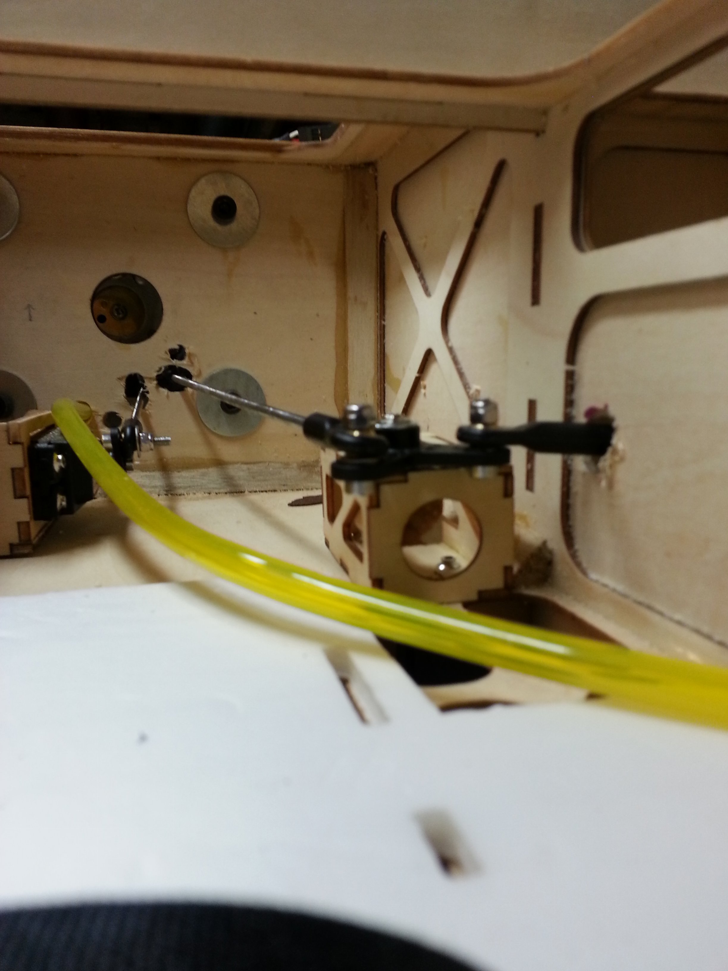

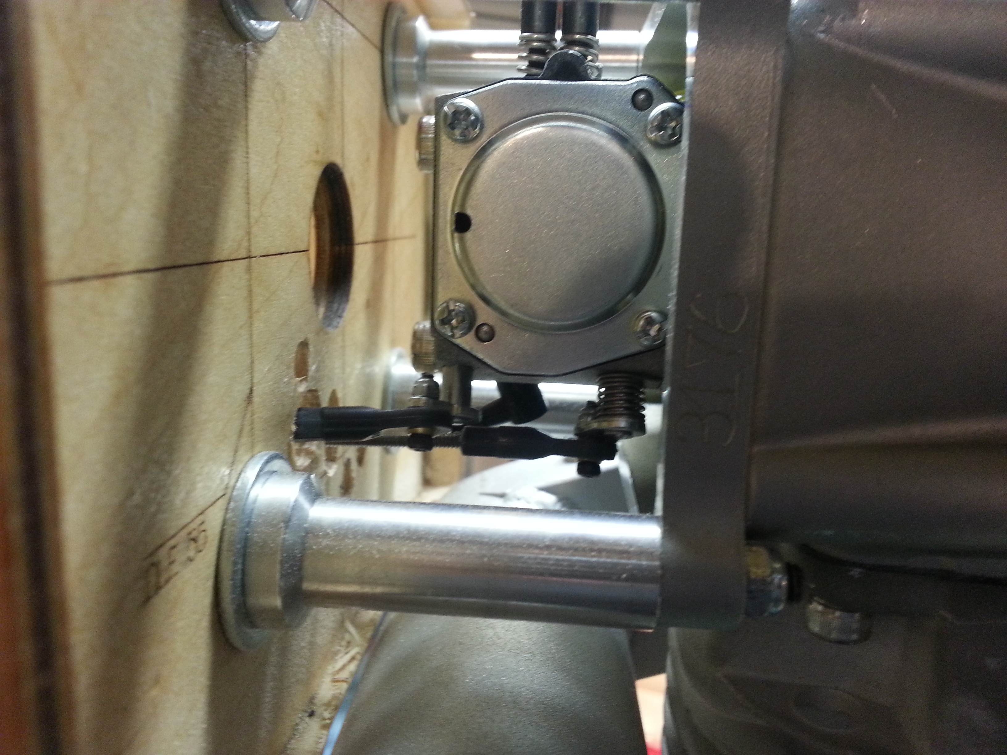

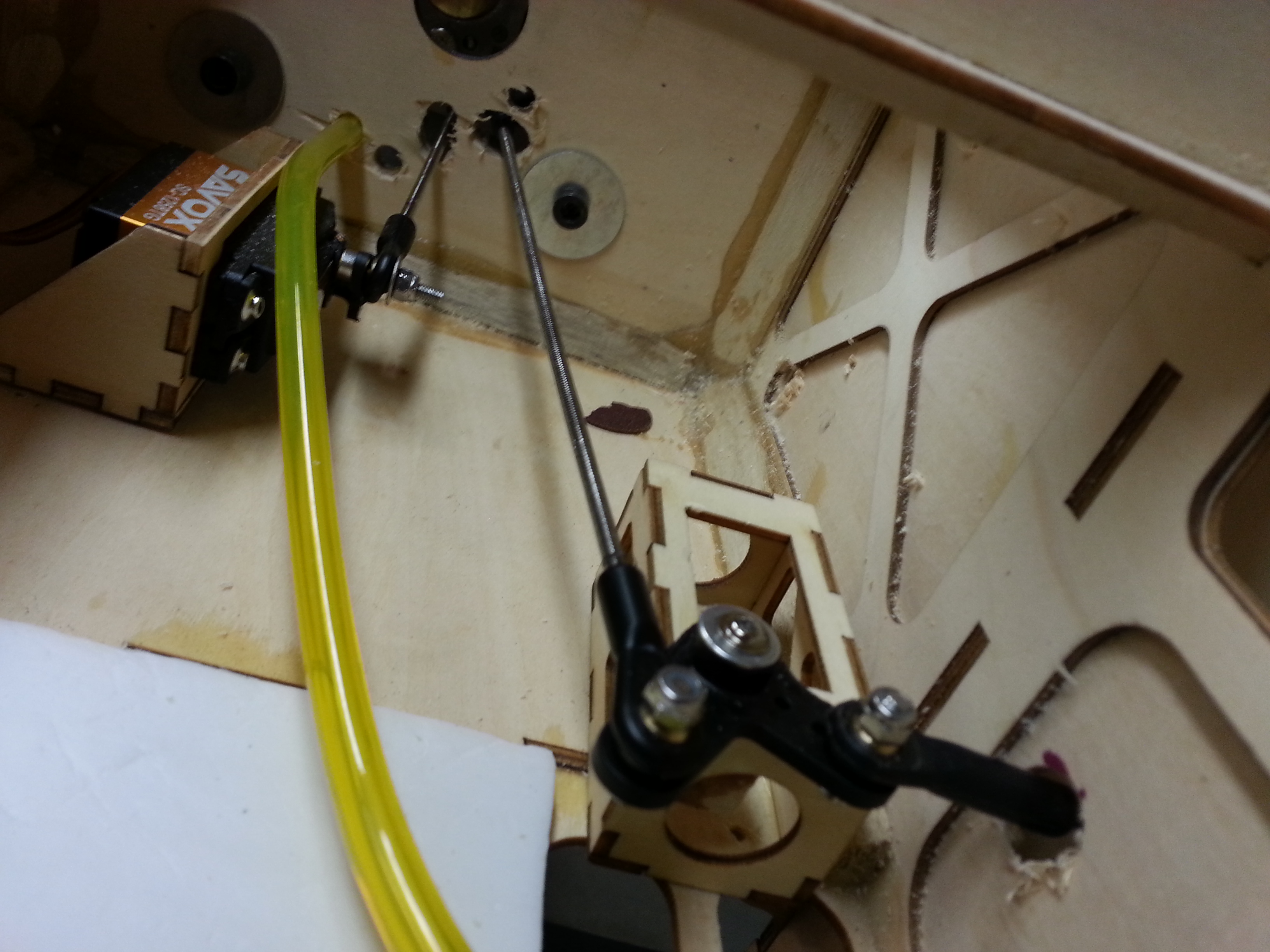

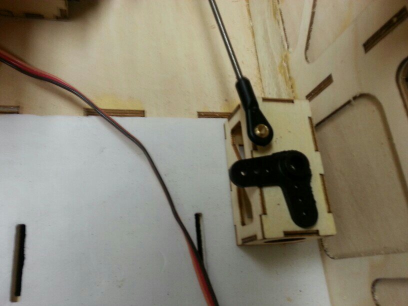

the external side of the choke system:

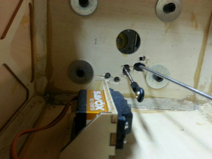

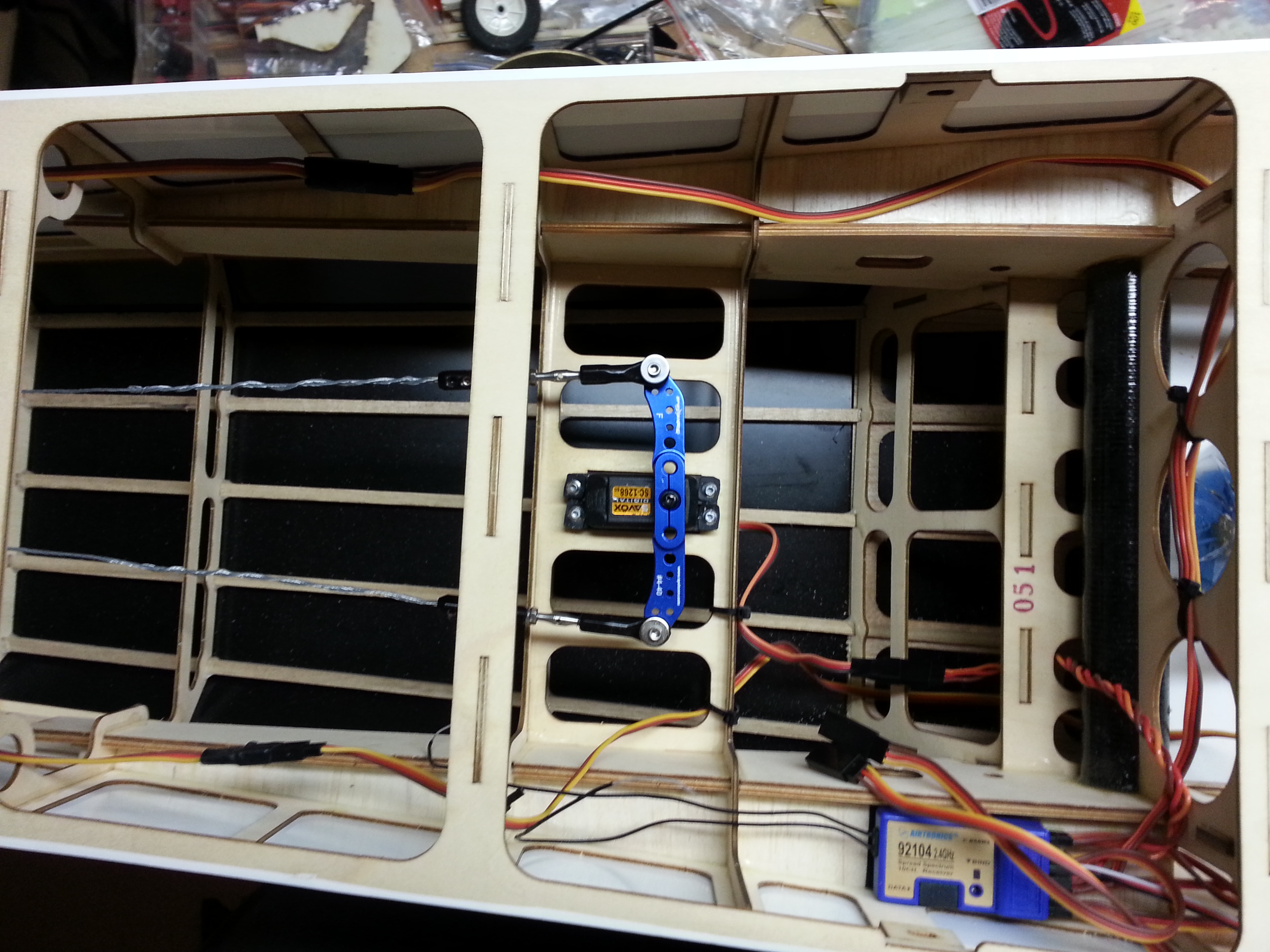

the internal view of the choke system:

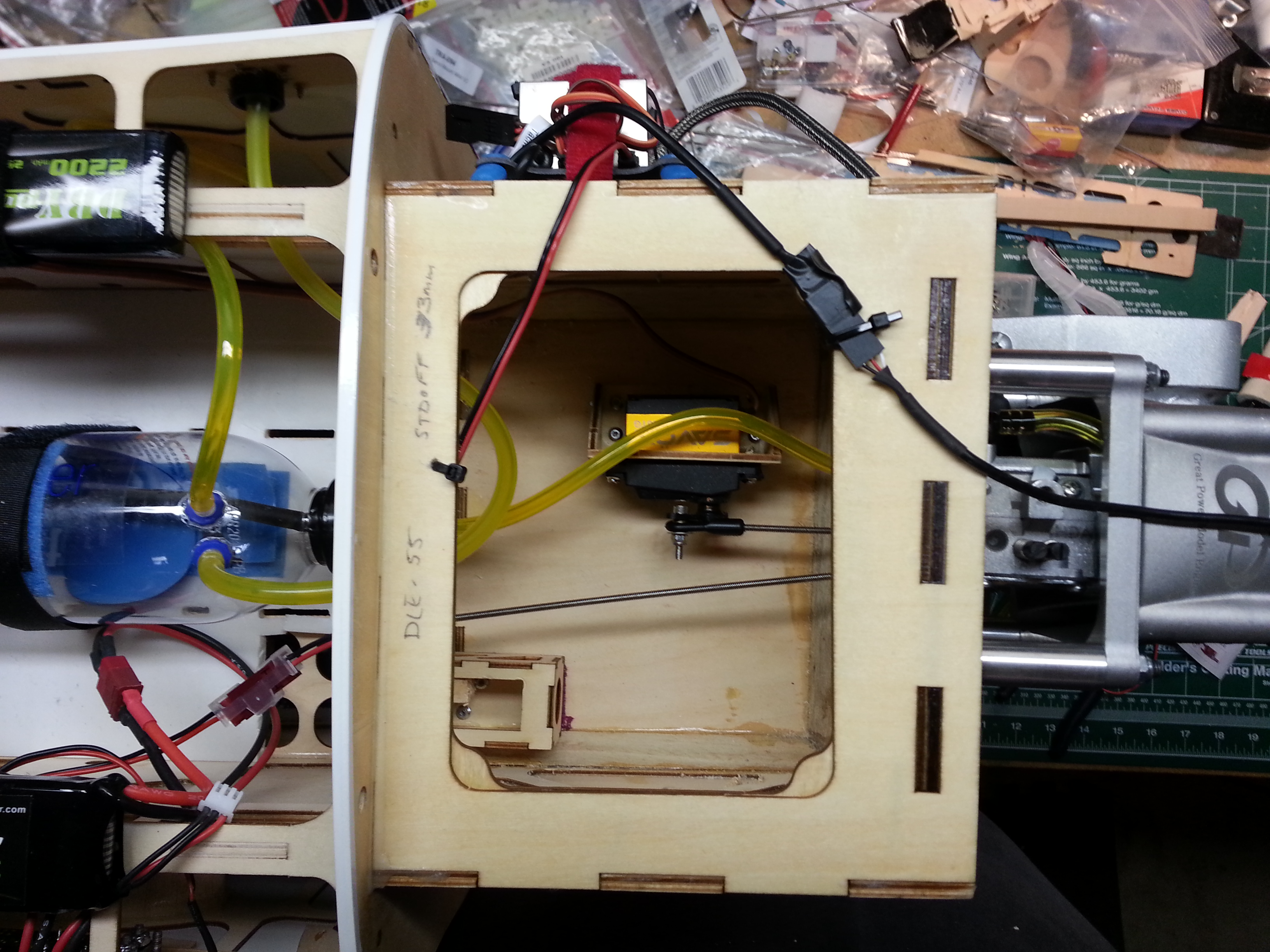

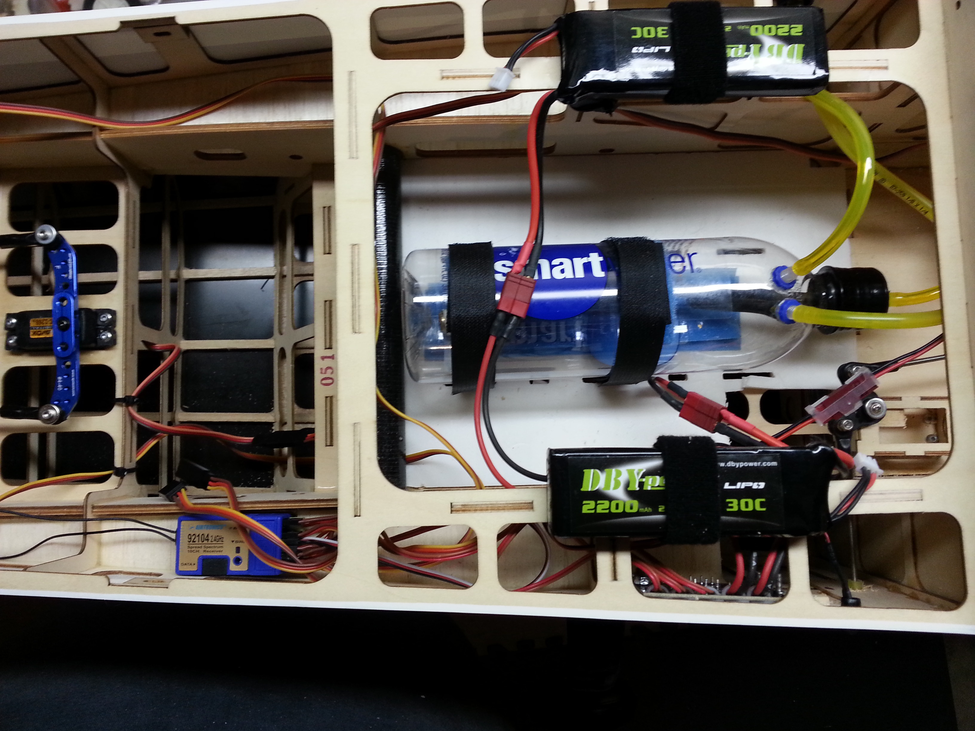

most of the internals are installed: (includes RX, WrongWayRC fuel tank, dual lipos, and opto-kill)

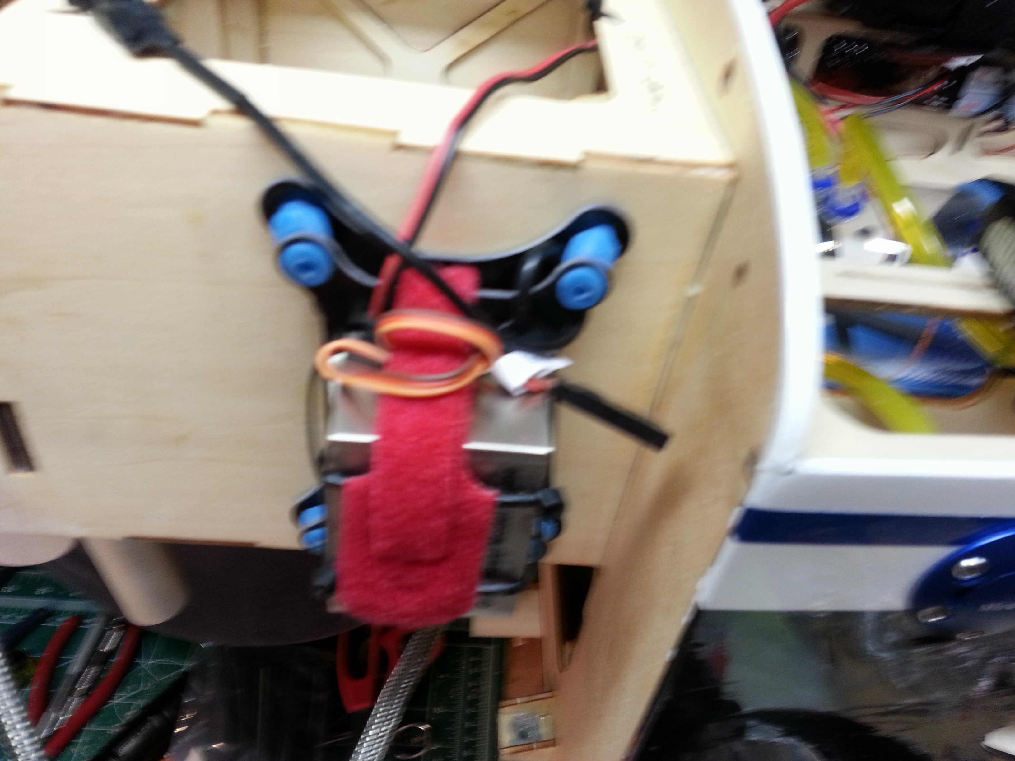

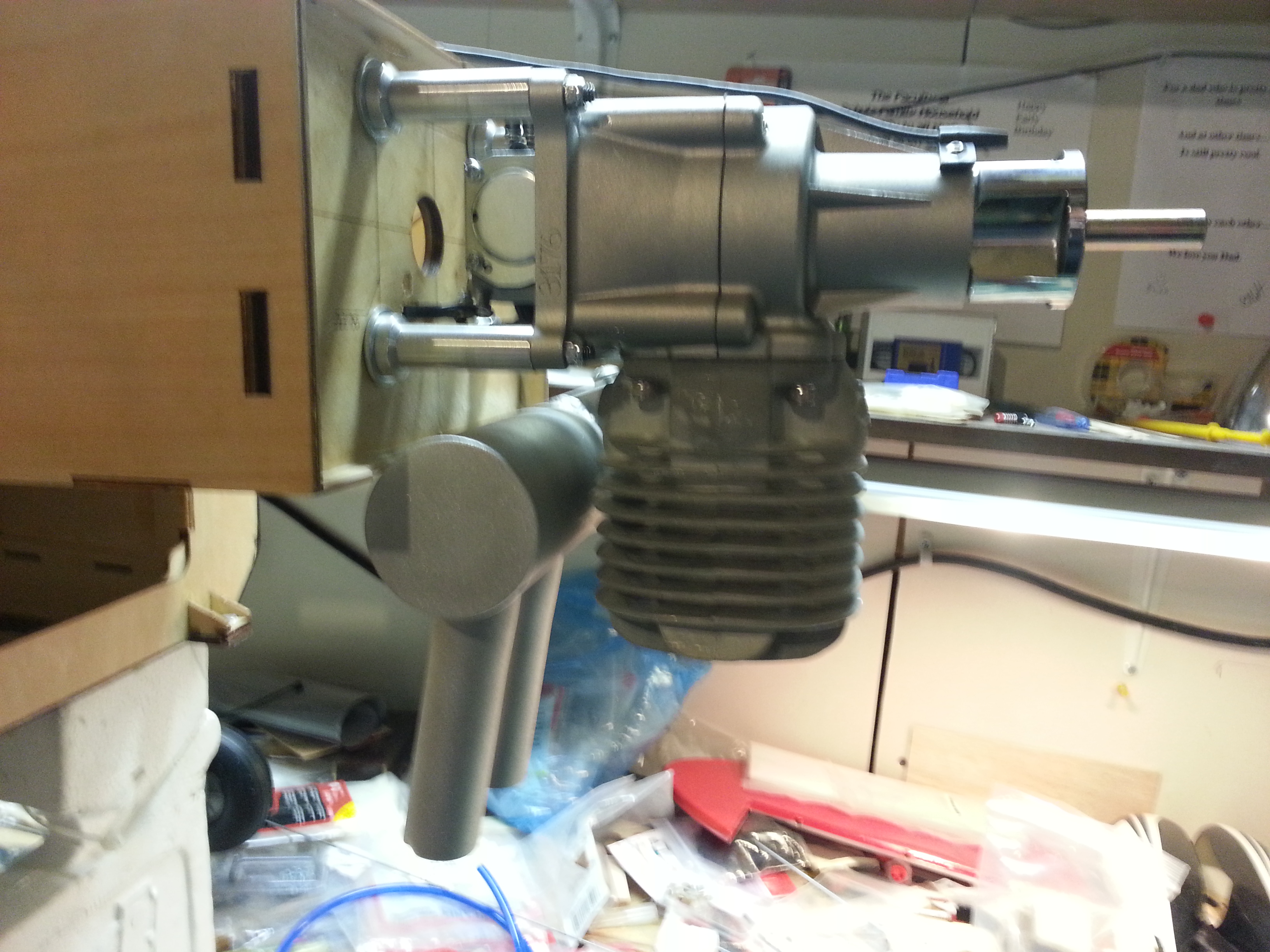

Ignition mounted with a cool ignition mounting plate that is supposed to reduce vibration.

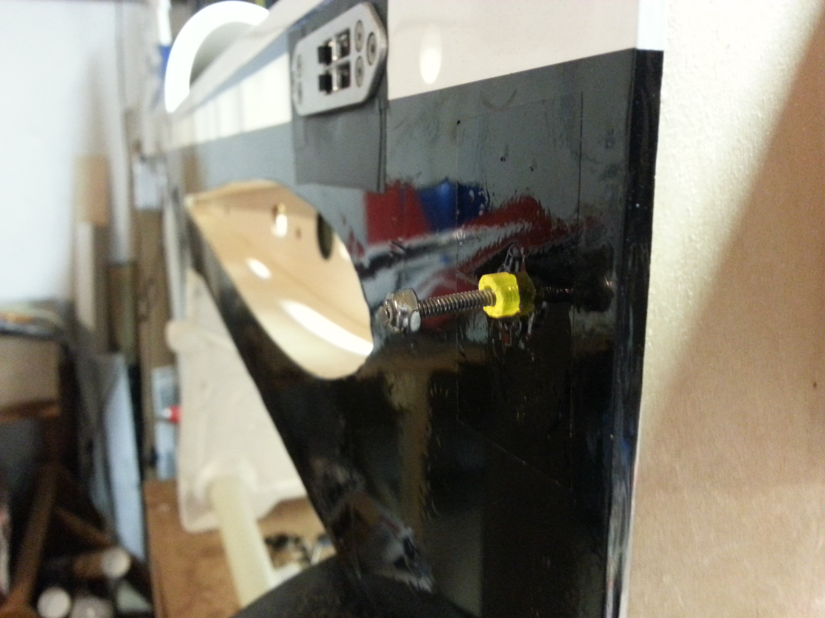

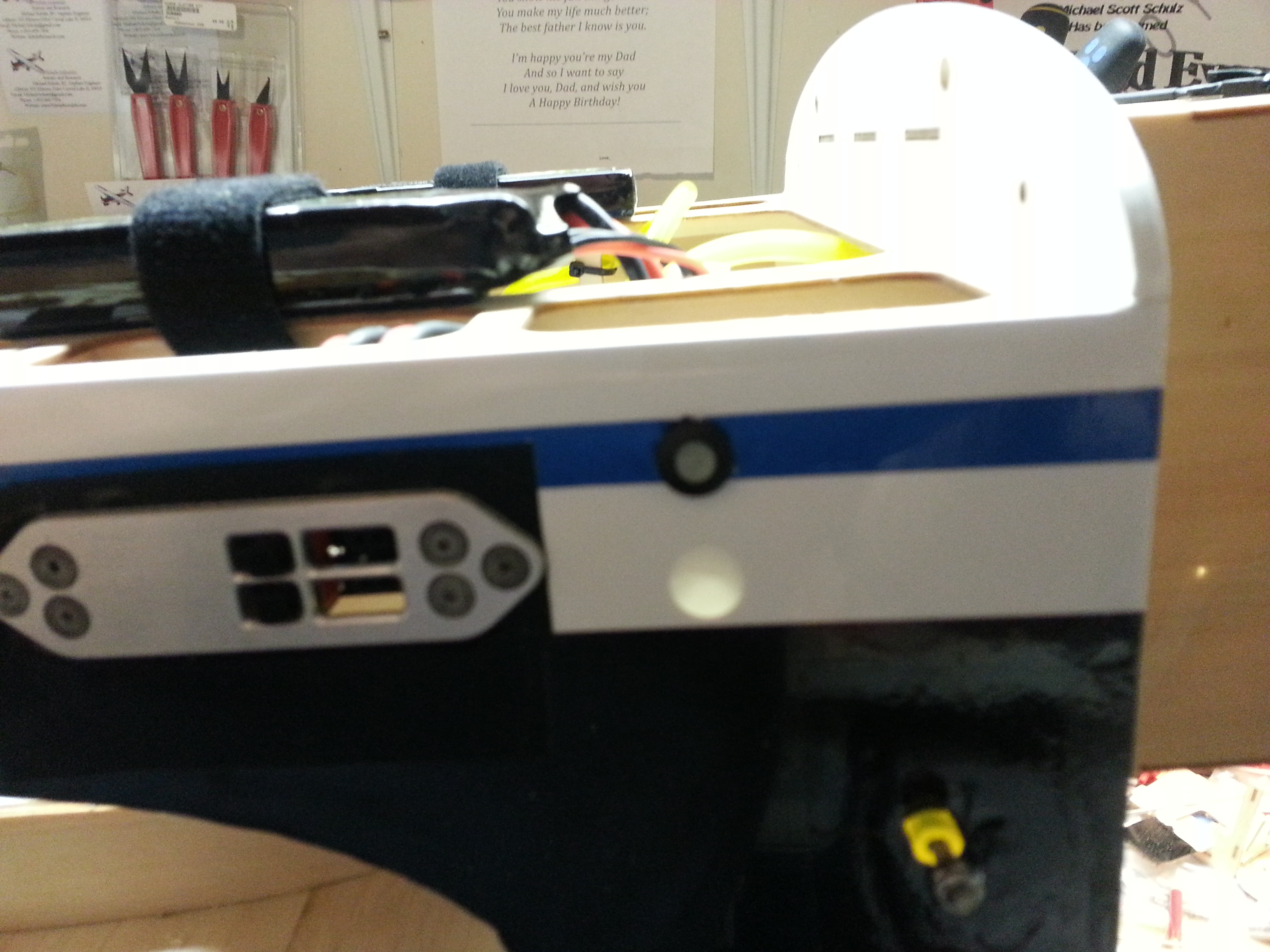

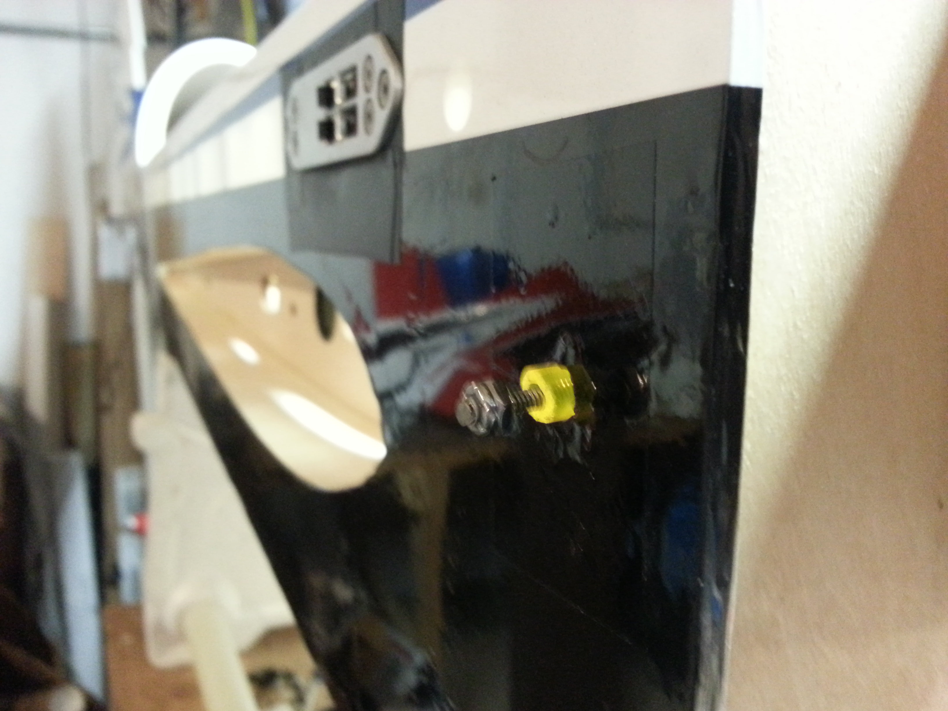

Also, exterior view of opto kill LED.

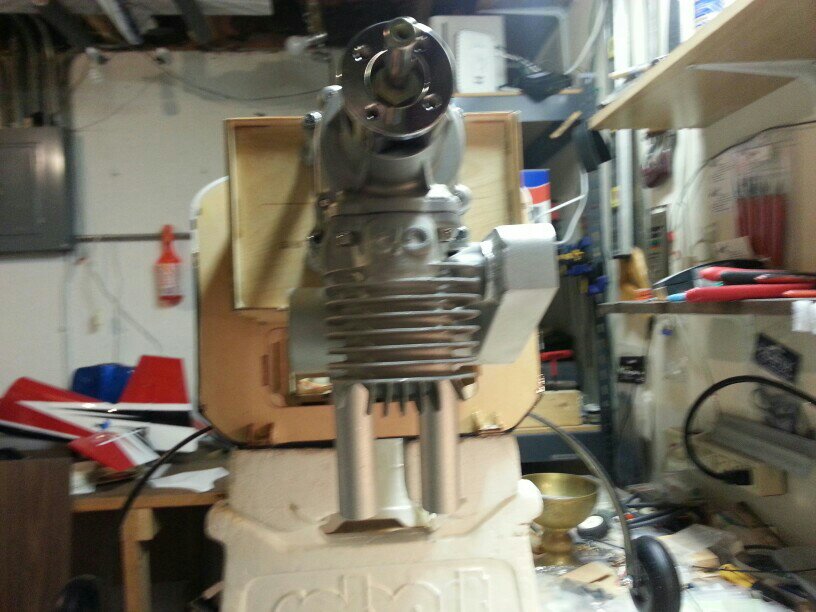

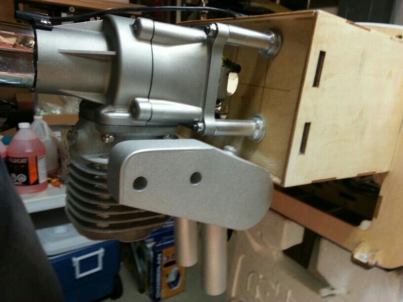

FYI, regarding the spinner gap and firewall...I discovered after installing the pitts muffler that I cannot move the engine back any farther...shorter standoffs would have really messed me up...the pitts muffler is right up against the bottom of the motor box already....I had to shave 1/4" off the bottom of the motor box in order for it to fit with these standoffs...there is no room left to remove anything else, otherwise I would be removing part of the bottom of the firewall!
