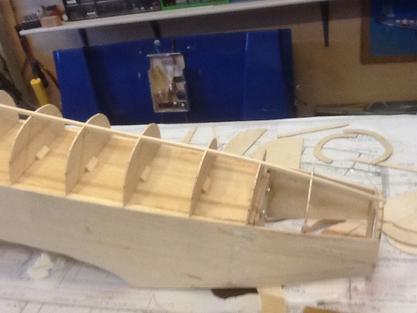

Ok, the wood came in and I was able to get the FTop put on. To do this, you take the piece of plywood and lay it on the building table and put the fuselage upside down on top of it. Use a pencil and draw the outline. The fuselage isn't square so trying to measure and cut it like I did first won't work at all.

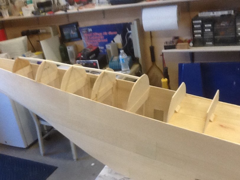

I had already cut out the formers for the top and I've been studying the plans and working out some of the details in my head, so this went relatively quick. I used 1/2 inch triangle stock to make sure they were straight and to make them more secure.

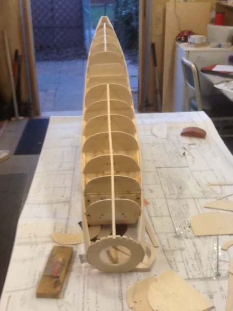

F1 has 7, 1/4inch slots for 1/4inch stringers that run from F1 back to F5. The problem is the formers don't have the corresponding slots. So, I used my grandfather's chalk box and snapped 6 lines on either side of the center stringer. Then I used a straight edge to make sure I had it aligned. The hard part now is cutting the slots. Would have been much easier if they had been drawn on the plans, but they're not.
