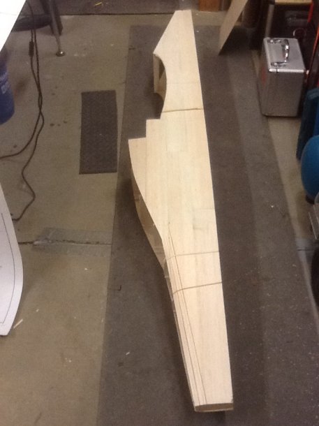

    I can't believe the packers lost that game. The most blatant example of thinking you've got the game won and then calling plays designed not to lose, instead of continuing to play to win. Seattle raced through the rain and on to the Super Bowl. Good job Seahawks! (even though I was pulling for the Pack). Oh, well. That's why you play the game.

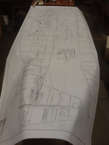

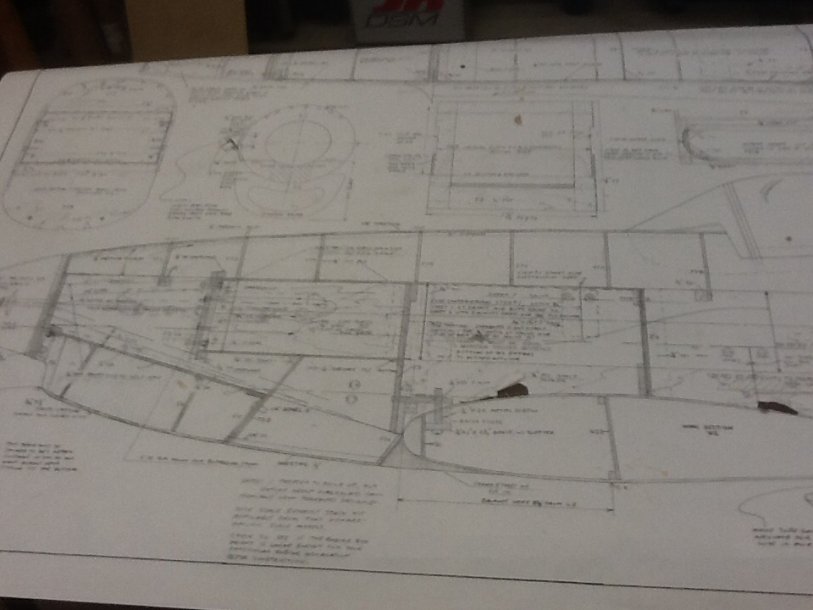

    The first thing in building this plane is to put together the sides. At first it was a little confusing because there's no templates for the side parts which are assembled using 3/16x3x36 inch balsa. You just have to make measurements off the plans and then replicate the pieces. There are 9 per side. What you end up with is a flat side that looks like the picture. I didn't start this thread until I had already finished this part of the construction. I think you can see most of the pieces. Be aware that if you build this plane, these plans are not what you would expect from Hostettler or Ziroli. They are revised kit plans and therefore lack some of the clarity that you would expect from a designer. But they're pretty good with some building tips written next to some of the troublesome areas. There's also a set of instructions, but again, theyre helpful but not Great Planes or Sig.

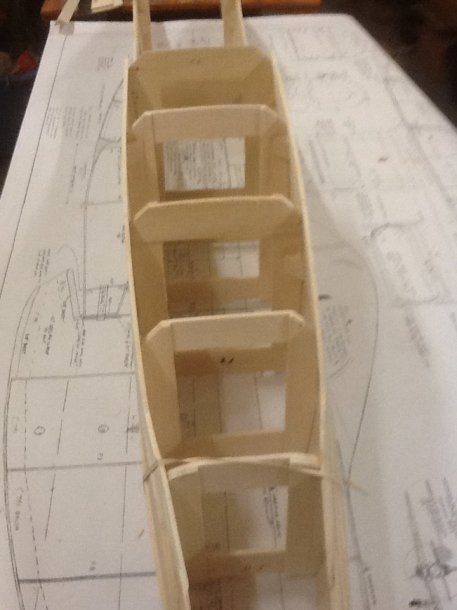

  9. Once the sides are built, if you haven't already done so, you have make the formers. It's my experience that you're better off to make a kit of all the necessary pieces before you start construction. Seeing the pieces beforehand will answer some of your questions before you get bogged down. But, if you're like me, I want to see stuff happening, so I make all the parts for a subassembly. That's kinda like following my own advice.
    If you look closely you can tell that F6 is made from 1/8th aircraft grade plywood. But the other formers south of F6 are built up using 3/16x 1 1/2 balsa. It's a unique approach, but works pretty well.
