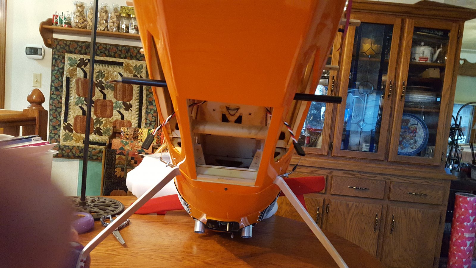

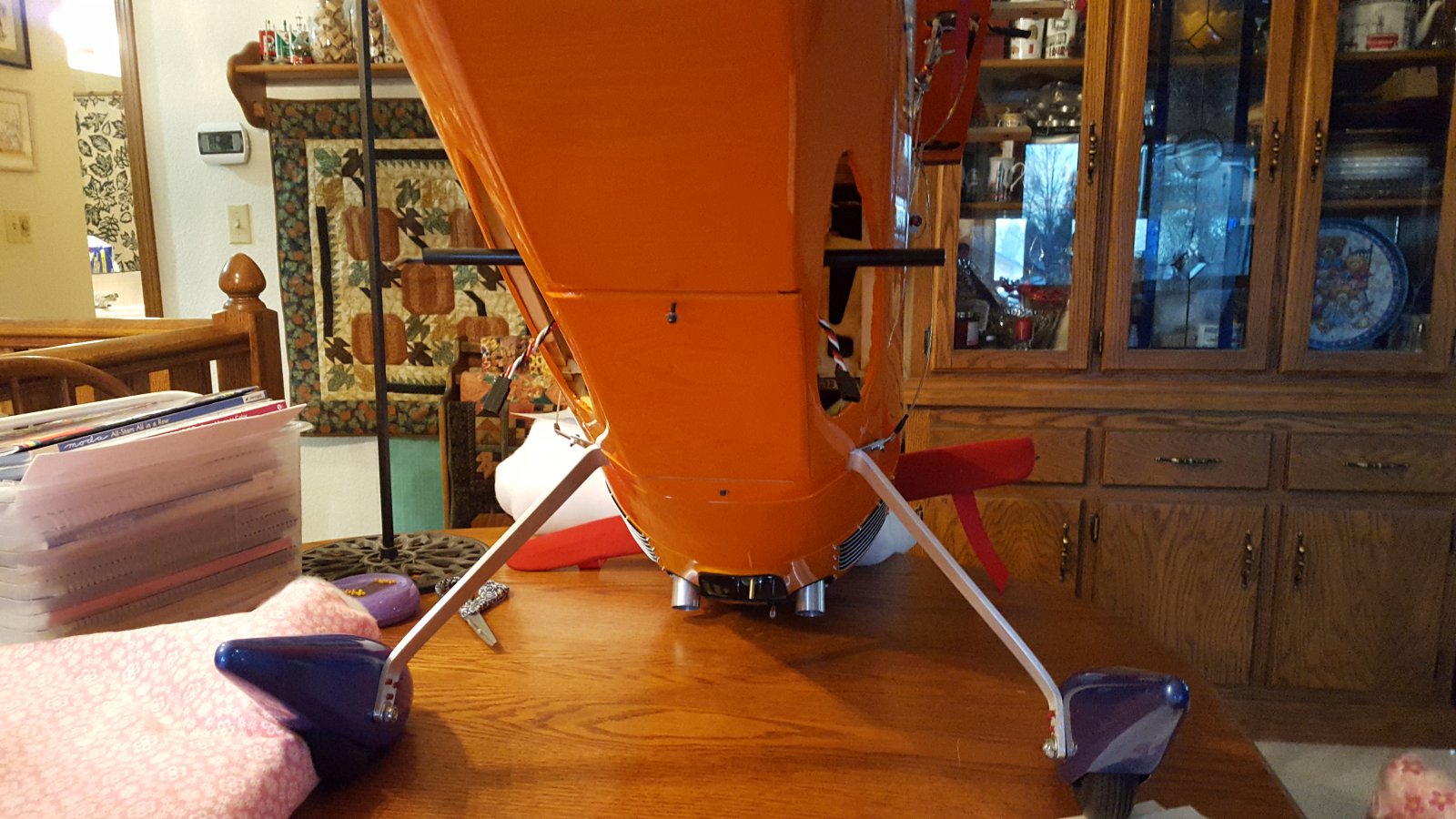

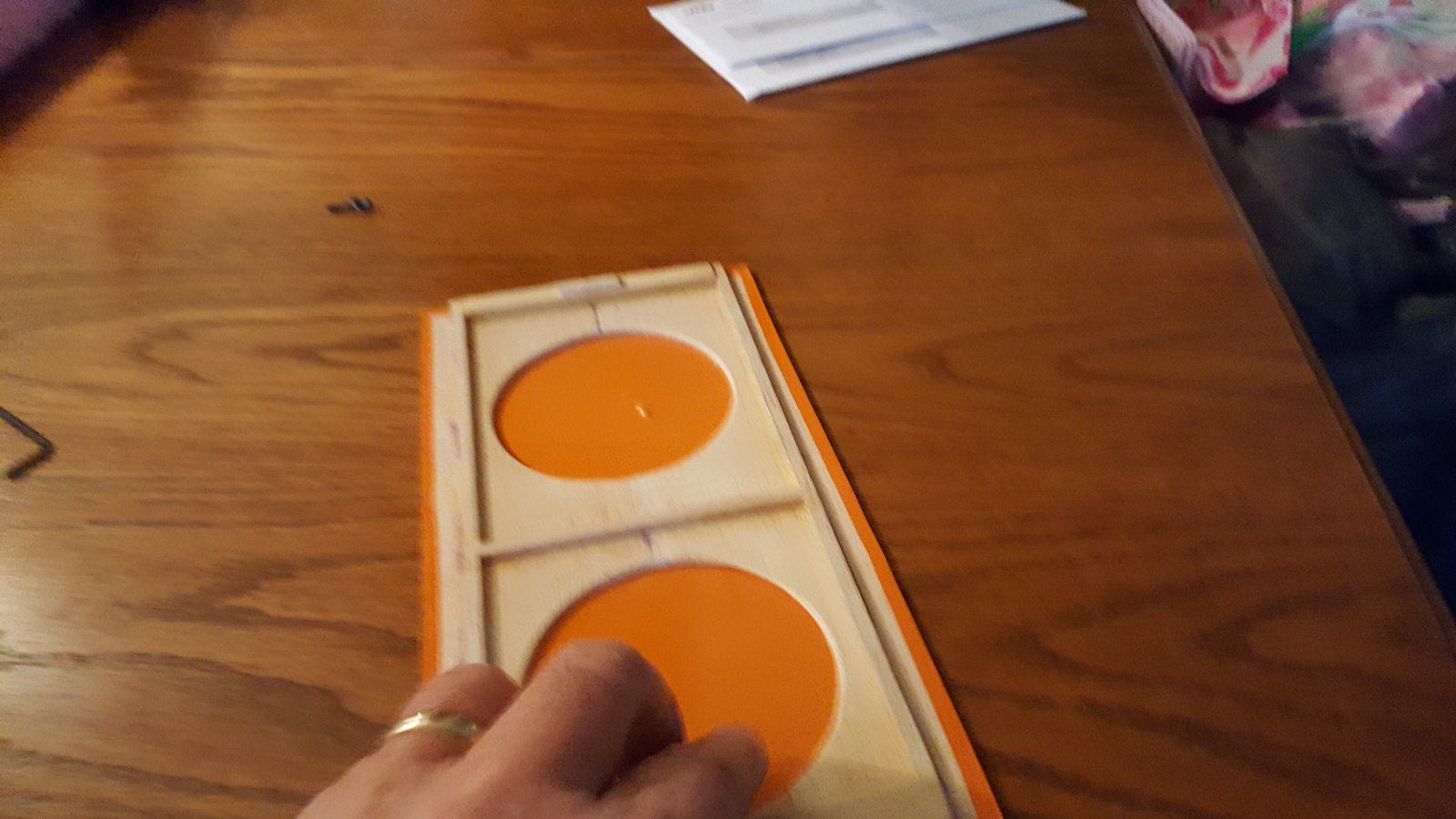

A favor please @Wacobipe and @Maxwell1945 if you both wouldn't mind? It won't be too long before I start sheeting the fuse and I am a little lost what should be done regarding the bottom of the fuse. Certainly I will sheet around the lower wing and down to the bottom of the can tunnel. Wondering however what you guys did about the bottom of the fuse. Did you just allow the covering to go around the formers and thus creating a semi-flat bottom? Or did you do something to give it some shape? I was planning on perhaps putting in a couple of stringers in the bottom of the fuse then sheeting all the way around. What do you guys suggest? Any chance you have some photos of the bottom of your fuse? Naked and then covered? It would be greatly appreciated.

The bottom of the fuse is left open for your choice of exhaust and you also need to get to the lower wing mounting bolts through the opening
. I covered the original to the edge of the bottom and then used a can of the stone paint to paint the under belly where the exhaust goes
20161107_164040.jpg 20161107_164028.jpg Hi Rob;20161107_164040.jpg 20161107_164028.jpg 20161107_163946.jpg 20161107_164015.jpg 20161107_164022.jpg

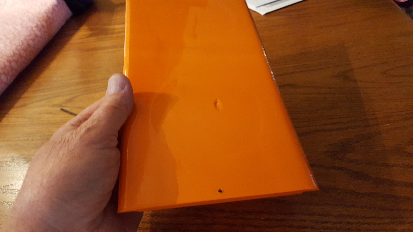

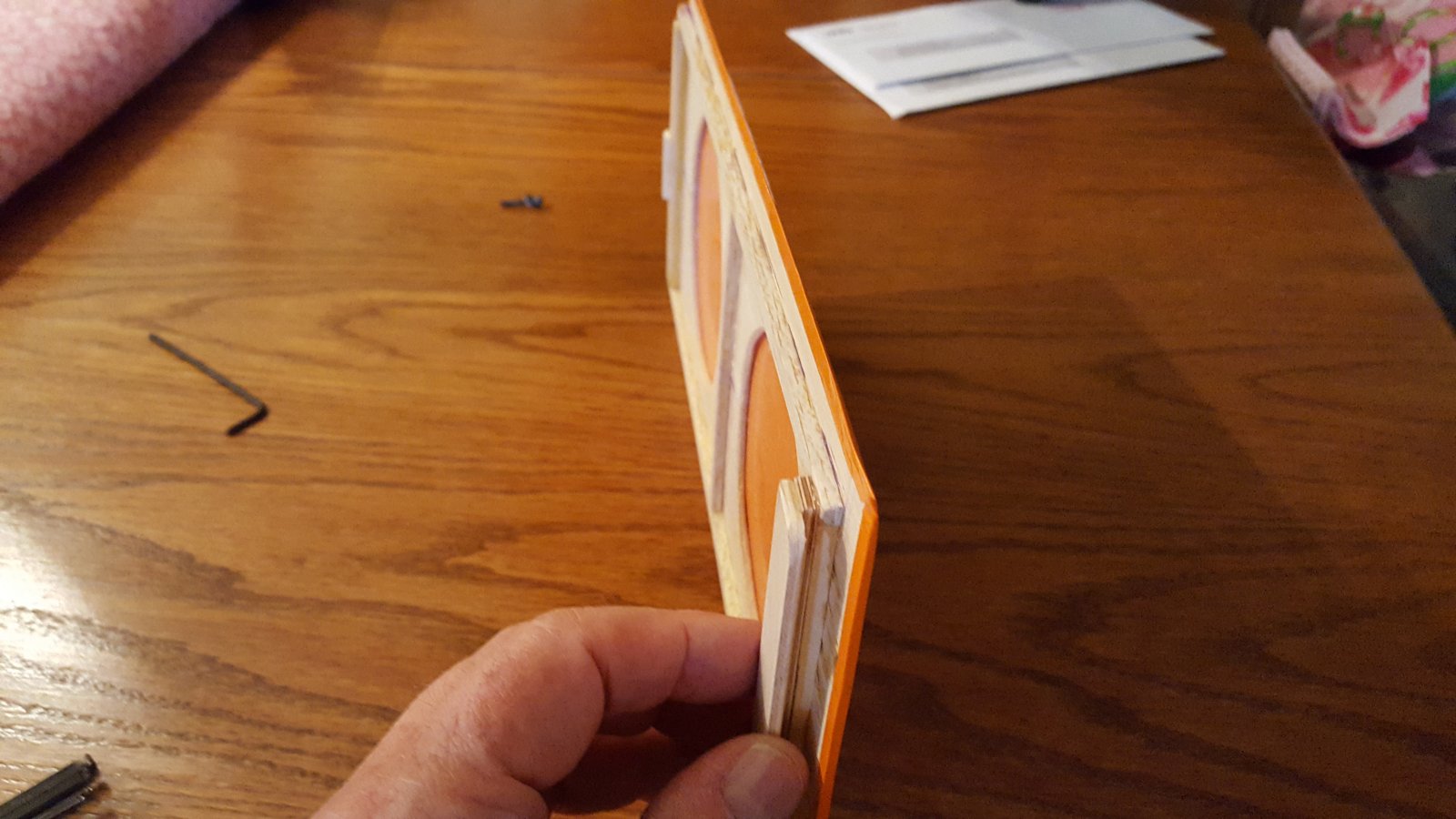

Here are some shots of the bottom of my Jtec M-12 . I made a removable hatch to clean up the bottom of the plane . Also covers up the servo wires and lower wing mounting bolts. The front of it is tongue and grooved the rear is held in place with a 4-40 screw and tee-nut. hope this helps !!

THAT'S IT!!!!! That is exactly what I was looking for. Ya know? There is something to be said for evil minds thinking alike. That is exactly what I had pictured in my head. Or something close to it. Now I know I am not crazy. LOL. Thank you, thank you...THANK YOU Van.

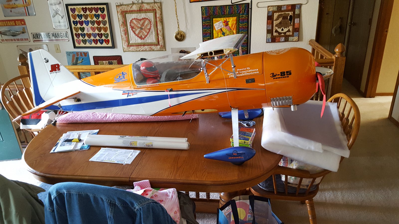

Hi Rob, Just a side view of my Jtec M-12, Hope it may help in some way.
Van
Thanks Van. You and Brett are definitely keeping me in line on this build. :way_to_go:

I do plan to build a hatch on the bottom of the fuse as @Maxwell1945 did with his. I was wanting a "cleaner" look for the bottom. Since I plan to use the in cowl mufflers/exhaust with the 70 twin, I have no need for a can tunnel to be opened up. I am also getting very close to a final decision on the covering and scheme.
