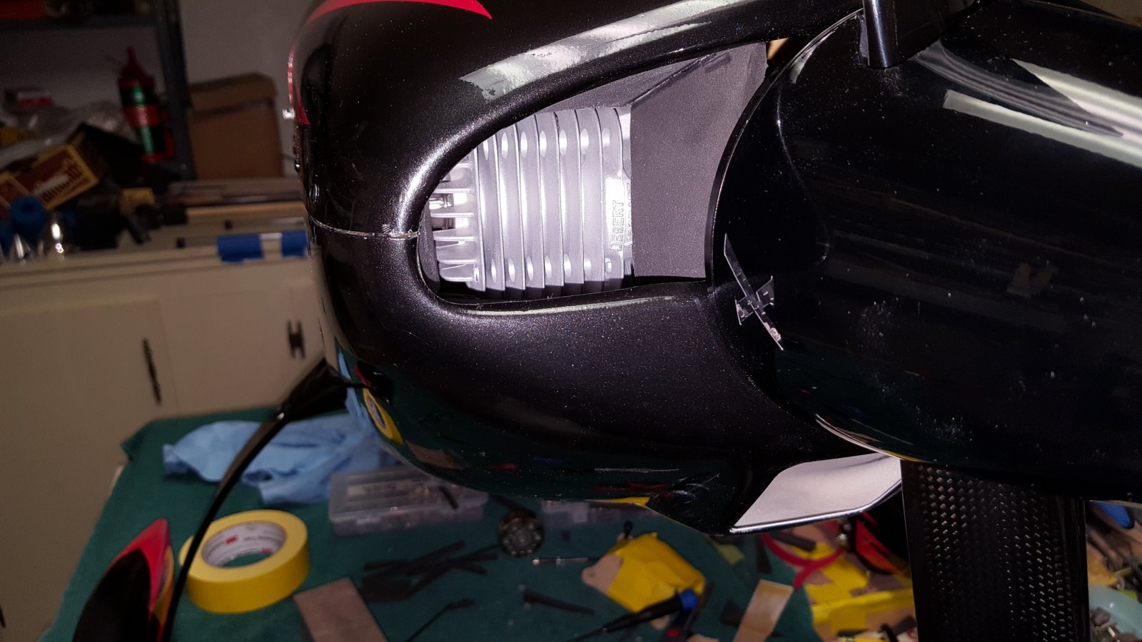

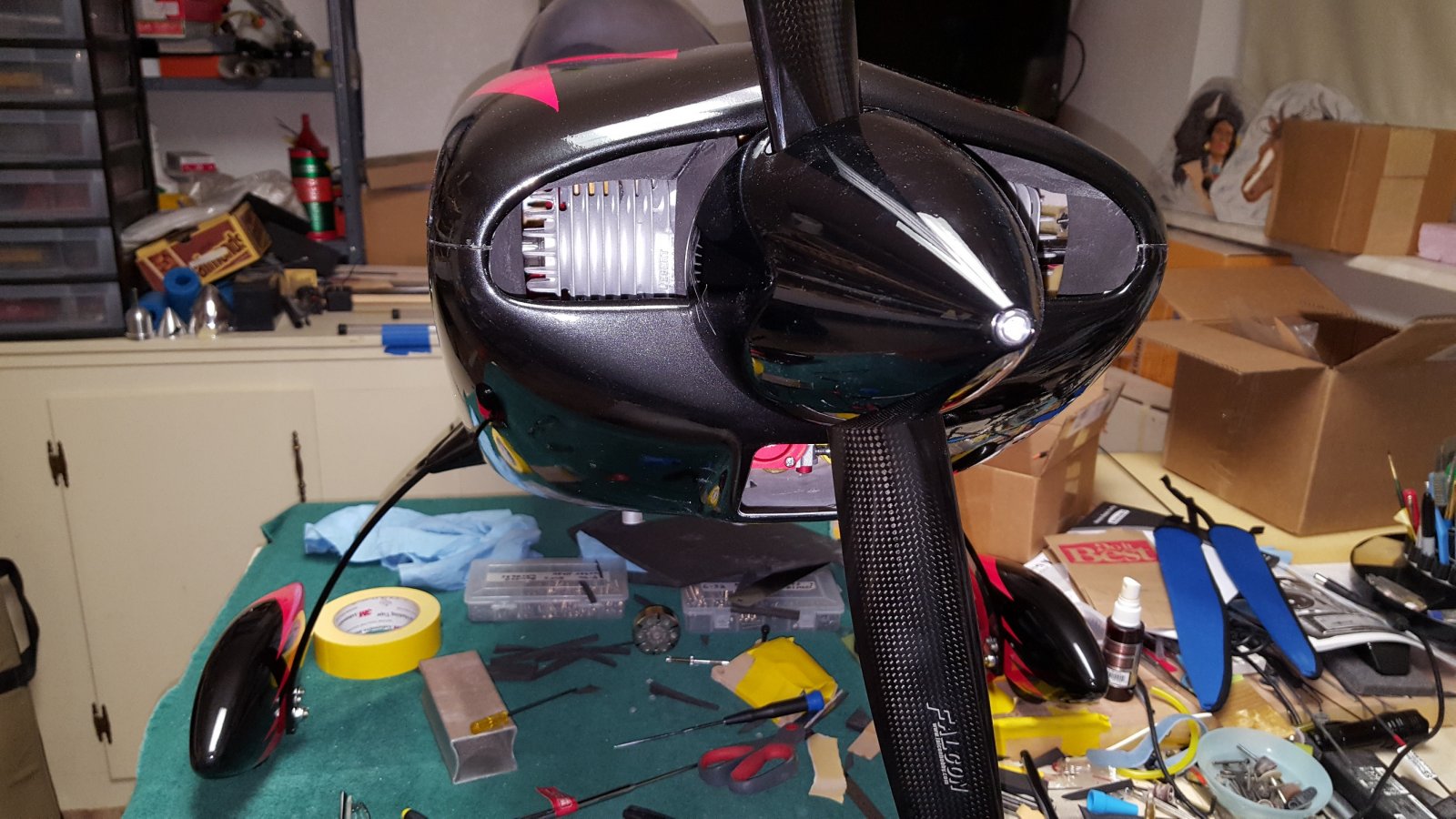

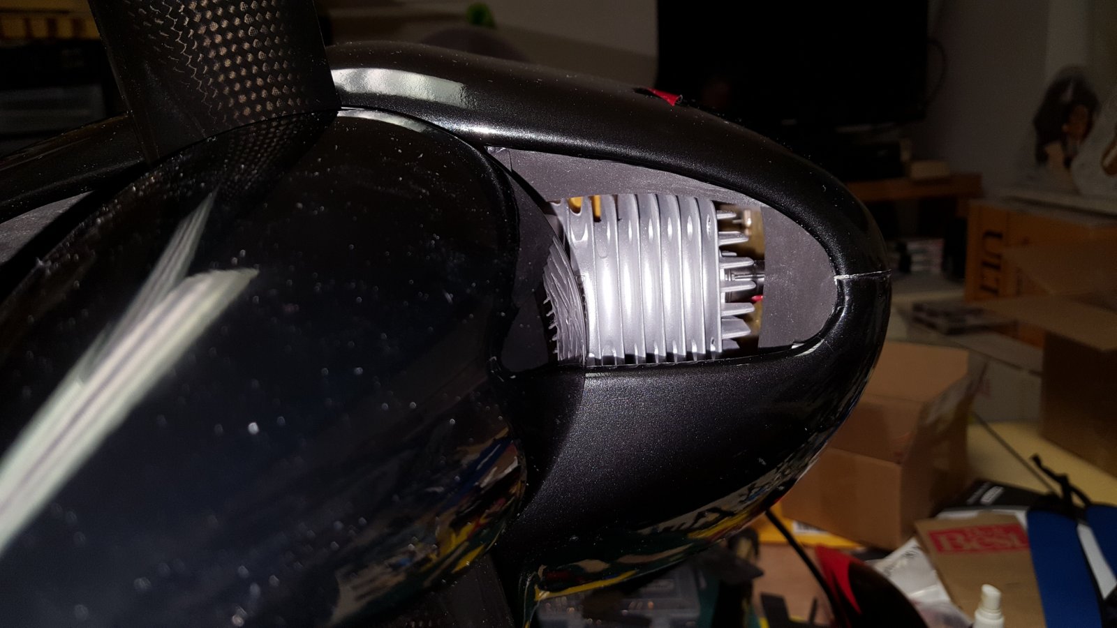

I finished the baffling tonight. It turned out okay. The next one I do will be better, but this one should be plenty functional.
My workshop looks like a Nerf bomb went off.:lol2:

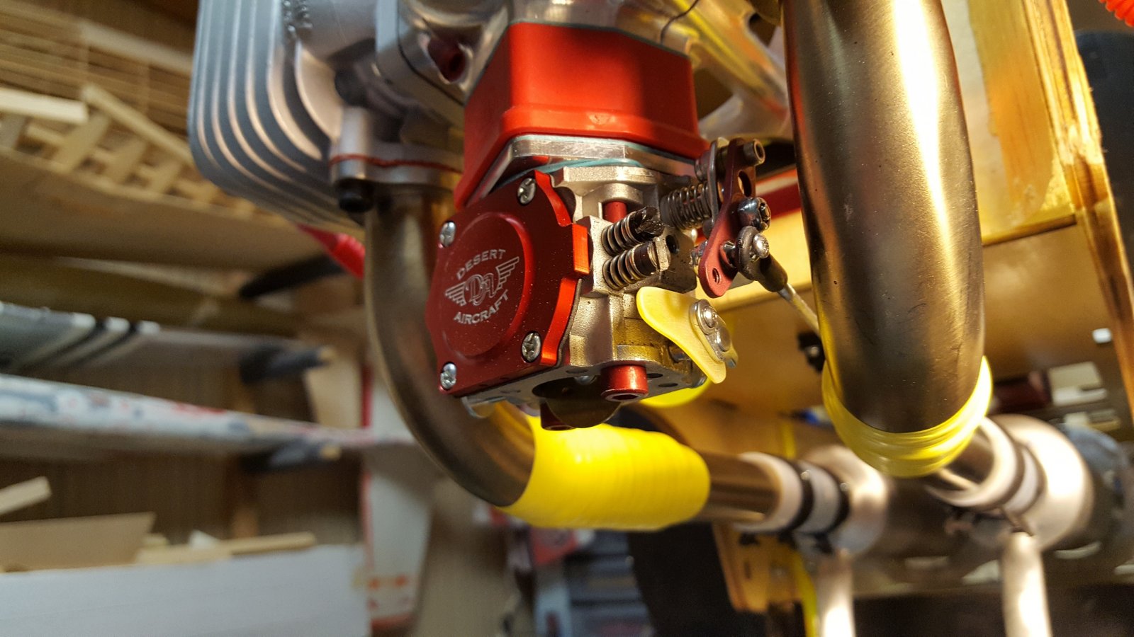

I got a few more things accomplished last night. I made a choke lever so I can just reach through the hole in the front of the cowl to set the choke. I used some BVM Poly Ply I had laying around and CA'd three pieces together for thickness and cut a slot in the back end to slide over the shaft and shaped the main part. I then used a 2-56 and a locknut to hold it on.
