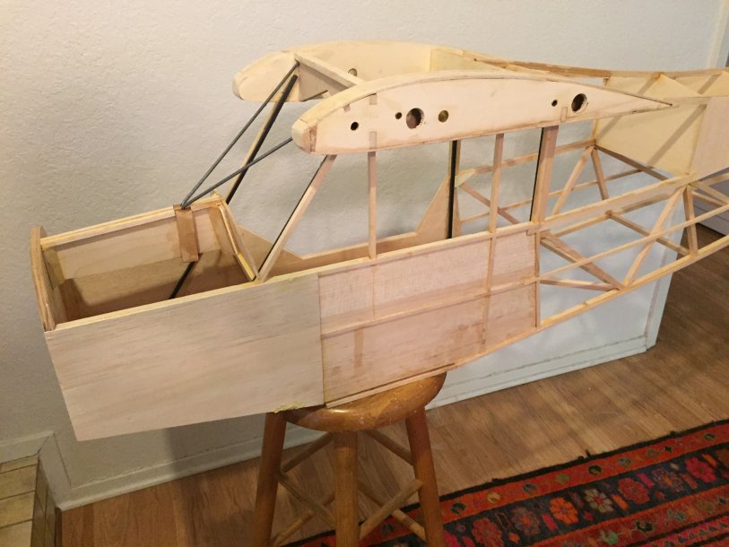

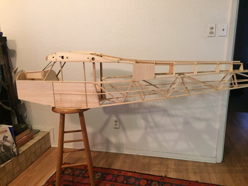

fencelake
Here are a few clean pics of the fuselage.

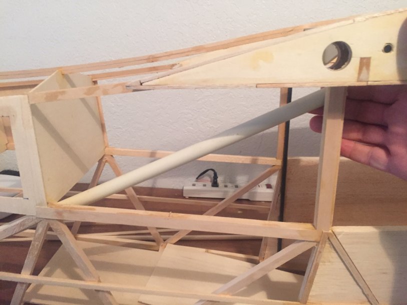

I had an epiphany last night. I started thinking about how I was going to get the servo wiring to the wings from the rear of the cabin. In the L-21 cub there are support members that run diagonally from the bottom of the fuse to the wings. Originally I was going to use wooden dowels, but today I bought 1/2" PVC so I can run my servo wires without them being exposed. The 1/2" PVC is a little bit bigger than probably the scale tubes, but it will look good and function properly. The aft cabin behind the back seat is open with a plywood flooring, so I'm going to have to a base board with my electronics, and then a false flooring about it. Really light ply (1/16") and I'll try to stain it. Servo wires that have to run forward will go below the cabin floor as well.

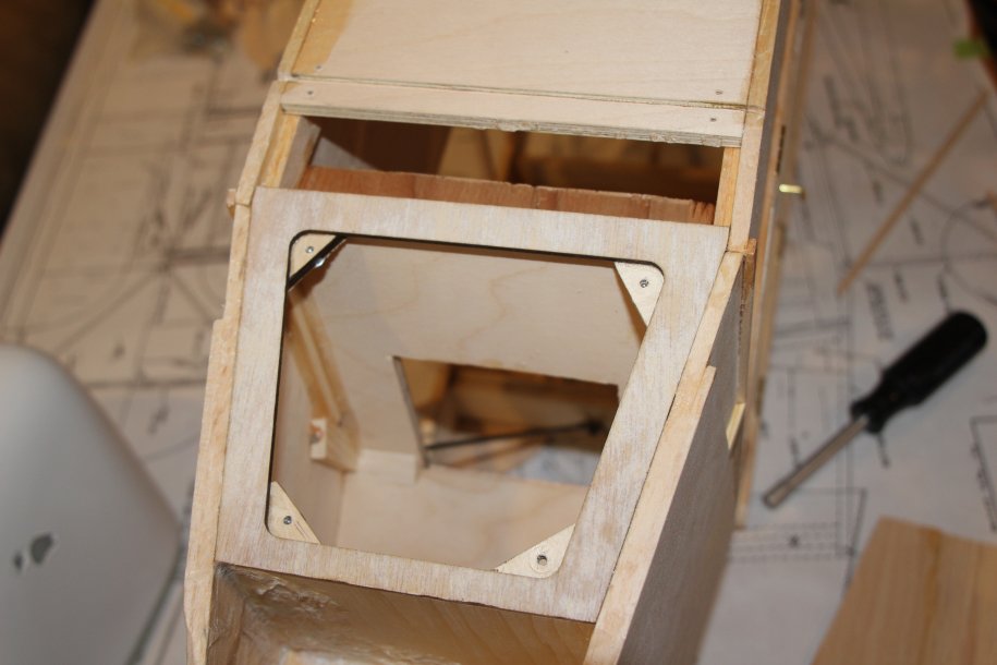

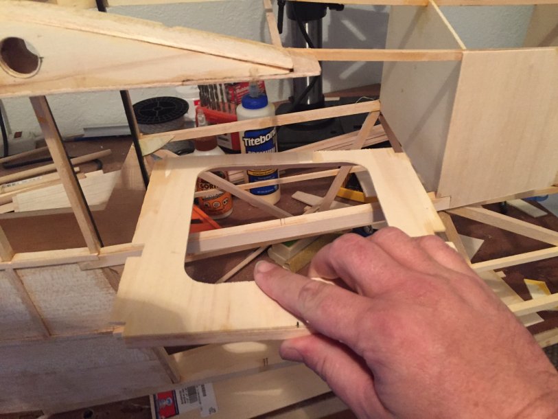

One thing I'm going to work on design-wise this week is deciding on access to the forward part of the fuselage. One thing that's always bothered me is not being able to access certain parts of my models, and I'm sure as heck not going to build myself out of my own plane. So... that idea is coming together.
Good looking build you have. I am to the point of covering mine. One idea on your tank access is to cut a half moon in the sheeting on the top forward deck where it will be covered by the cowl. Seen it on the internet somewhere, I'll look for the pic again.

I like the idea of creating an opening in the front so that the cowling covers it. I may do that. I also was looking at a Hangar 9 taildragger... I forgot the name, but it has a panel underneath that can be removed... that might work too. It has to work with the aluminum work, so I need to study it a little.

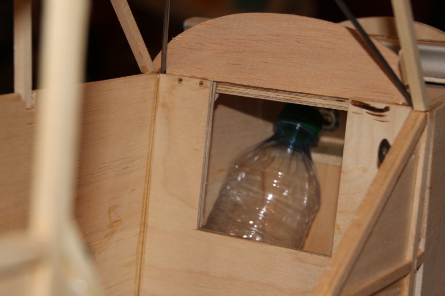

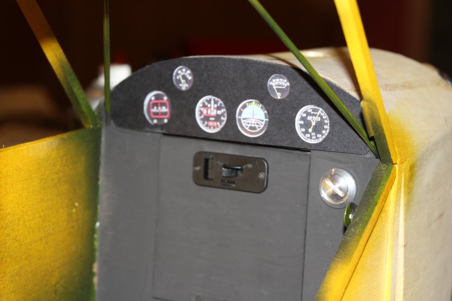

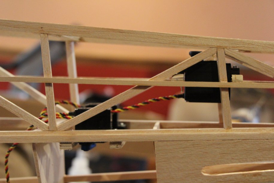

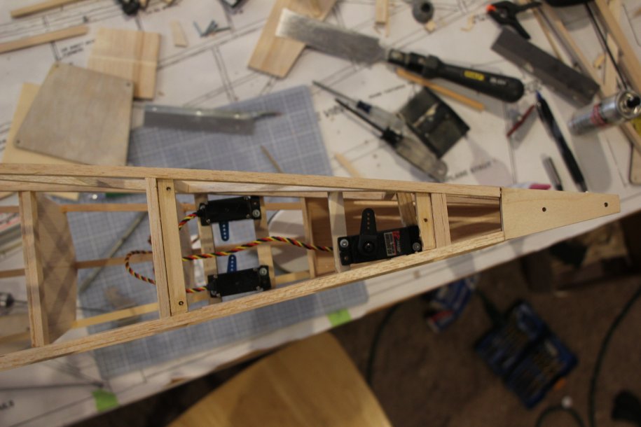

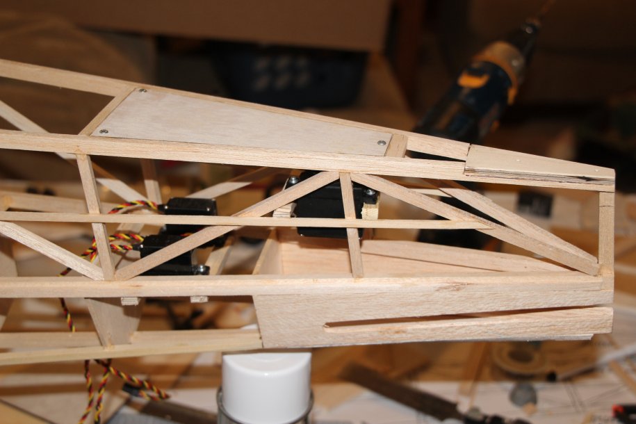

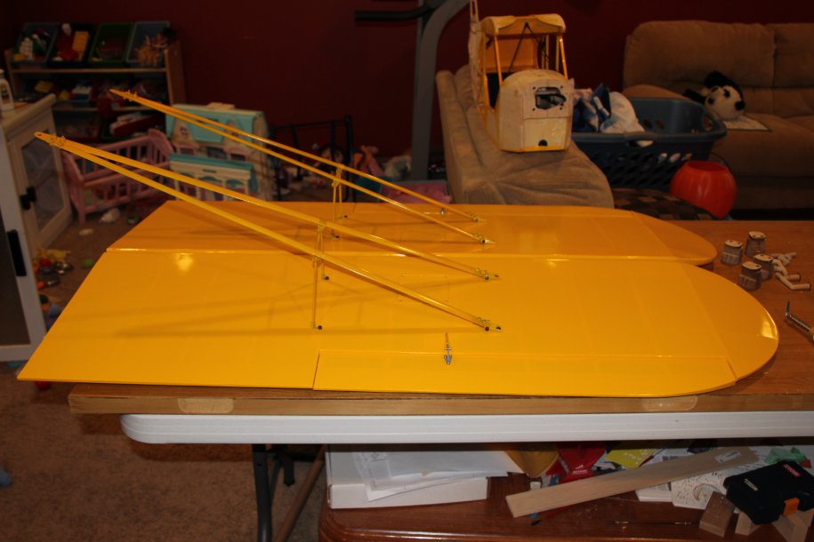

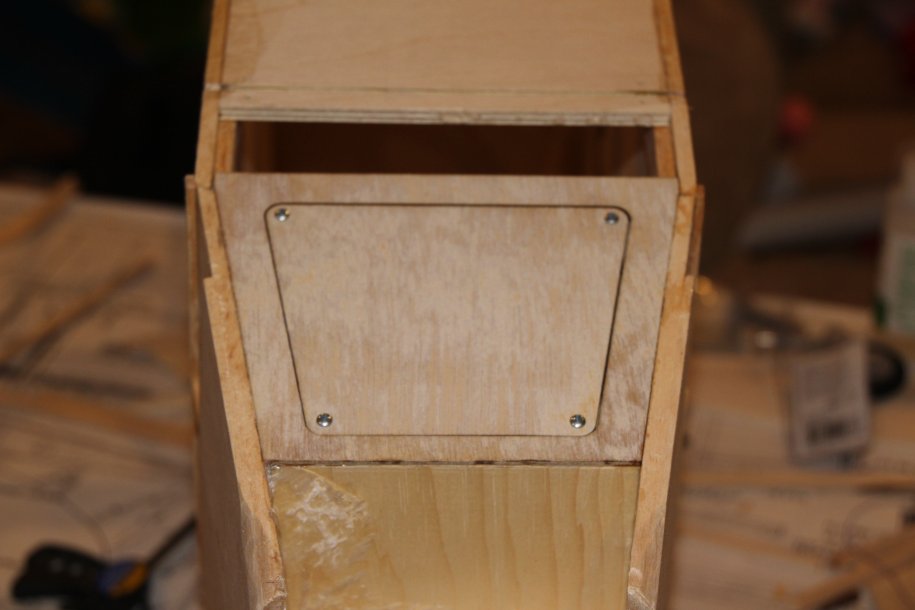

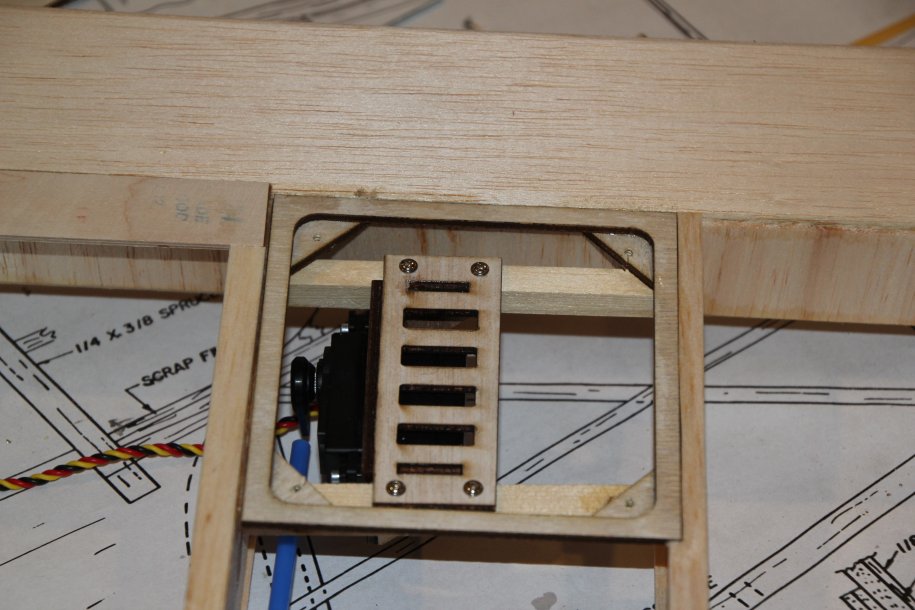

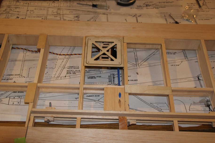

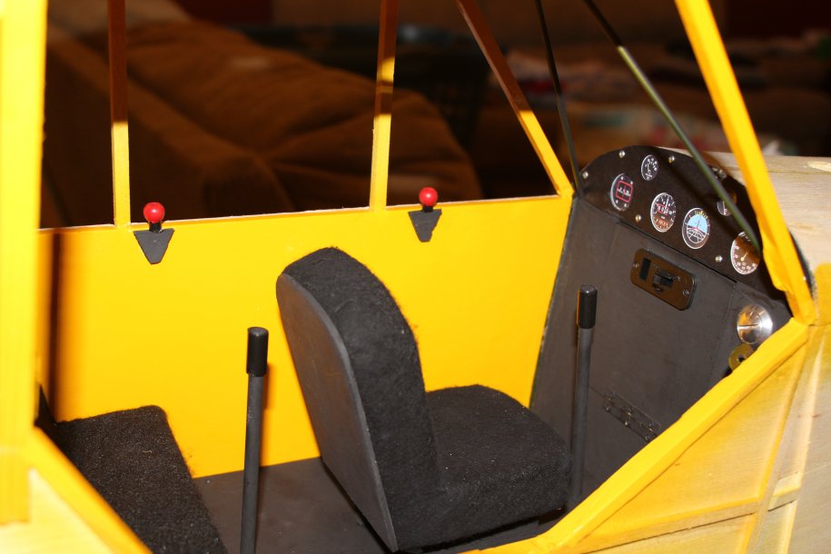

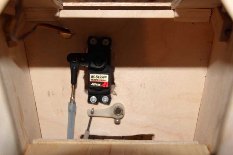

Here is how I did my BUSA 1/4 scale cub. Hatch on the bottom of the forward fuse. Hatch on the front of the cockpit area that had the power switch mounted to it. Hidden aileron servos and arms so all you can see is where it exits the wings and connects to the ailerons. Tail servos in the tail with a hatch for access.
