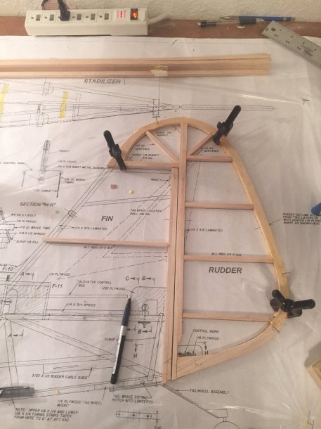

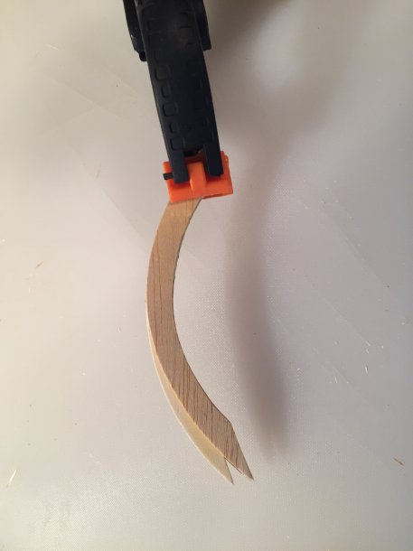

To solve the problem of the parts being misaligned I took a play from earlier in the build. I'm gluing one end first, and then I'll use my clamps to glue the other end to shape as it's supposed to be.

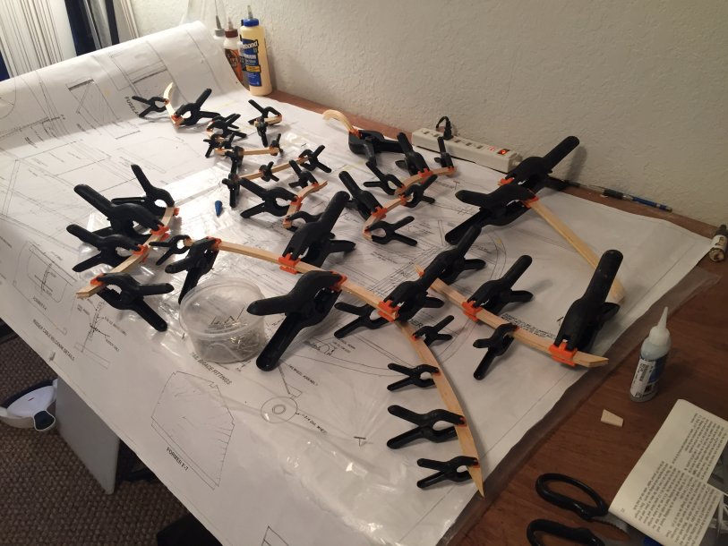

So now that I had all of these pieces popped out, I went ahead and turned into a lamination factory and just laminated all of them at the same time. My theory on lamination is use a lot of glue now and with sanding make it pretty later... after all, that's what they do on "How it's Made"!

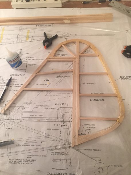

fencelake

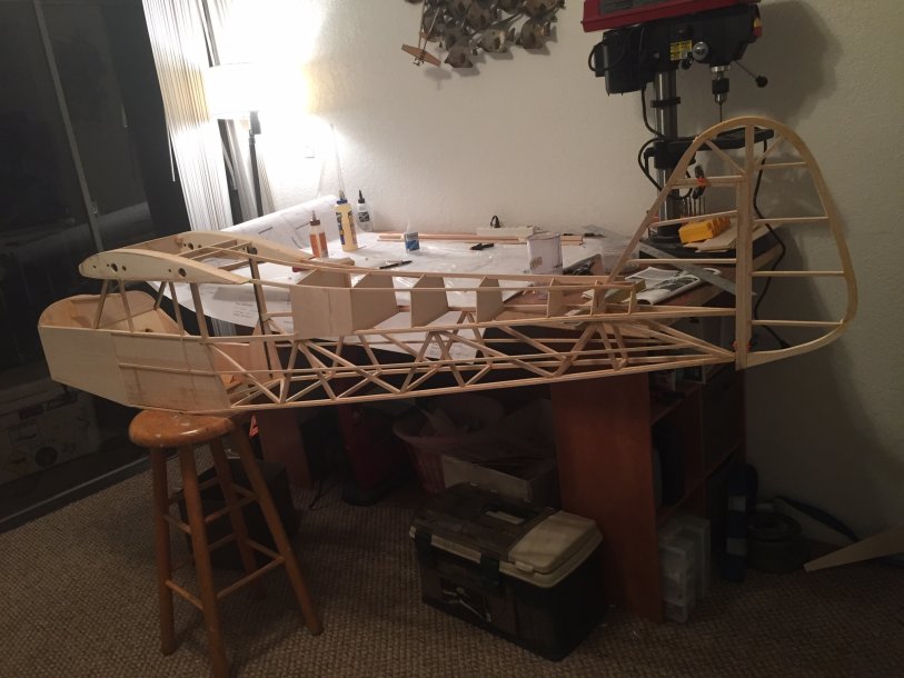

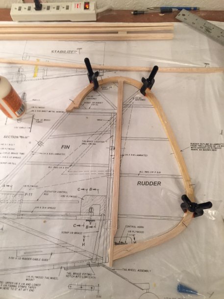

We have Super Cub looking stuff going on!! I built the vertical stab and rudder. Of course I had to put it on the fuse and stand back for a minute and look at it.
The only thing I don't like is the butt joints around the edges. I'm sort of thinking about reinforcing them somehow... maybe some thin 1/4" strips, that don't effect the shape or something like that.
A lot of work to be done yet. I need to sand and shape everything as well as fit it properly on the fuselage. Tomorrow will be busy!

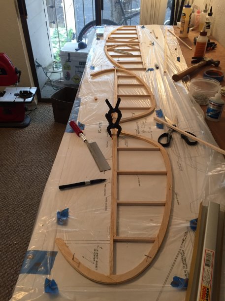

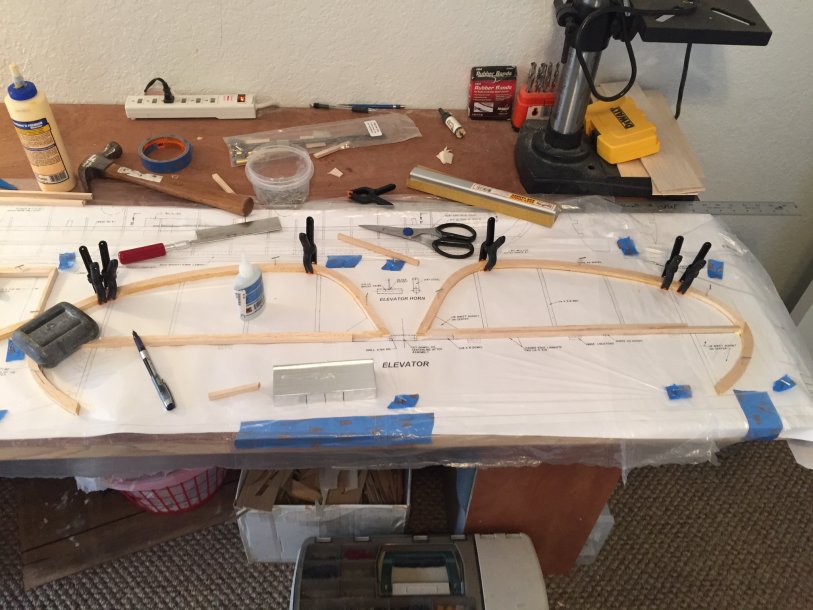

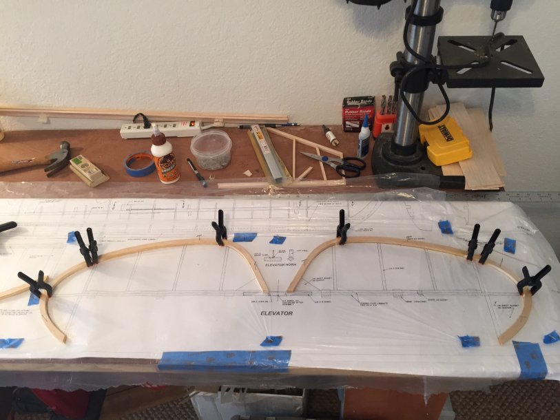

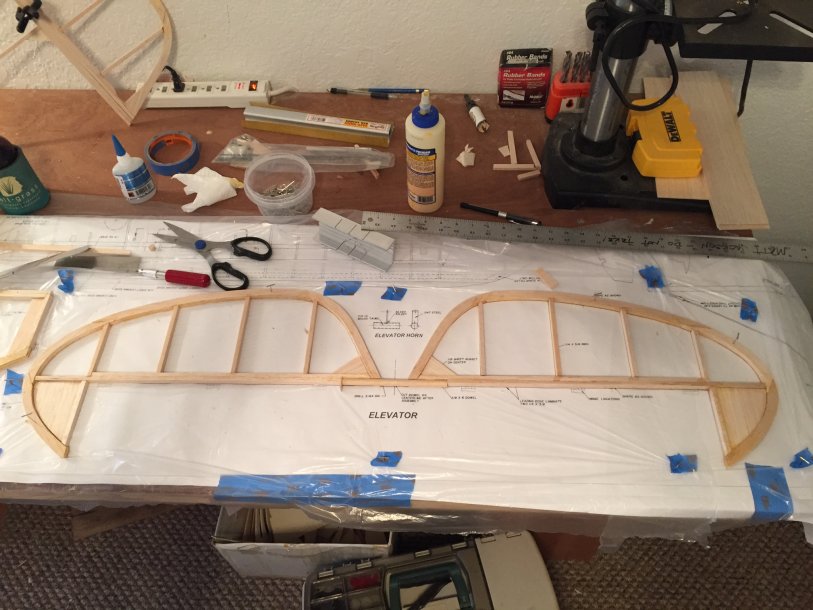

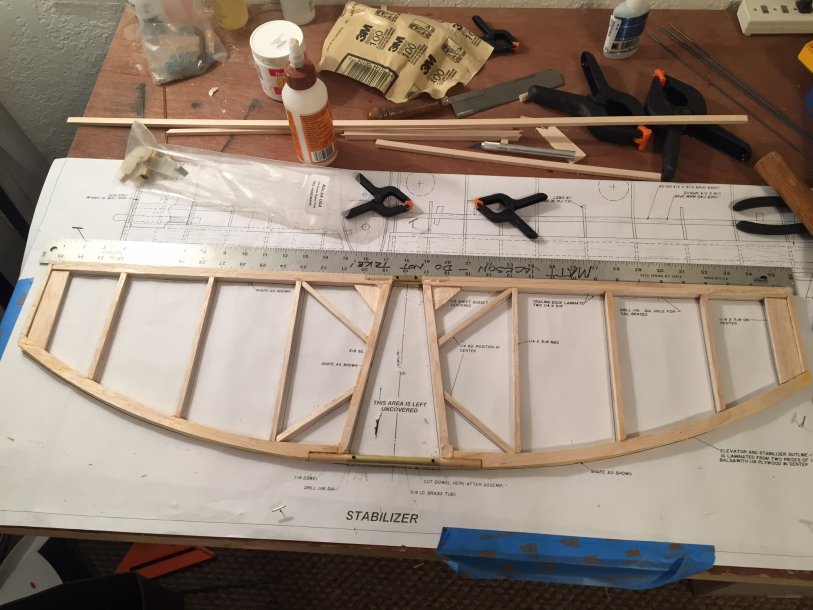

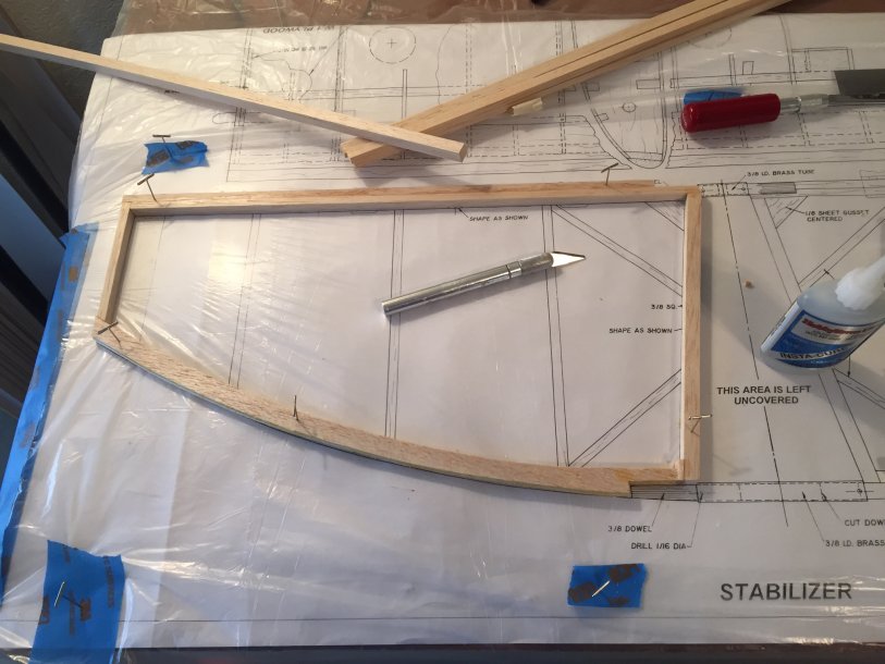

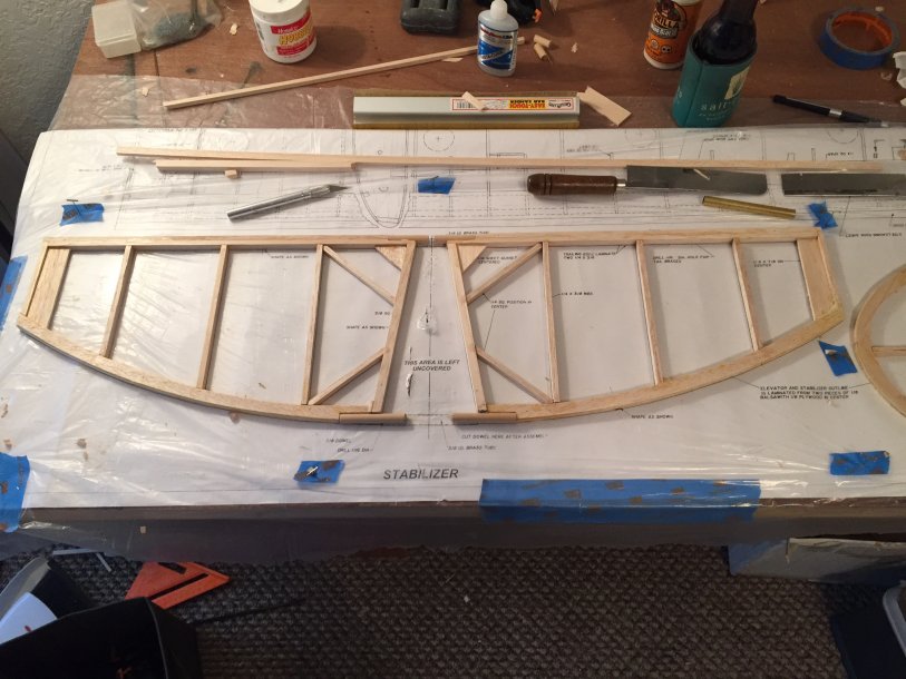

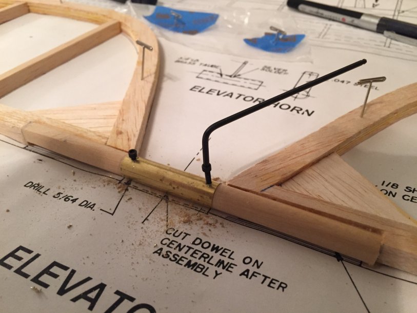

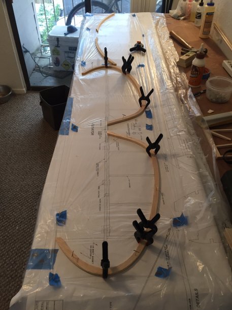

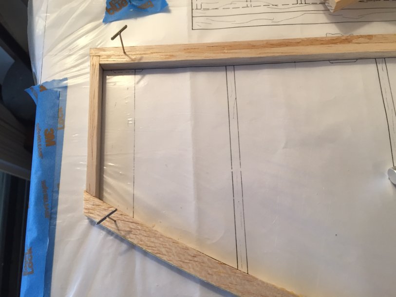

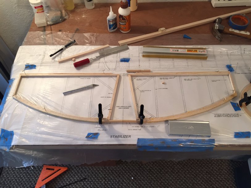

More work complete this weekend. I finished the horizontal stabilizer and elevator. I'm still a little skeptical about the wooden dowel/brass tube connection, and getting everything aligned properly was a little tedious. Here's the first few pictures of construction. I had the whole plan laid out and built both parts simultaneously.

fencelake
As I got into the build I found that one of the laminated pieces of the stab was a little short, so I had to add a piece of plywood to fill the gap.

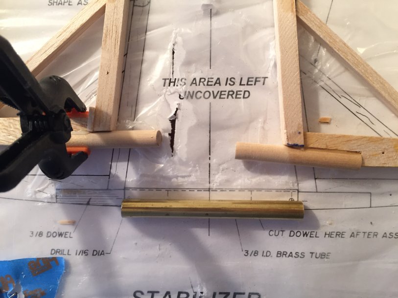

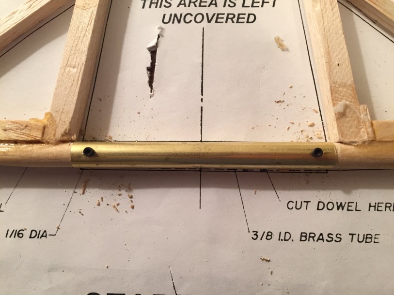

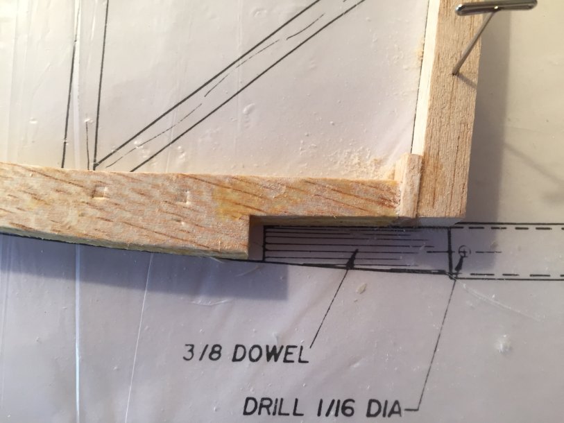

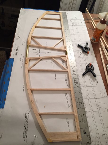

fencelake

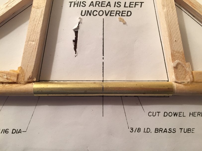

Once I built both the stab and elevators the wooden dowels have to be cut and the brass tubes installed. Making sure that everything is aligned, and there is proper spacing between the surfaces is critical. I really took my time doing all this. I had to cut one of the brass tubes a little to fit properly, but it all came together pretty straight.
