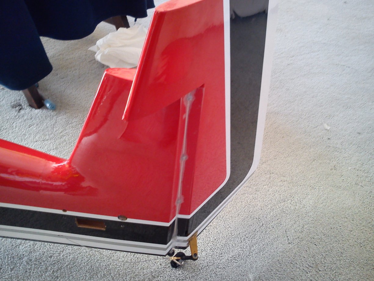

Aha yeah it's going together pretty quick. That last pic is just another one of it all mocked up right out of the box. I opened the box, pulled the plane out, and slid it all together.
I just finished the rudder and tail wheel last night and one wing panel this morning. I'll post up pics later.

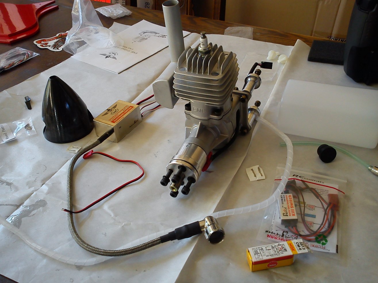

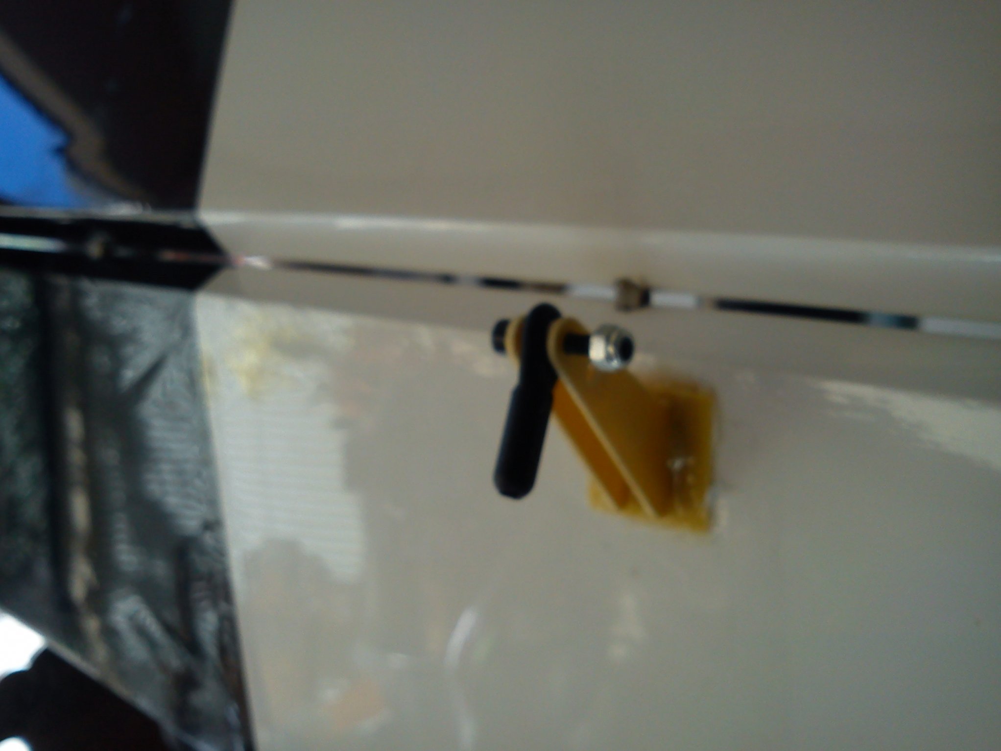

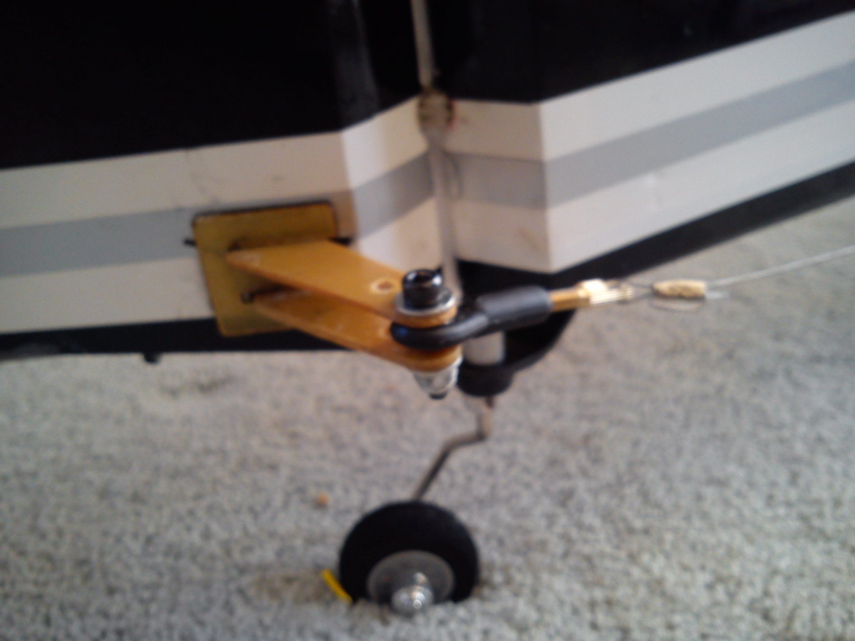

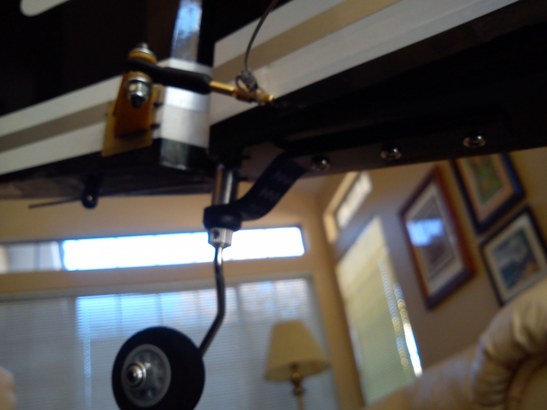

So i got the rudder control horn and hinges glued in with 30 minute epoxy the other day. I also ran the pull-pull cables through the fuse and i'm just waiting until next week to get servos for it. I'll be going with HS-7955s all the way around with 1.5'' arms on the ailerons and elevator and a 3.5'' offset arm on the rudder. I still need to decide on a throttle servo(any suggestions?)

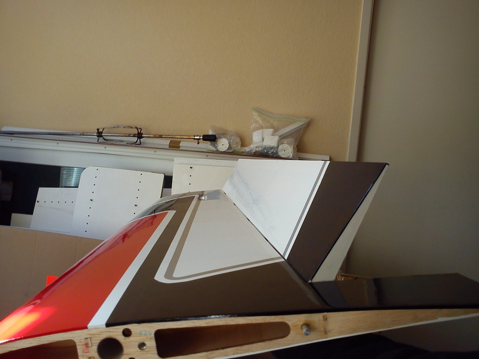

Got both the wings hinged also. The plane is really coming together but i still have to get a bunch of little things like fuel filters, fuel tee, fuel tubing, and fuel dot(probably some other stuff i'm forgetting too)
But i do already have my RCEXL Opto kill and 3'' carbon spinner though
