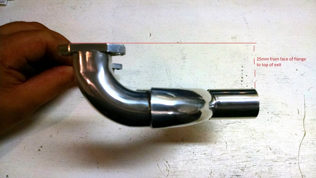

Had a guy ask somewhere else so here's the graphic that explains the drop. It is 25mm from the flange to the top of the exit (would be 37.5mm to center of the exit.)

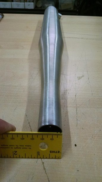

Bolted up the ProFlow small smooth pipe and was stoked to see how much more power I got out of the little 40! Picked up about 700rpm more than stock muffs and Pinnacle canister!! I've got my eyes on a certain Dec release 30cc plane that'll get a 40 twin with the pipe as well as a 21x8 Mejzlik...

Good stuff @SupaTim , thanks for the update. Awesome on the 700 rpm gain.
Would you please confirm something, the small ProFlow smooth pipe has an inlet of 7/8" and I thought your header was reported as 1" diameter.

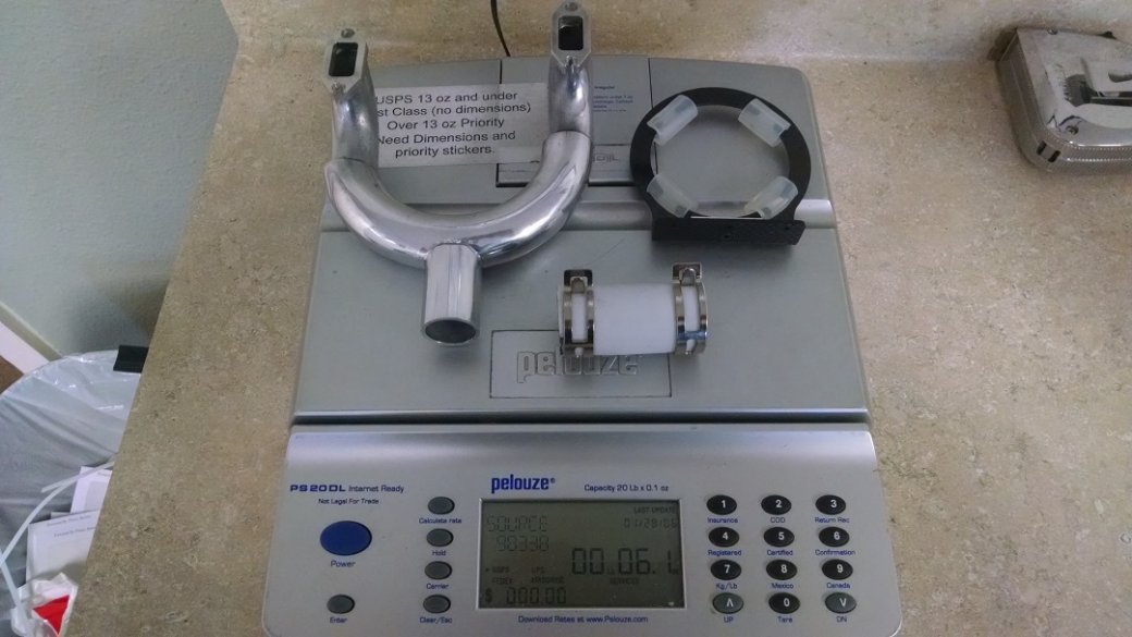

Have you weighed everything to see what the net gain is over the stock muffler?
SupaTim
Hmm, I'll look at it tomorrow. It's whatever Dave sent me 6 or so months ago. Haven't weighed anything as the dramatic increase in power will easily outweigh the little weight a pipe and mount will add.

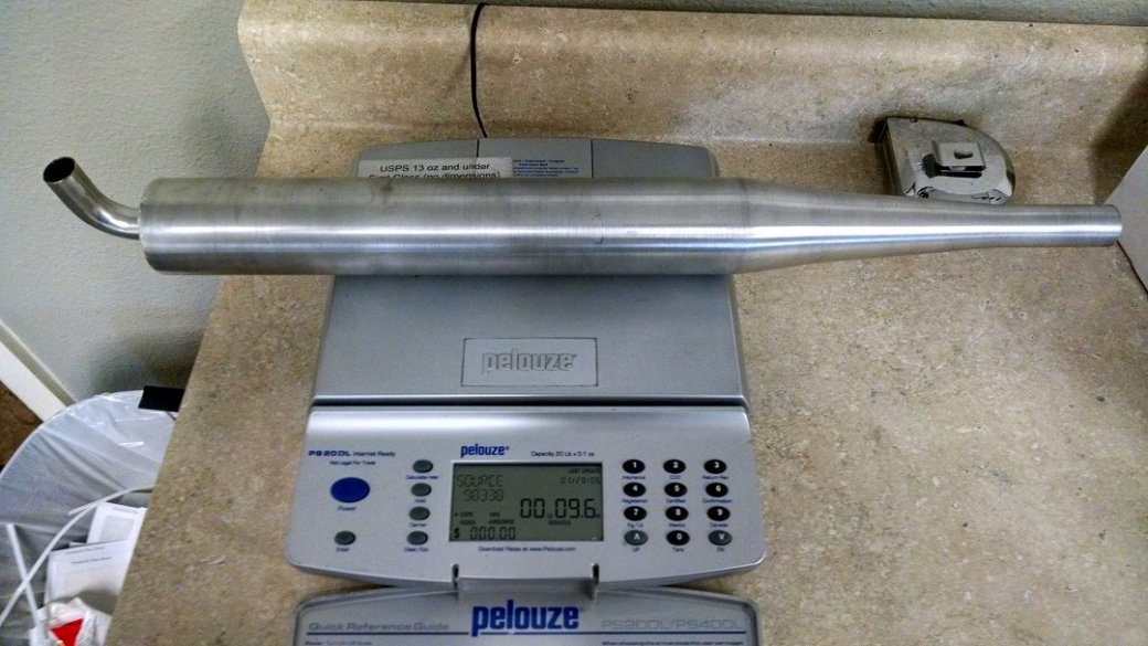

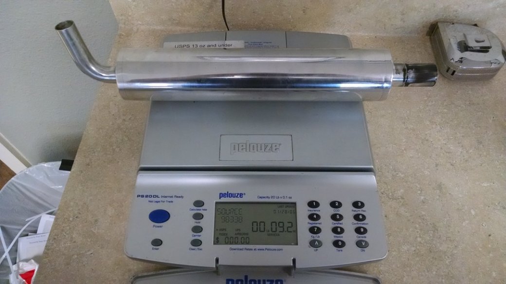

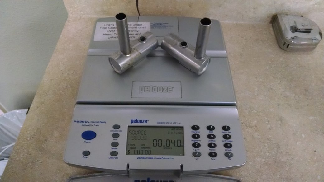

Regarding weight, here we go...
Stock exhaust: 4oz.
Header with clamps, coupler, and medium mount for either pipe or canister: 6.1oz.
Pinnacle medium canister: 9.2oz
ProFlow small pipe: 9.6oz
Soooo, a basic 2 in 1 header/canister/necessary mounting hardware will be 11.3 oz or 11.7oz with the pipe.
