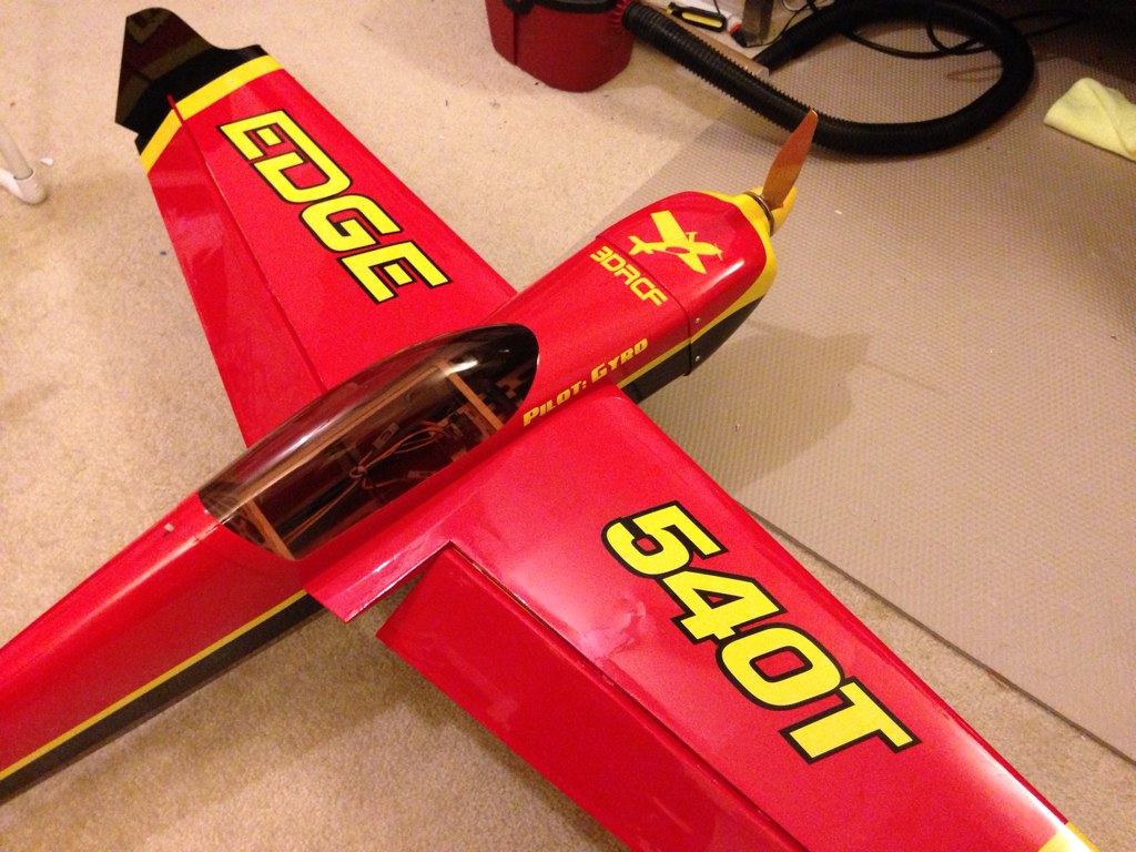

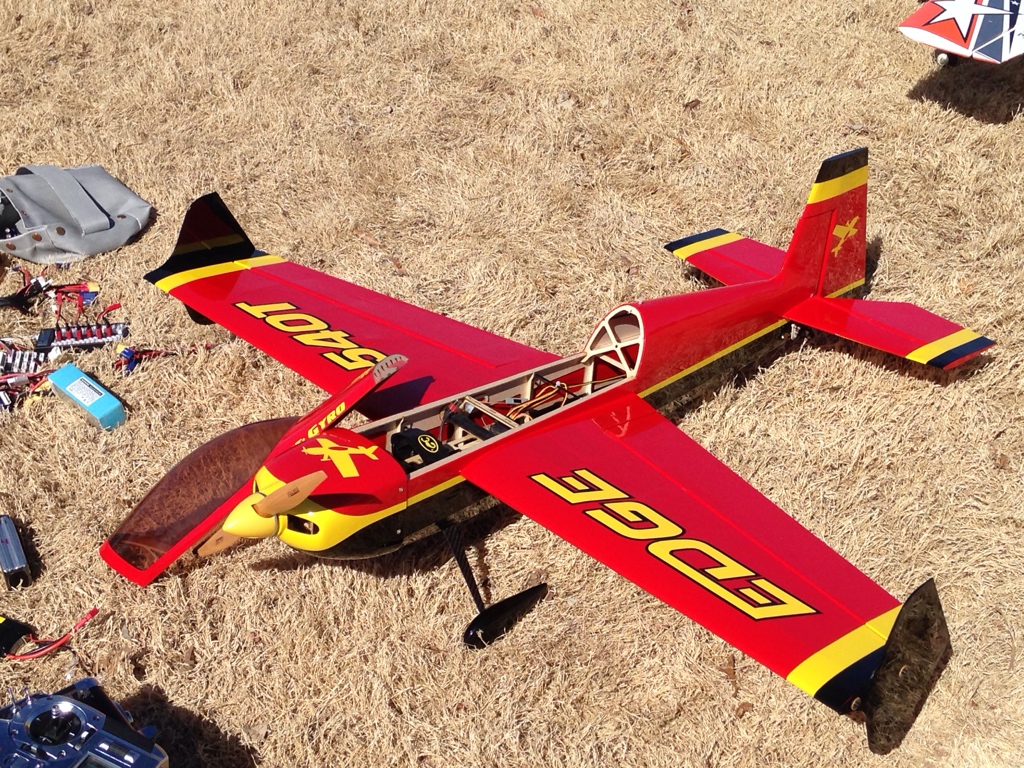

Haven't got it outside for a proper pic yet, but here is what I've got so far, thanks again!!!
arkie
30cc

I like the graphics you have. Is that yellow layered on top of the black? I have a vinyl cutter and will cut my own.

The vinyl is yellow layered on top of black.
