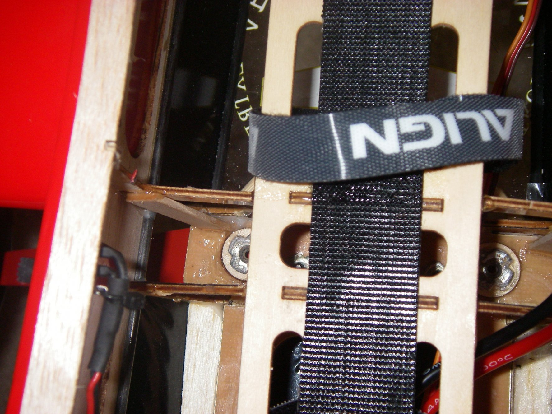

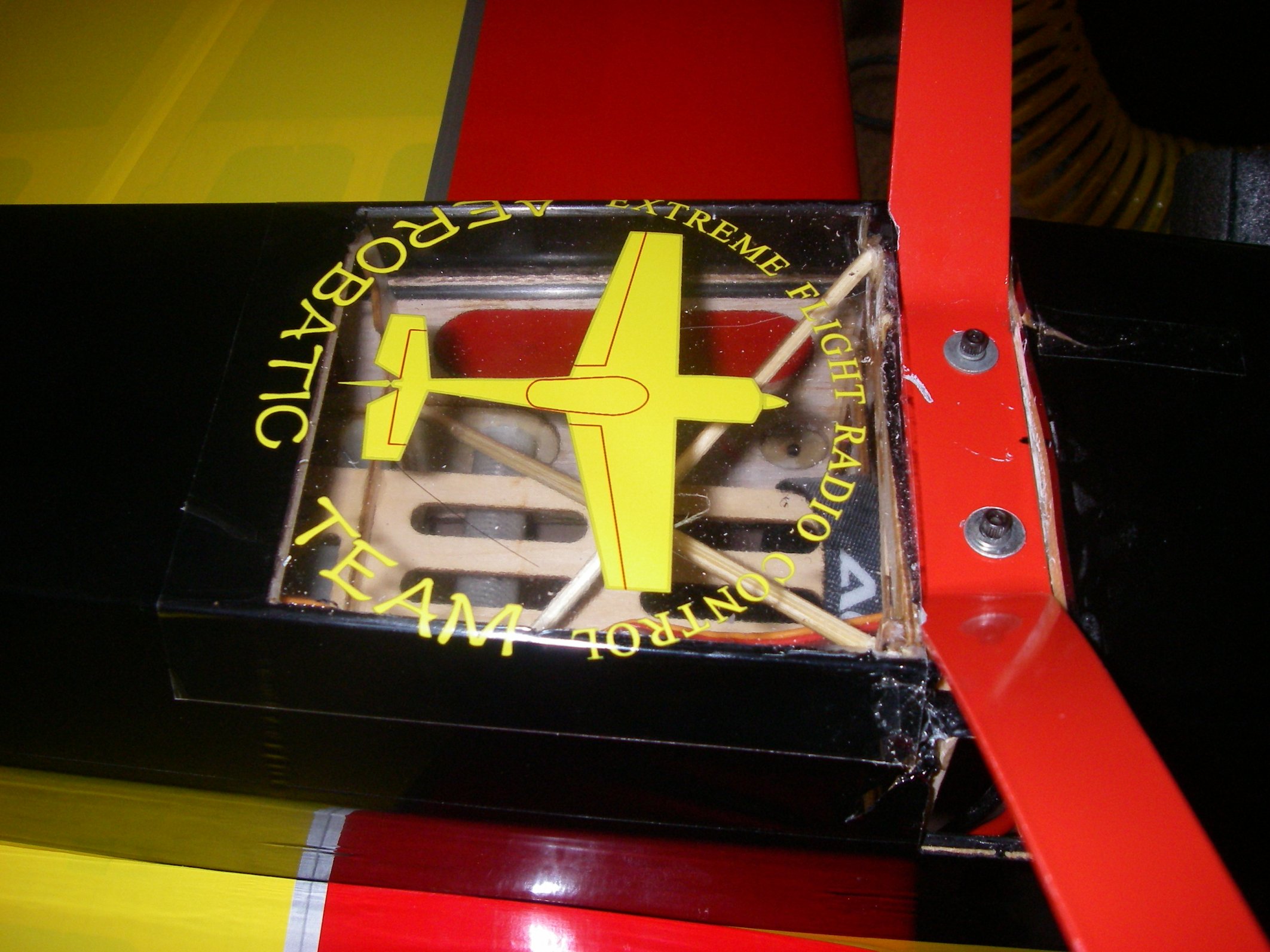

I thought I'd attach some photos of my undercarriage refit. The highly flexible Mini Ultra-stick struts go a long way to protect the damaged structure. The region around the undercarriage did a great job absorbing all the damage from my maiden-crash (ahem, reversed ailerons... ask me about my new preflight checklist).
In the second pic, you can see popsicle sticks CA'd to stop the landing gear buckling. The front of the mount is still intact and fortified with some CA. As you can see, Monokote repair is a skill yet to be learned. Also, you can just make out the smaller blind nuts used with the new struts.

Good job patching that up.
Small jobs like that are perfect for practicing your covering skills. It's definitely intimidating but it's not too bad.
