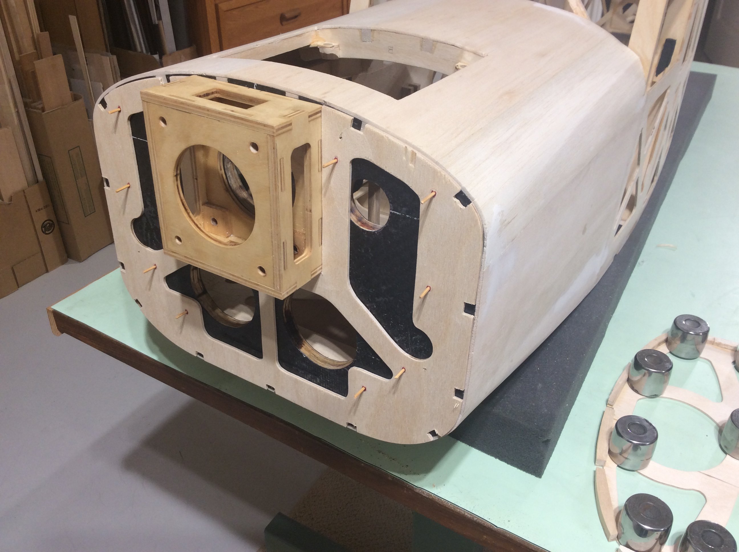

The main reason the fibreglass cowl did not fit properly and it weighs 32 oz. I believe I can build a balsa cowl that weighs no more than 15 oz half the weight. And as second benefit cover it with film.

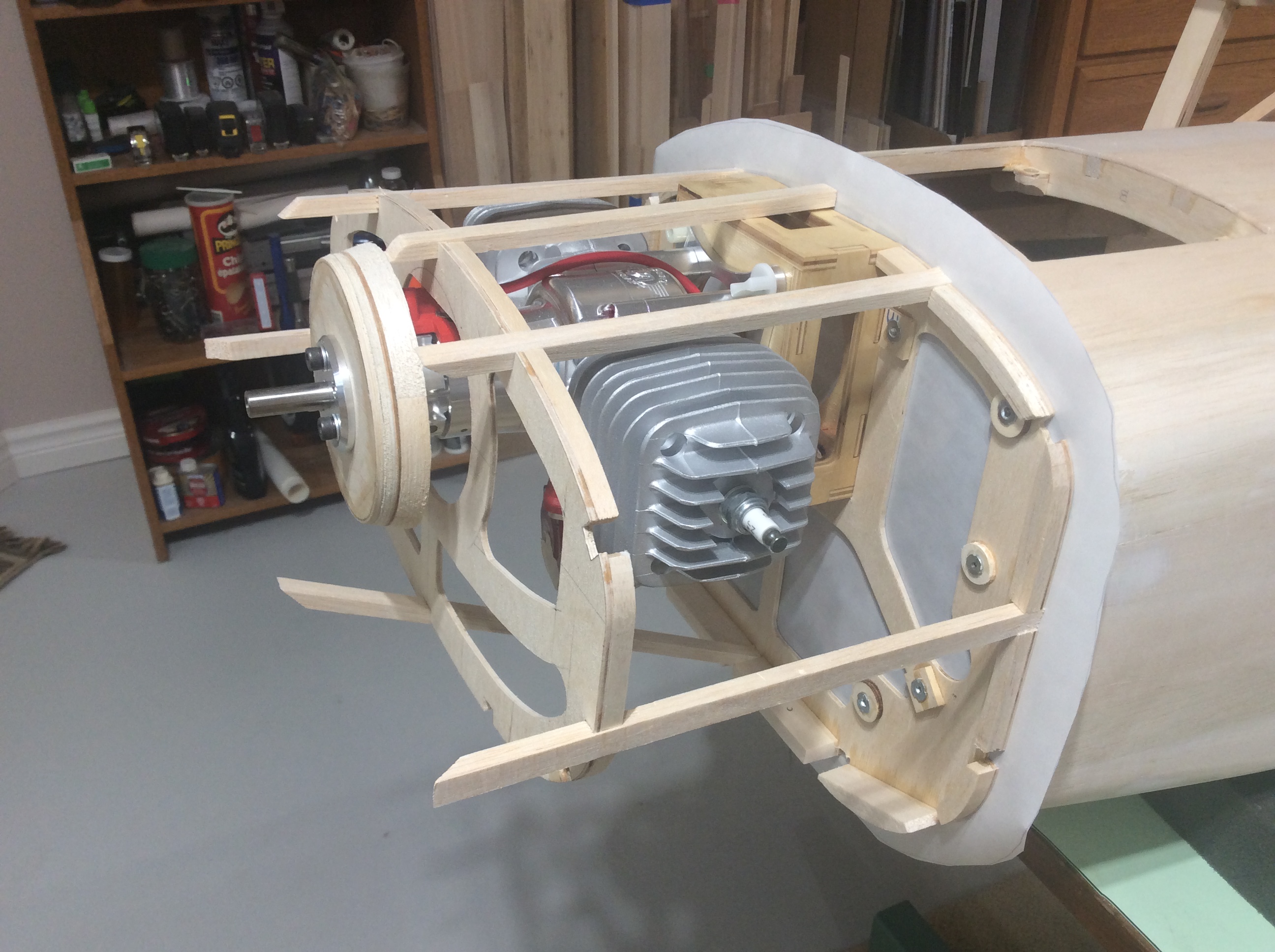

Ok this how far I am and I keep staring at it then changing something and then staring at it aging try to figure out how to blend everything together from the firewall to the first bulkhead and then to the spinner ring. Now I have discovered that once covered I cannot remove the cowl so that has to be addressed first.

Ok I am getting desperate with this cowl no picture this time made mess and started over on the front part pictures to come. Right now all I am trying to come up with something that will cover the engine nicely and look some what good. DBEA73AC-908F-4E2A-BEF8-1FD52AEE2A07.jpeg

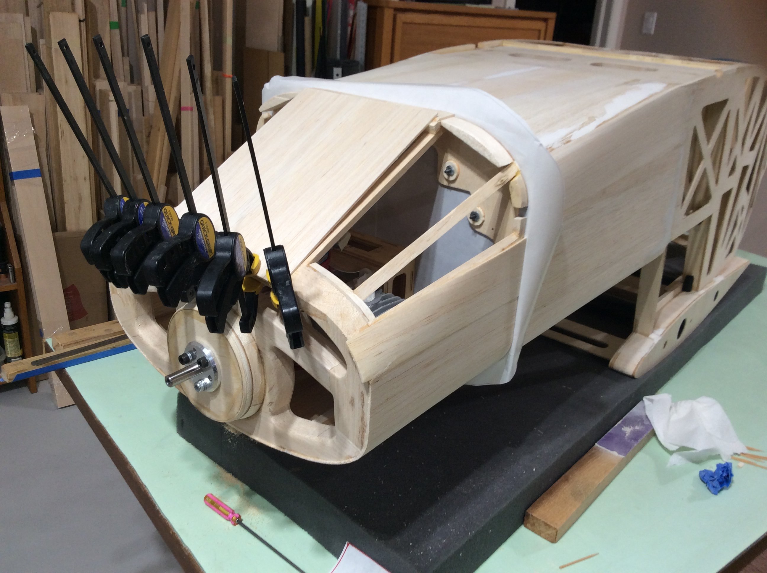

Well this is how far I am working hard at it. The top is covered and it clears the spark plugs. It is removable. Bottom is partially covered. Now I have to come up with a plan how to do the side corners can be covered. One thing for sure it is going to take a lot of careful sanding.
