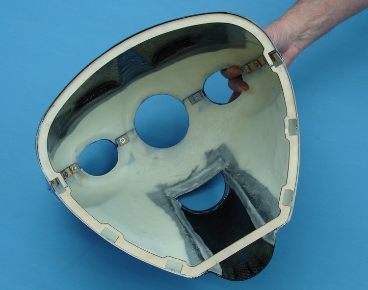

I found AW carbon ss cowl and it wont fit. Front of the carbon cub is rounded at F-1 and not flat sided:(. But! Does not mean some "kit bashing" can't be done to make it work :).
Bartman
Defender of the Noob!
That's probably a result of the Carbon Cub not being a rag and tube airframe so they're able to soften some of the sharp corners, but I don't know that for sure.
