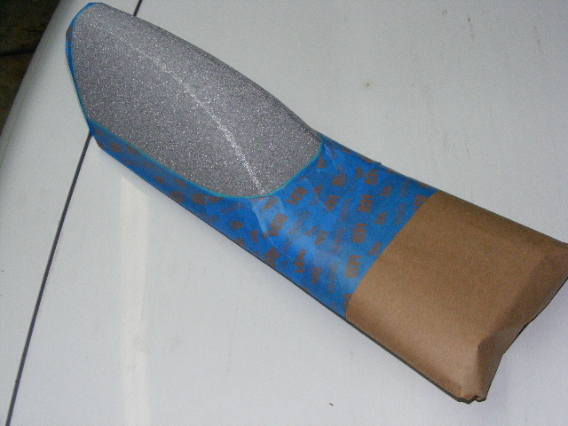

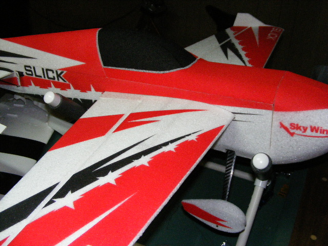

Seeing as I can't fly because of weather, figured I might as well modify it ;)
The Wattaplane red paint scheme is the one with the black canopy and the maple leaf on the tail. I've got the Skywing red paint scheme with the silver canopy. I really preferred the look of the black canopy, so I changed mine. masked it off so the was an 1/8" trim line of silver around the edge and sprayed it black.
