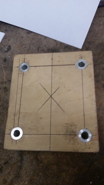

Not my work shop, but been contemplating this for a while now..... Some really crappy, light weight 5/8" thick ply that I got from work, a little bit of aluminum dowel, a lathe and drill bits. This is what I come up with. It is a 1 off, and wont be made for anyone else. I made this one specific for a friend of mine.
I kinda went off in my own direction for this mount, basing it off Terry's idea with dowels. But the crush is what concerned me, with lighter weight plywood. The crush usually happens right in the area of where the bolts mount up to the firewall. I want to totally eliminate that, without having to go with the added expense of a full aluminum mount.
