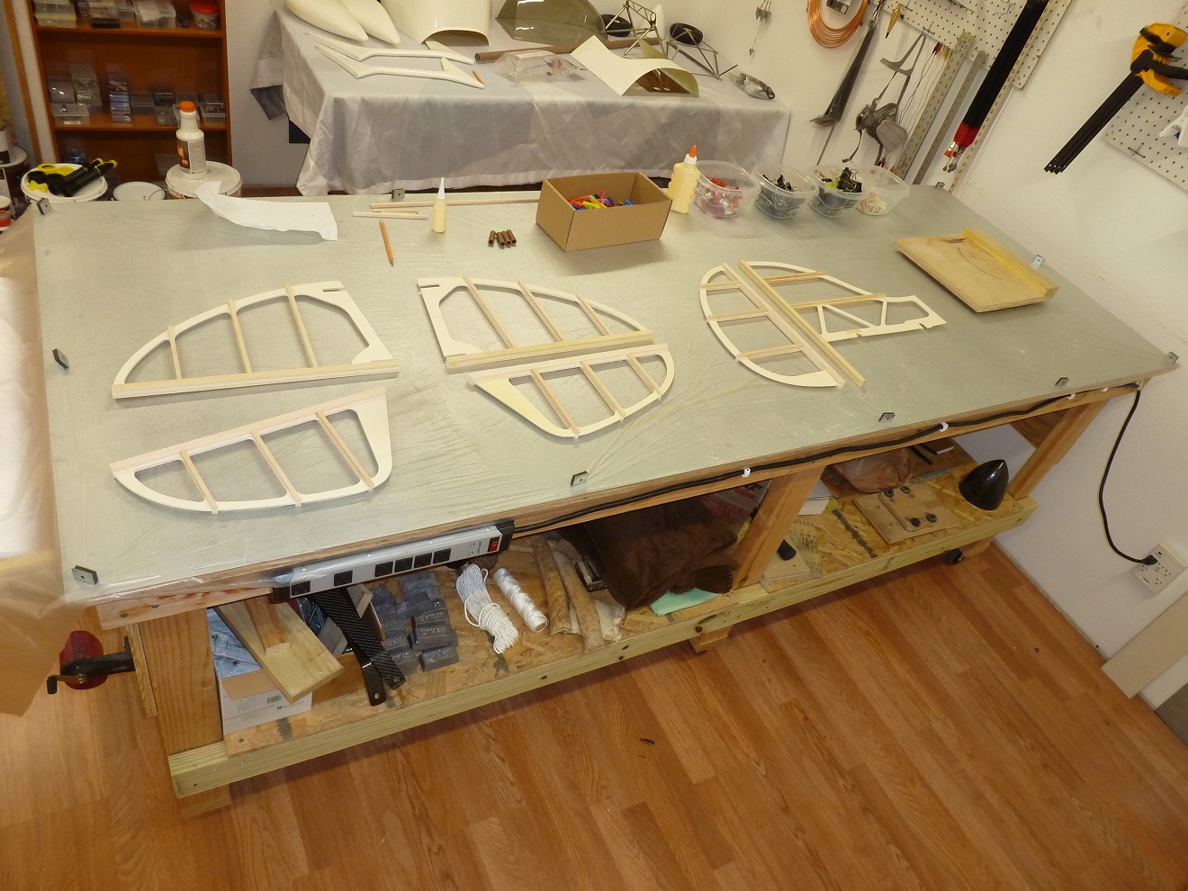

All cut, sanded, squared up, and ready for some perimeter strips.

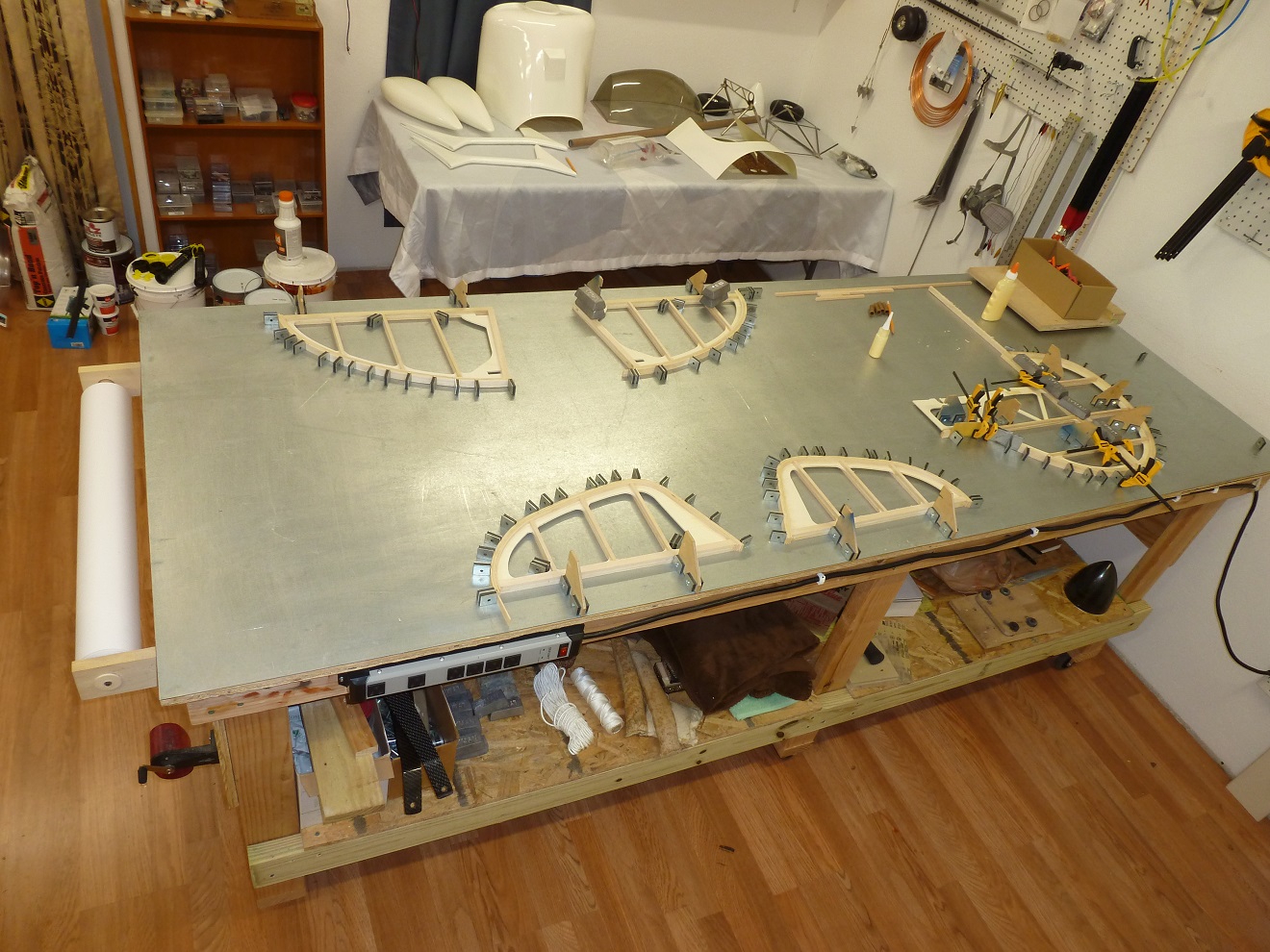

And all the rest are on, see, once that first one was ready for glue the rest just flew by. I'll let it all set for about an hour just to ensure it is dry and install the phenolic tube. Tomorrow, the fuse will hit the table.

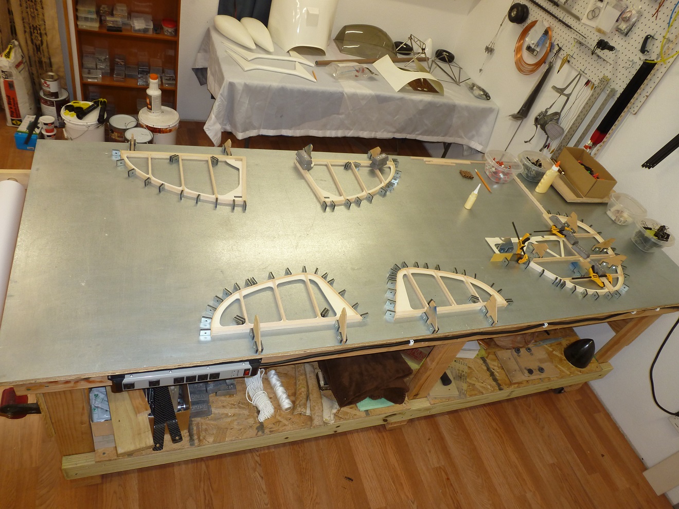

I remember that but this is 9" wide with very little room for substance in the ele's. I'm going to take the lighter servo option, that's the smartest and safest option. I went out to add the few pieces that were going to stay out until joining, being I'm not joining them, and the strips were not adhered. I guess it was the water. I pulled them all off with nothing left behind that is how much it did not glue. So tomorrow I will cut up some new strips and use wood glue, the sure fire adhesive for damp wood or any wood. And just because it aggravated me I tossed the ca, never used it much any way and now it done that to me, good riddens!!!
