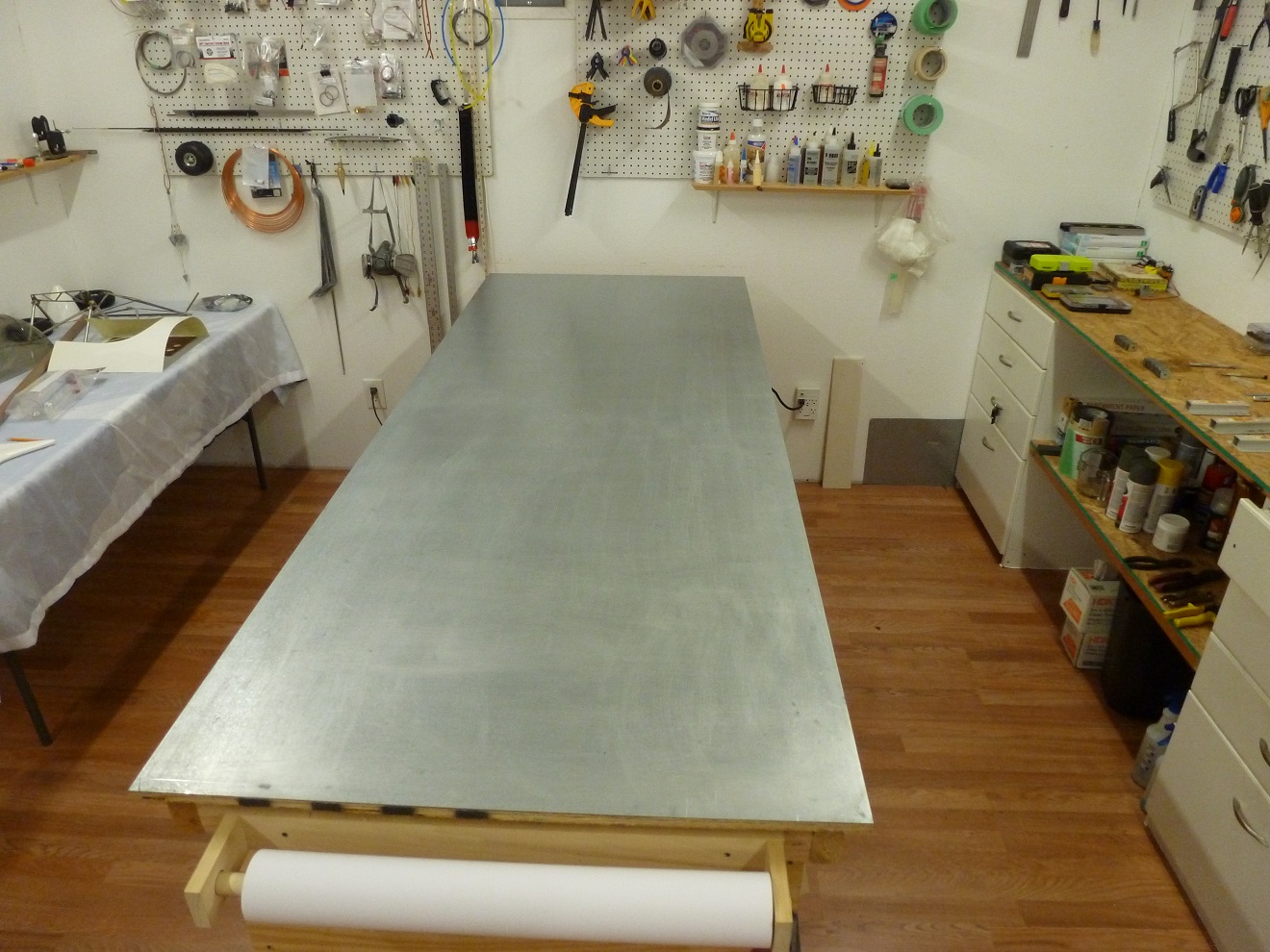

The most important thing to any build regardless of the builders skill is the table and surface. It has to be absolutely plumb, level, straight, whatever word you prefer, and for me clean also. This table has seen a lot since it was last used for building so I not only triple checked for plum but also scraped anything I could feel or see off then ran over it with a sander. It is covered with plastic and ready to go!

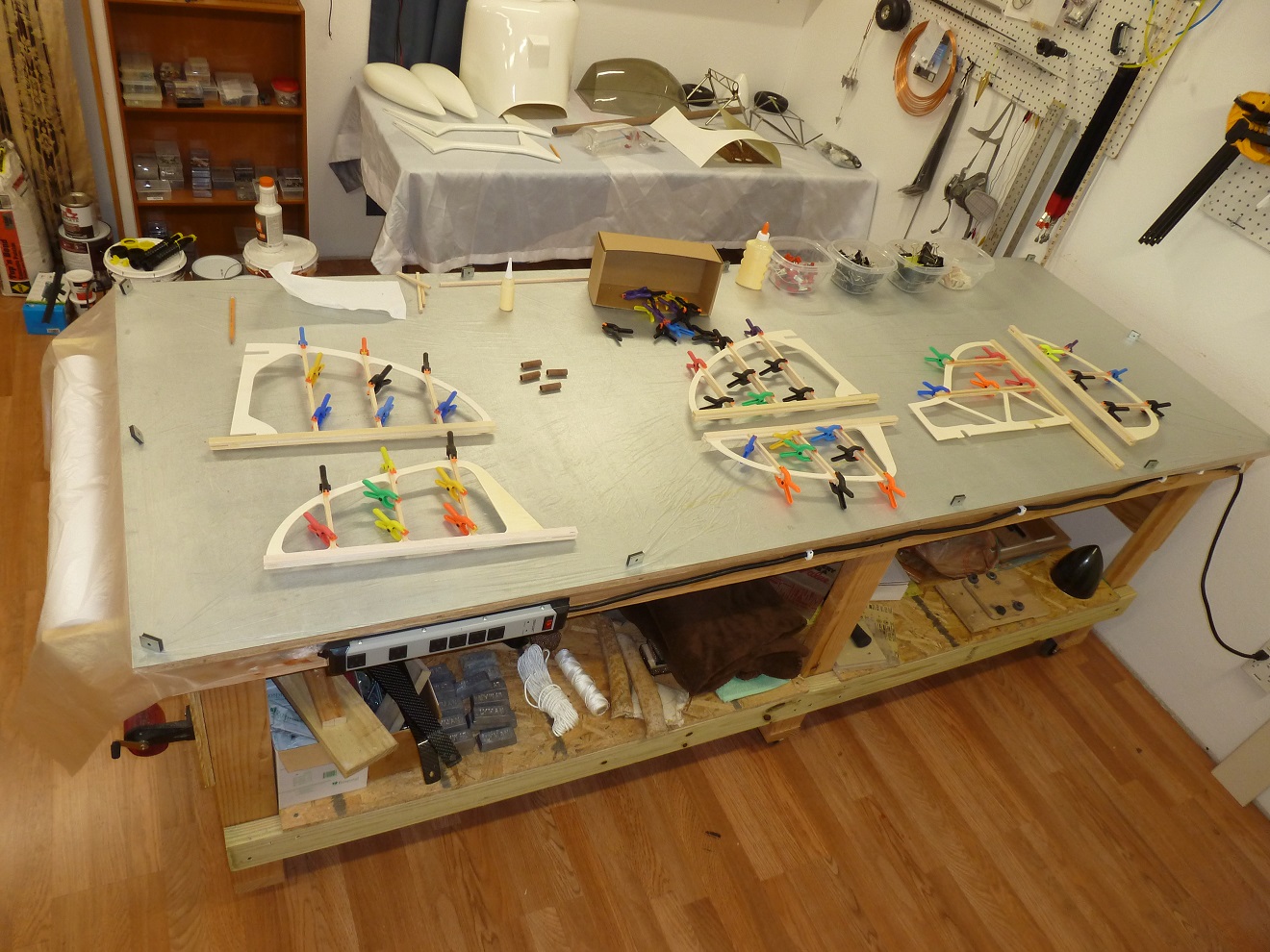

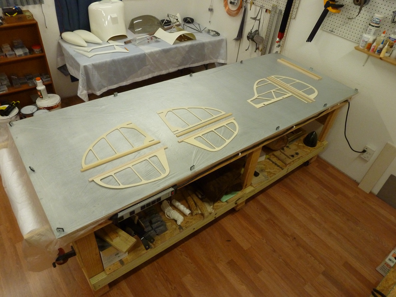

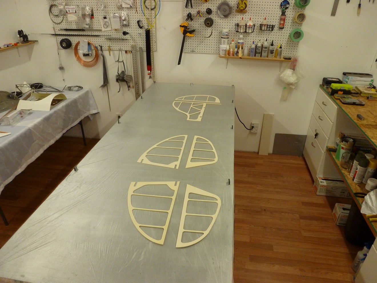

The horizontal is needed for the fuse build so I cut the tail feathers from the tree's and started cutting some wood. Pic 1 is the tail feather ply pieces. Pic 2 is the associated leading and trailing edges cut to length. And pic 3 is them clued on one side, they are built one side at a time.

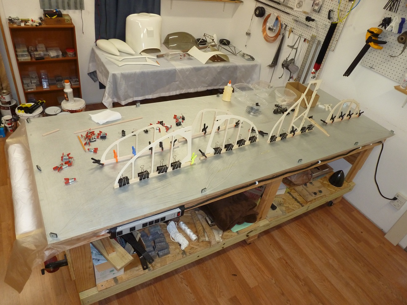

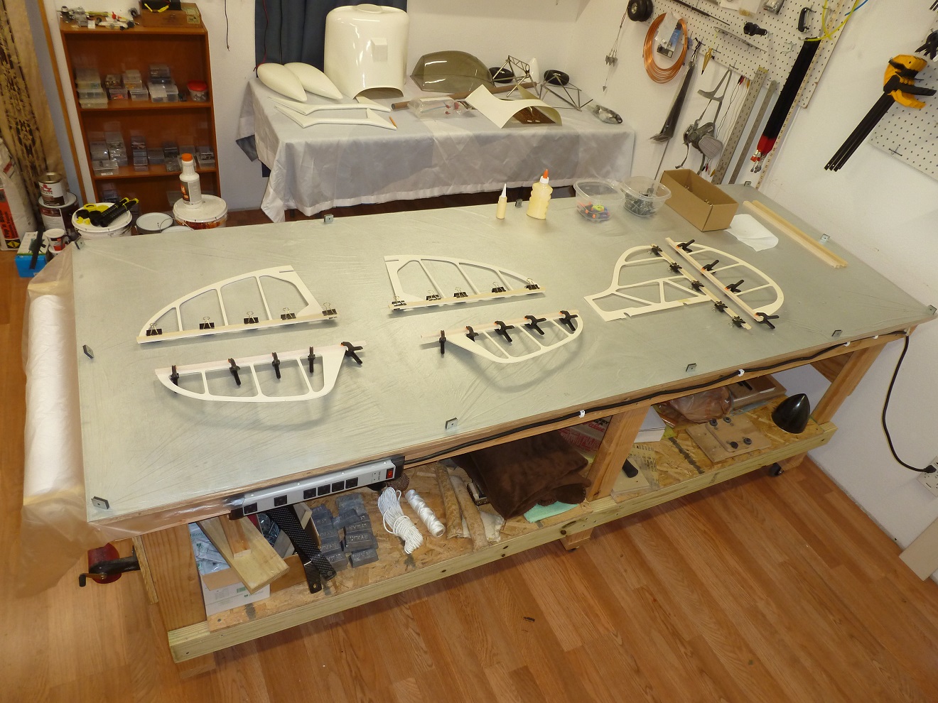

The rest of the balsa rib strips are on and the phenolic tubes cut. The fin did not get balsa strips, because of prior issues with bowing during covering I used pine instead.
