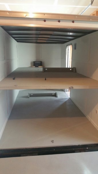

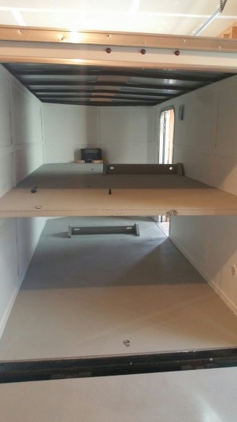

The painting I am "NOT" looking forward to. But it has to be done right? I spent the day arranging and re-arranging and then re-re-arranging but finally have the layout of the planes inside. Between my son and I, we were able to solidify exactly what is going to go where. I need to get the second tier build now and after that, I can get the painting done and a few other things done. It looks like we will be able to get the 50% Bill Hempel Edge in between my 42% Sukhoi and my sons 43% PAU Edge on the floor. Second tier will be my 40% Extra 260, my PAU 300SP, and both my sons and my 30% Pilot Edge 540's. And still leave room for all the necessary field equipment.

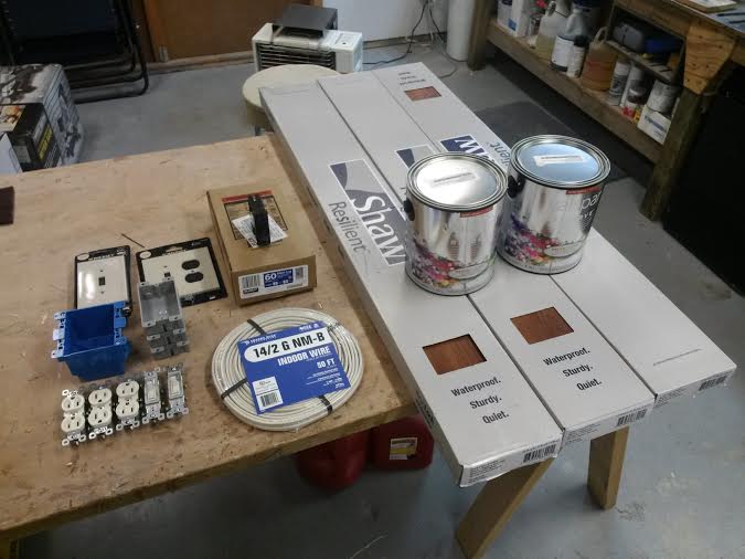

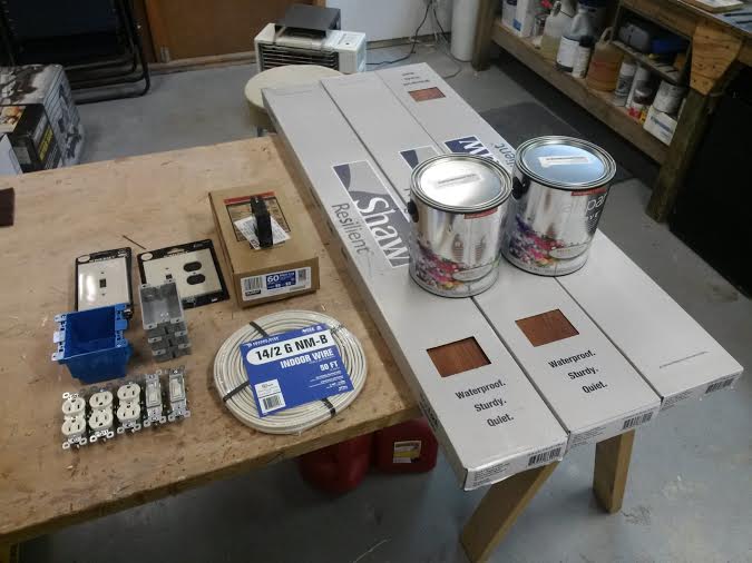

Got the painting done. I am going to get a battery box. And its done.
ok well if that is the case that blue junction box you have will not work for the walls on a trailer.. the walls are just a little over 1.5 inches thick you need the orange light duty shallow box
That's what I thought, but I've looked high and low for the orange ones with no luck so I got this one and figured I'd make my own.. But in the mean time I'll keep looking for the other one.
