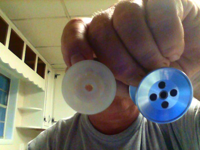

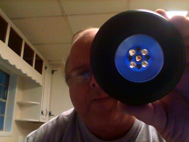

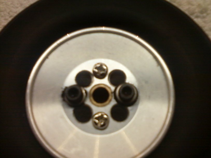

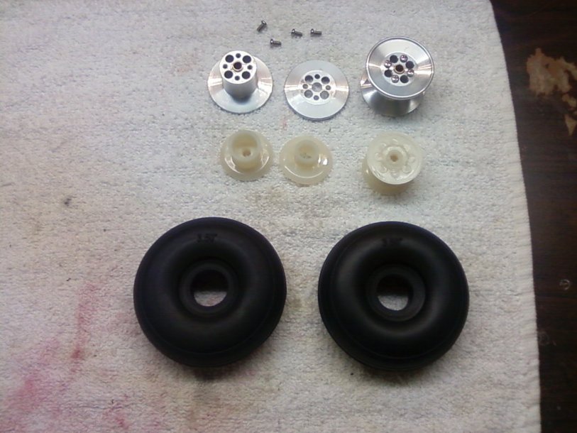

Some minor stuff done.....The wheels that came with this are ok. They call them "PU" and what the hell that means I have not a clue other than PU is what we said, when I was a kid, when the family dog :steamer: in the house. Well IMO they don't stink but the "hubs" are less to be desired. The actual wheel material is the same as Sullivan "Skylight" and the light H-9 wheels.
Just so happens I have some nice CNC wheel hubs I got through Hobby King. The first picture shows two 3mm x 10mm hex head screws used to compress the tire so the first two "supplied" cross point screws can get installed. These hubs also have a very nice bronze bushing that I put a couple of drops of mineral oil on before sliding them on to the axles.
