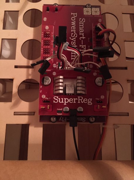

Here are my questions: I use a DX8 for radio, and have a Spektrum AR8000 RX NIB. I thought I knew what I was going to do for RX, Batteries, and aileron servos, but now I'm not sure after reading some stuff.
My plan for aileron servos is to install 4 Hitec HS-7954HS servos. I've always been a Hitec guy.
Question 1: Is the AR8000 adequate for a 100cc plane or should I go with a AR9020 with Dual Satellites as opposed to 1 on the AR8000? On a larger plane does having more satellite receivers have merit? I know the Futaba guys use 2 receivers... so I didn't know if I should sort of duplicate that.
Question 2: I read some horror stories about wrong voltage causing crashes... I was thinking of either going with 2 Life Source LiFe 6.6V 3200mAh 10C or 2 Fromeco Relion 7.4v 5200mah batteries plugged into the EQ6. Also for DA-120 ignition I plan on using a Hydrimax 3200mah 4 cell 4.8V battery Are these good choices?
Question 3: The rudder is pull/pull currently with a single JR 8711HV servo, which the manual says to either use this servo or dual servos equaling 400oz. I am primarily an IMAC guy, but want to prepare for 3D so is this adequate for the rudder or should I install dual pull/pull or even go to dual push/pull (there are servo spaces in the tail for push/pull).
I'm just brand new to these really big planes, and I want to make sure I'm not just doing what's okay, or I can get by with, but what's right. Would love some help!
