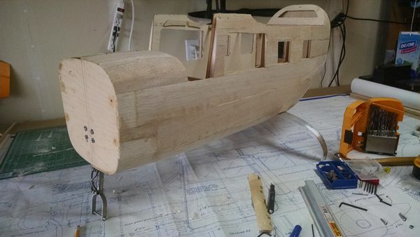

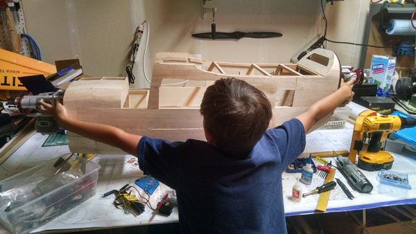

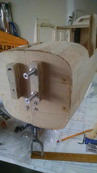

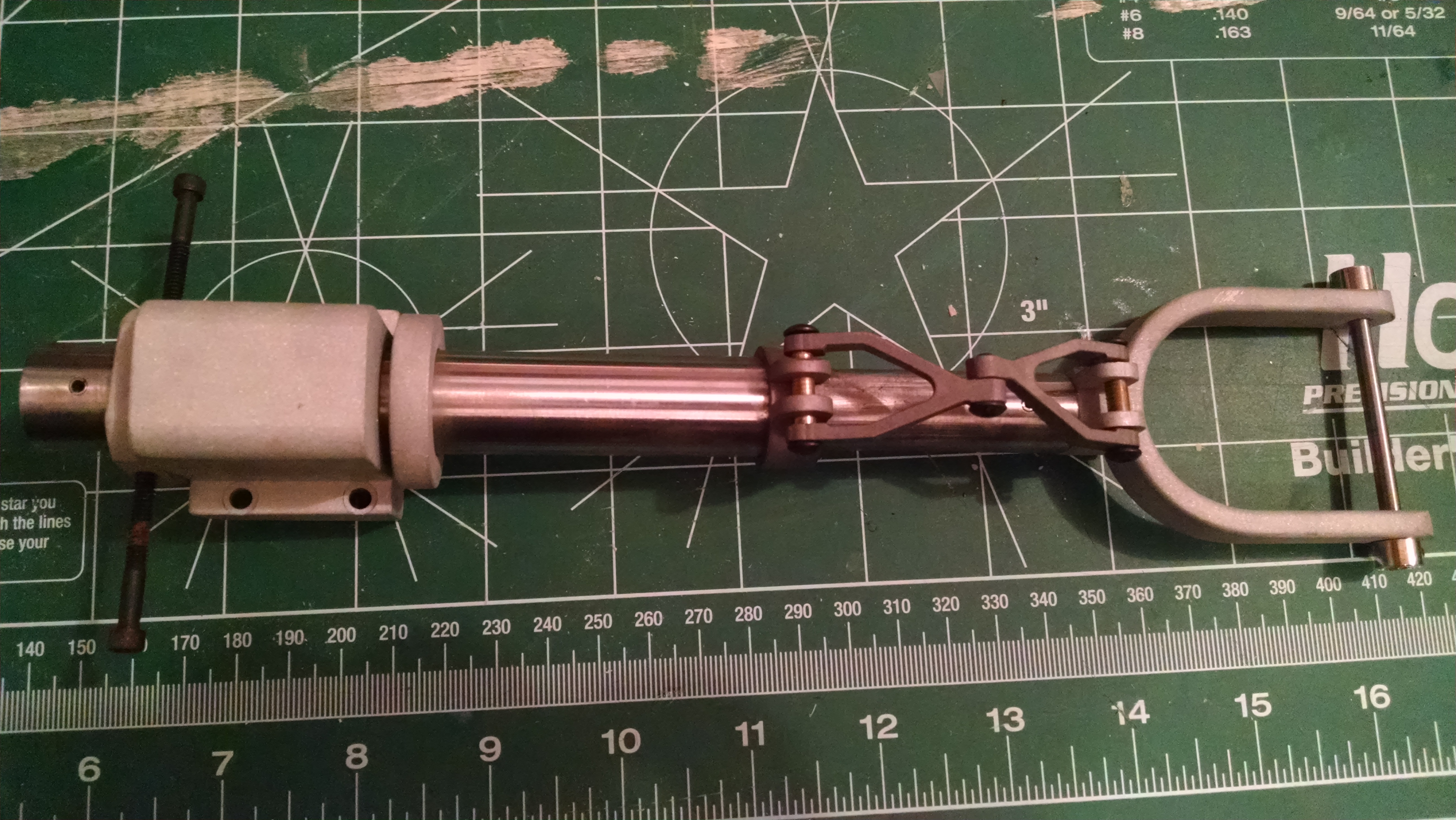

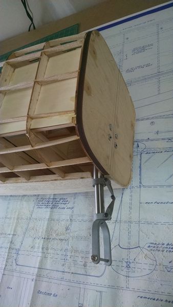

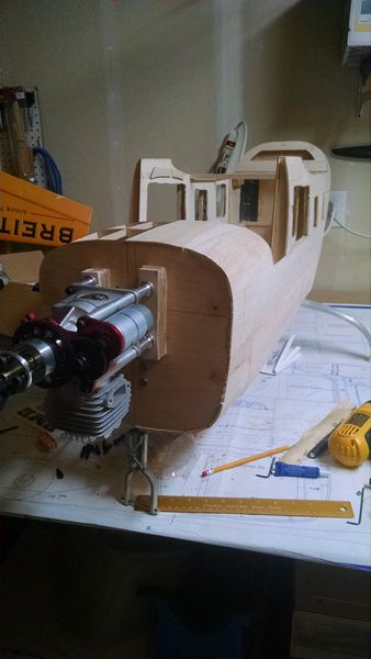

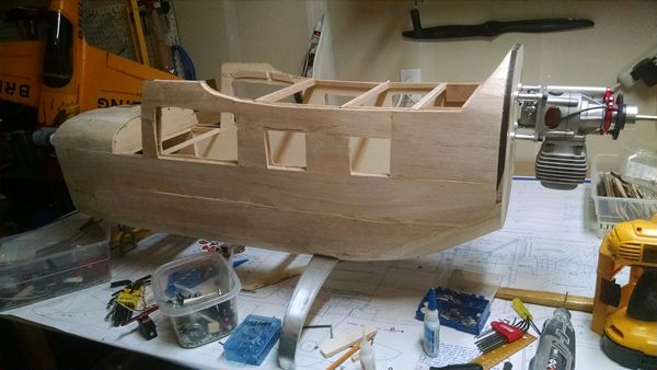

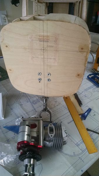

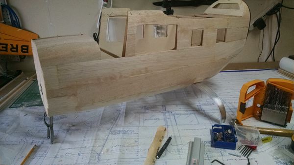

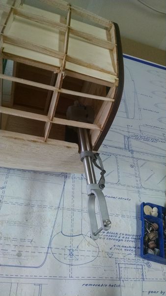

It's been awhile since the weather has been cooperating for flying and it seemed a shame to waste it. Today, I cleaned up the garage/workshop a little bit and decided to try and fit the landing gear and engines to the airplane. I think I'd call it a successful, productive day. It poured down rain outside while I measured, drilled, cut, measured, etc., until I ended up with the nose and main gear attached. At that point, it started to look like an airplane.
Yes, I know the windows are still rough-cut and need to be cleaned up. I'm still debating about whether or not I want to install an opening door or two, or maybe just a window that opens up. I'd prefer to have some access to the inside of the plane while the middle section is installed.
After I installed the nose and main gears, I thought, why not install the engines? Things are getting serious here...
Here are some pics of the engines and landing gear installations.
m_IMG_20151010_204812539.jpgm_IMG_20151010_204747999_HDR.jpgm_IMG_20151010_191650102.jpgm_IMG_20151010_175058680.jpgm_IMG_20151010_180345336.jpgm_IMG_20151010_172427000.jpgm_IMG_20151010_170749327.jpgm_IMG_20151010_170755905.jpgm_IMG_20151010_172420965.jpg
