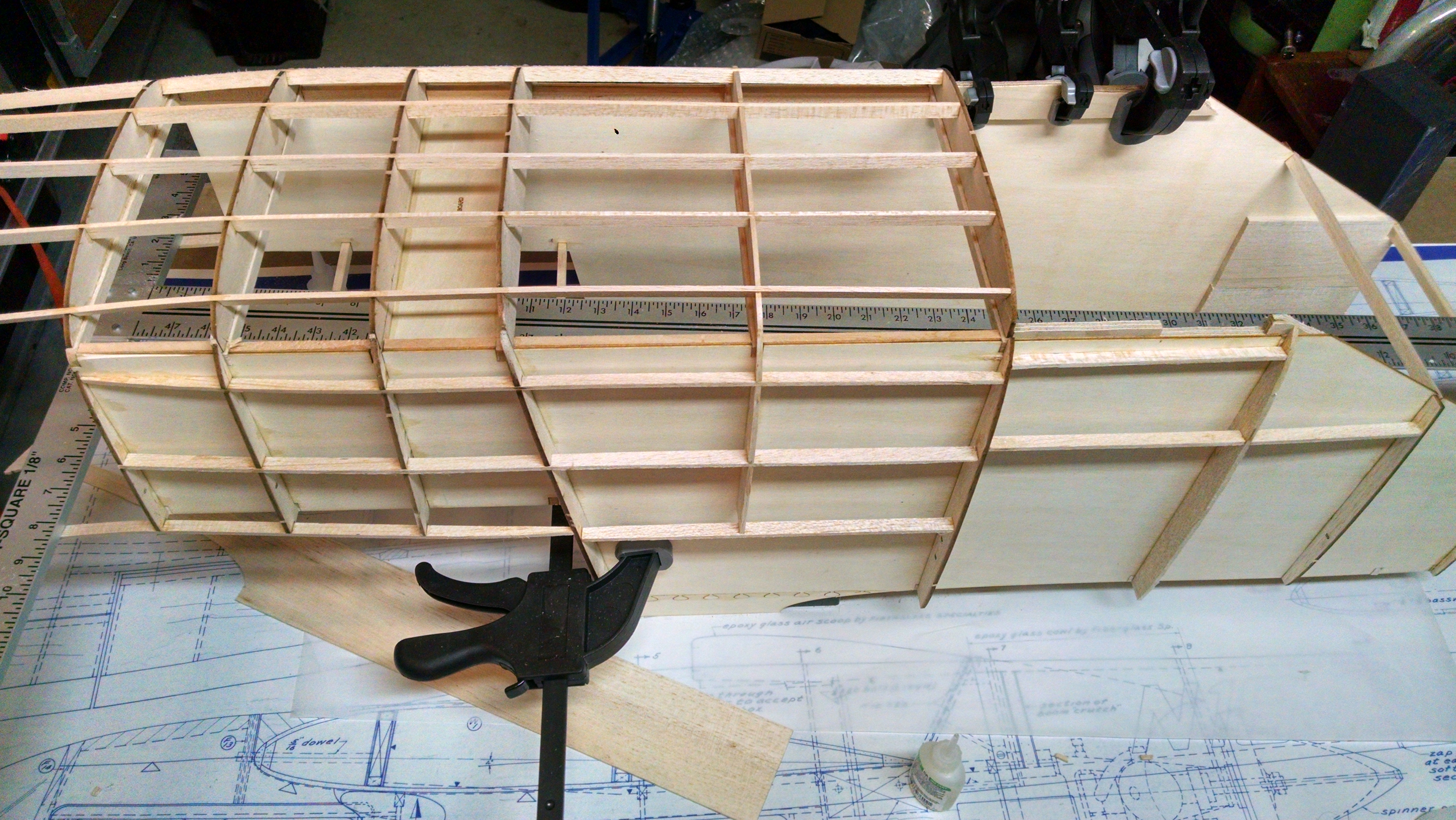

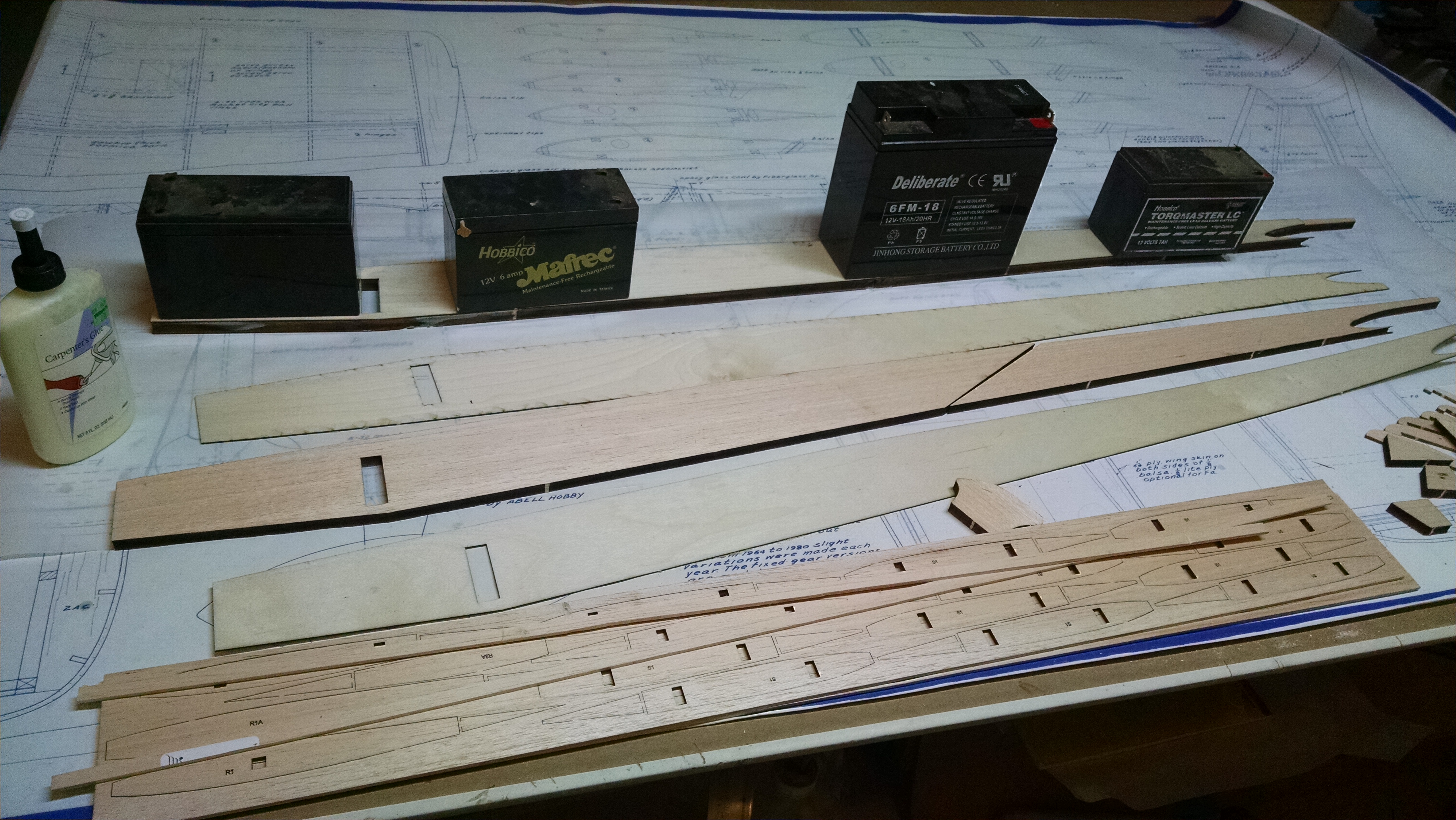

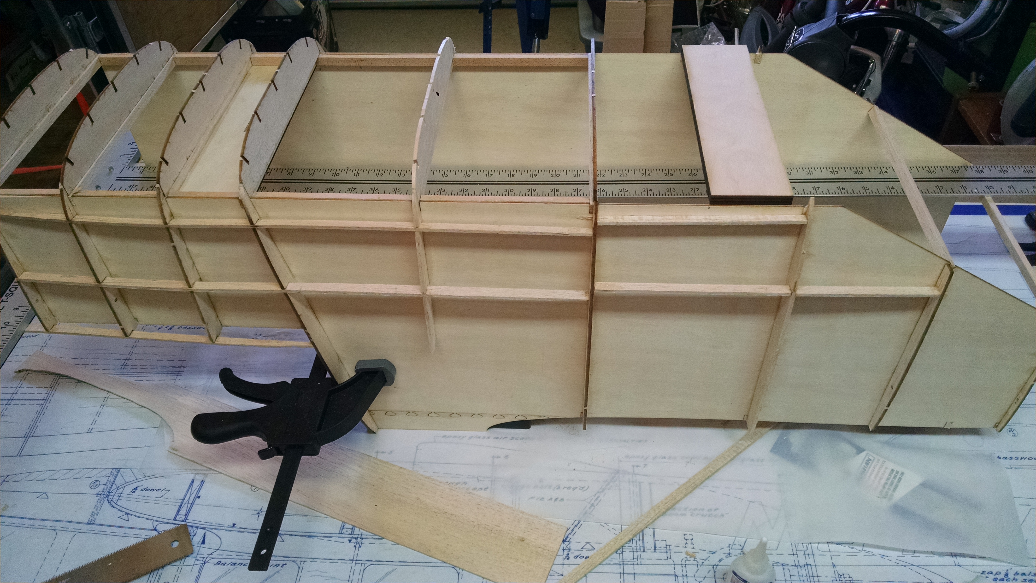

Some pics of the fuselage build so far... (from yesterday) IMG_20150620_123148144.jpgIMG_20150620_204033323_HDR.jpgIMG_20150620_204050598.jpg

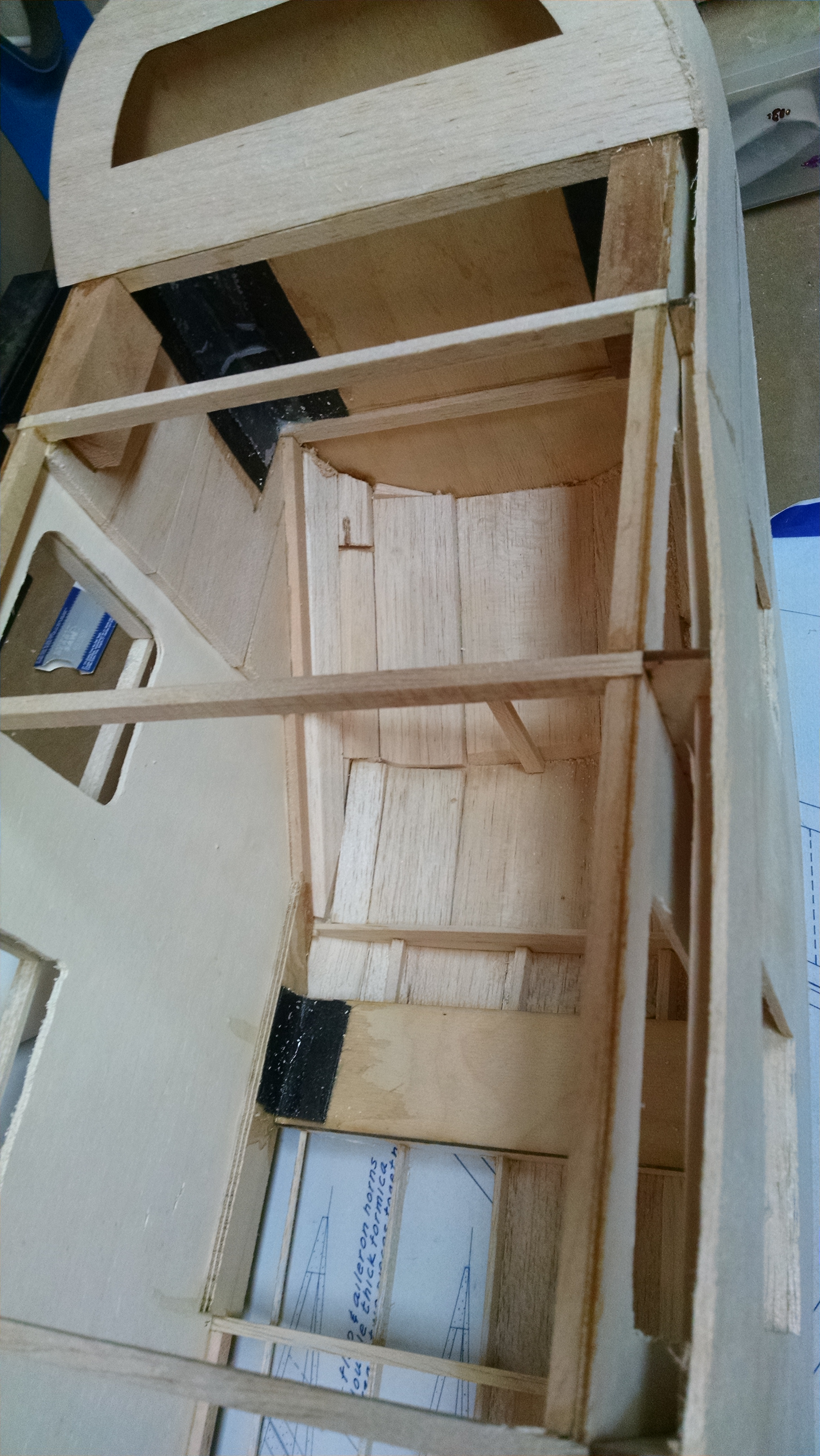

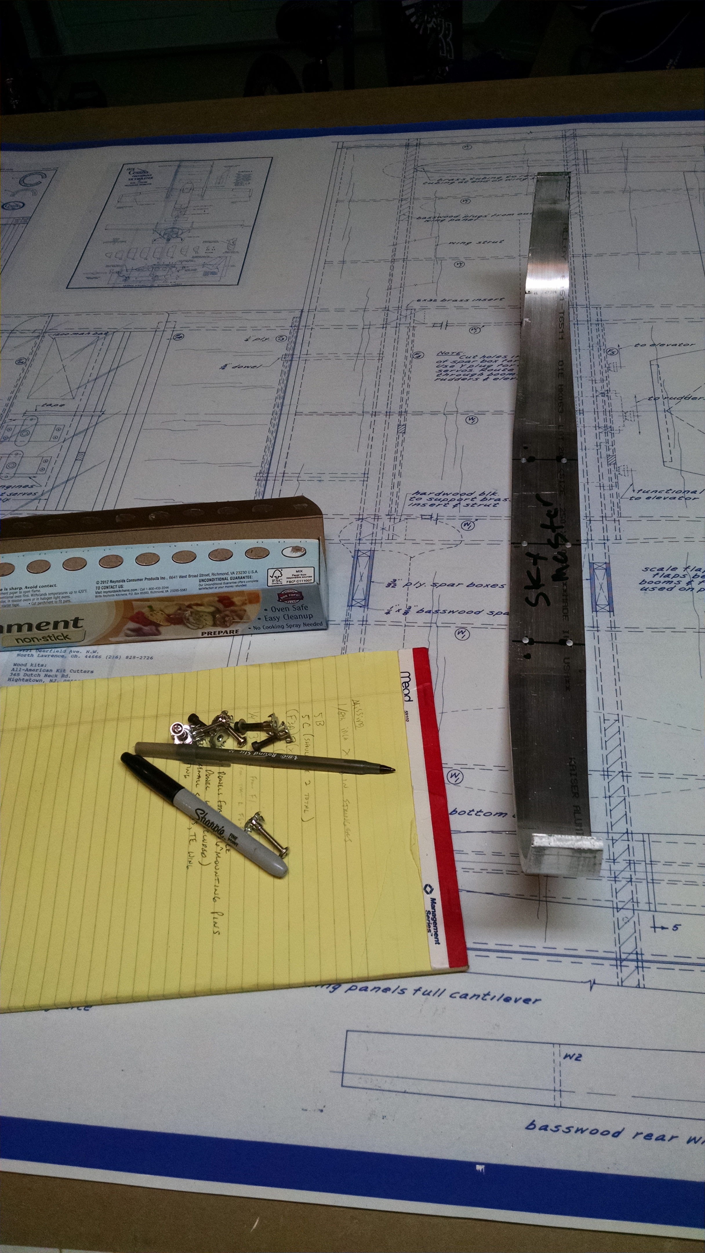

Today's progress included getting some of the stringers re-located to the correct places so the windows will turn out right. I also installed the landing gear block and the home-made ply support pieces. I will also be putting some carbon fiber cloth in that area. Here's what it looked like at the end of today...IMG_20150621_212528198_HDR.jpg

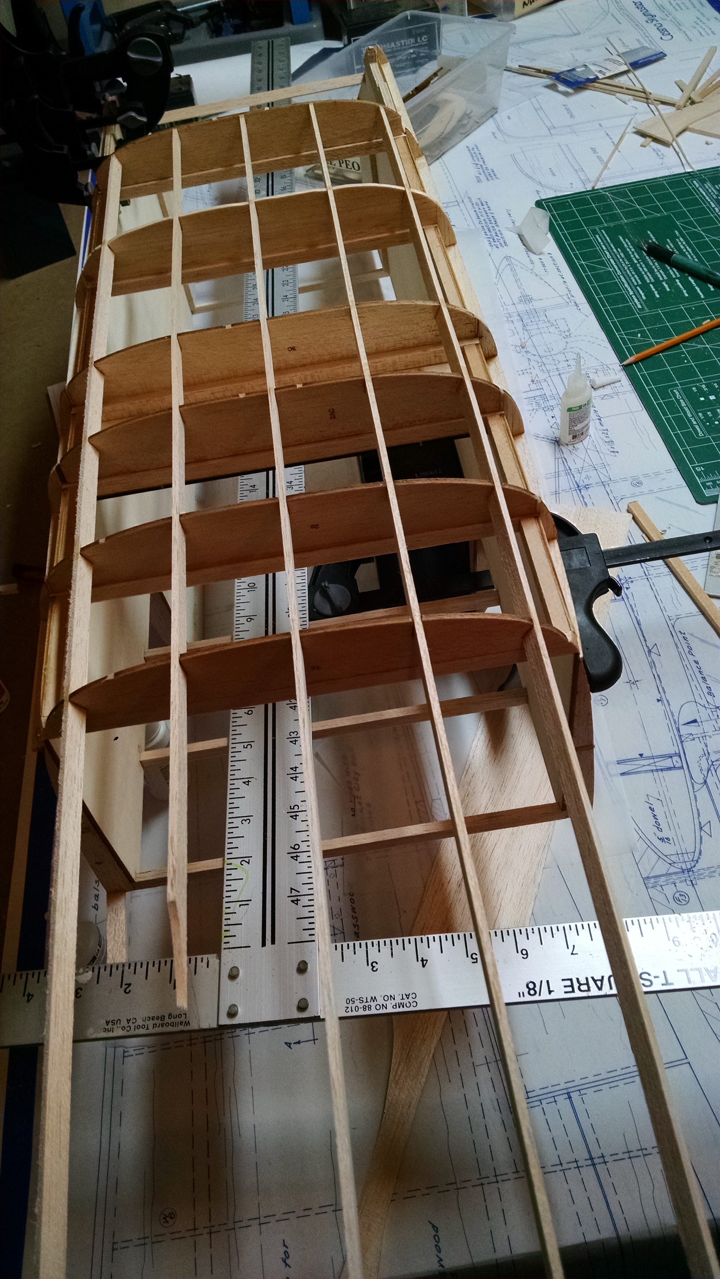

Rear firewall is attached, fuselage stringers are finished on both sides, wing mount blocks installed, and landing gear holes drilled. Hoping to make more progress tonight.*
My list of missing pieces of wood is nearby at all times. Keep having to add to it.

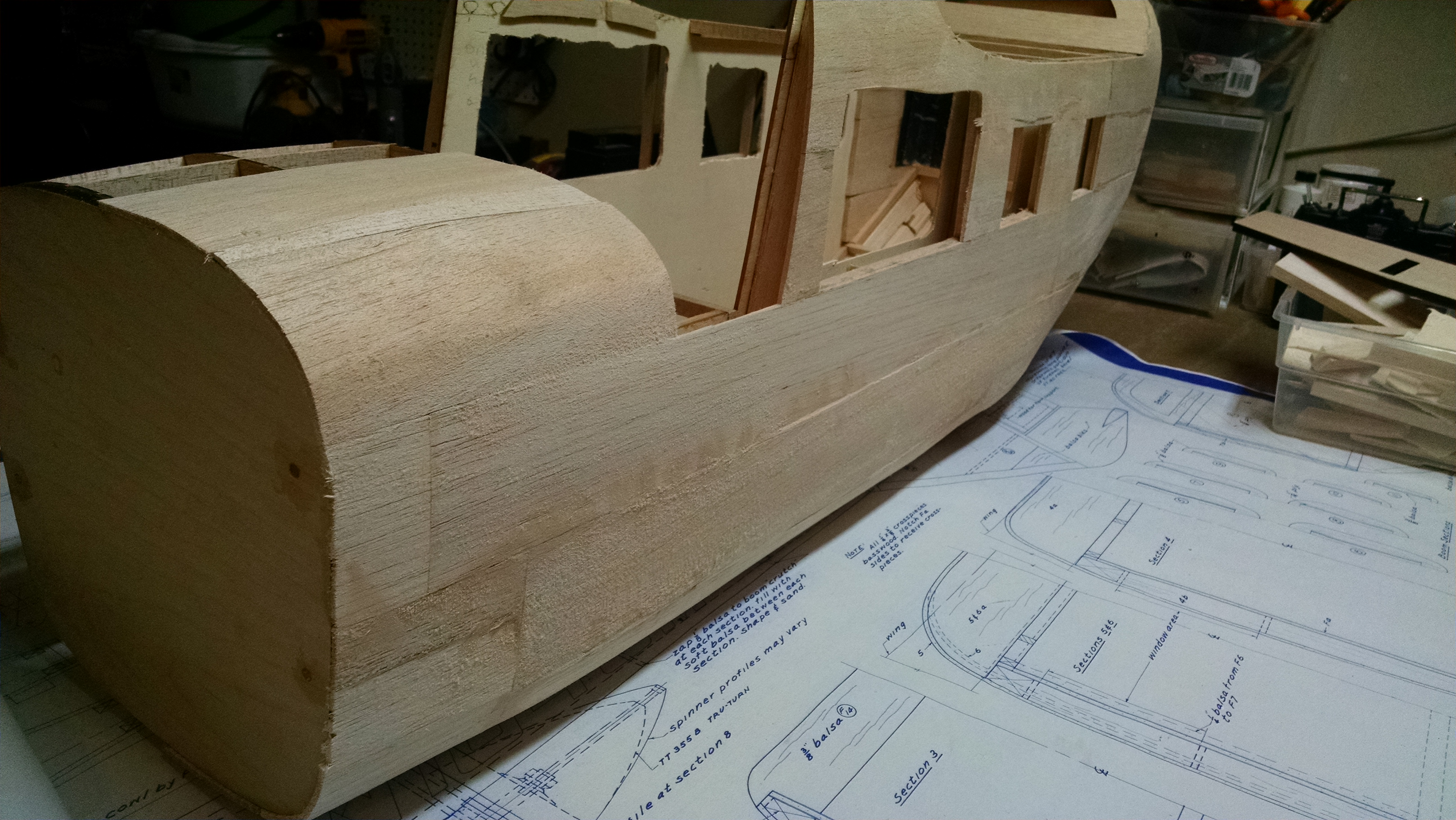

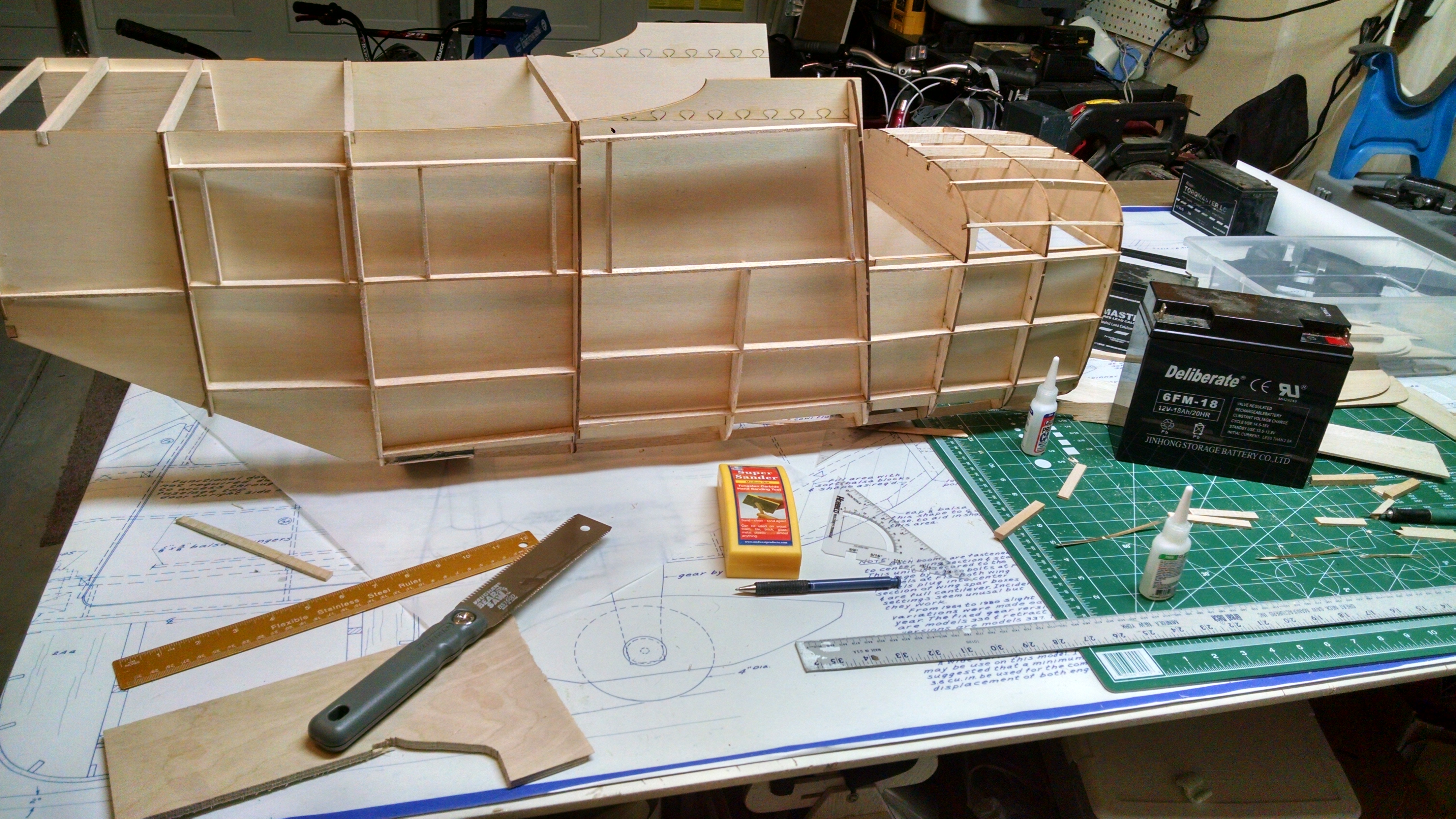

Currently, I'm finishing up shaping and sheeting the bottom of the fuselage between the rear firewall and the LG plate. It's been a bit of a PITA to get it right, but I think I'm just about there.

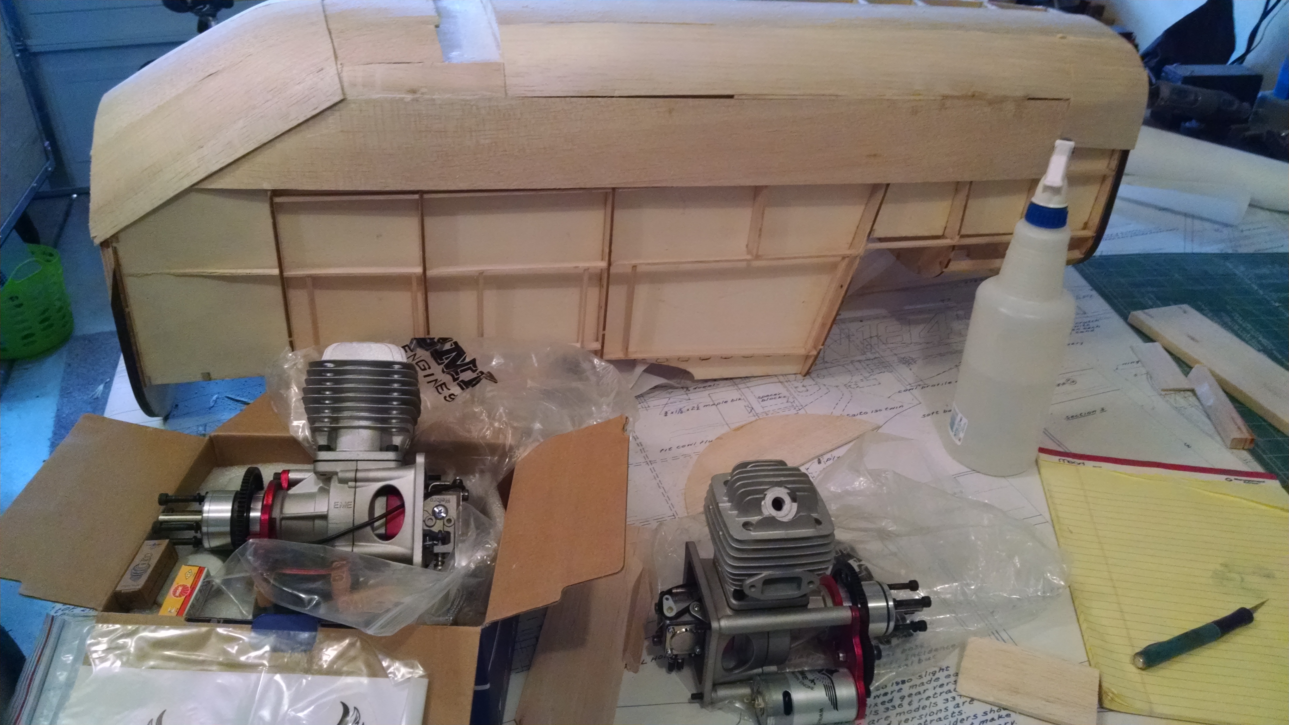

Engines arrived: two EME 55's with electric start!

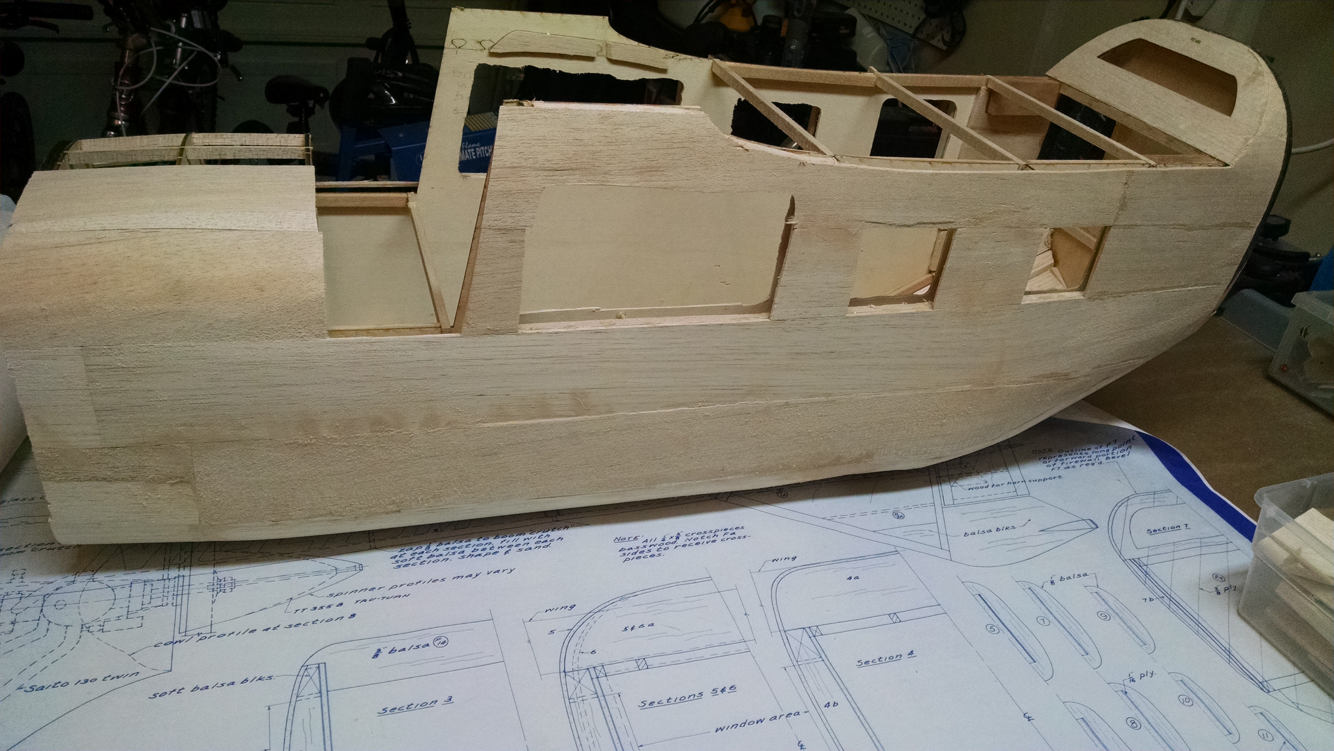

Half the fuse is sheeted and holes have been rough-cut for windows. Carbon fiber cloth on LG and F/W joints.

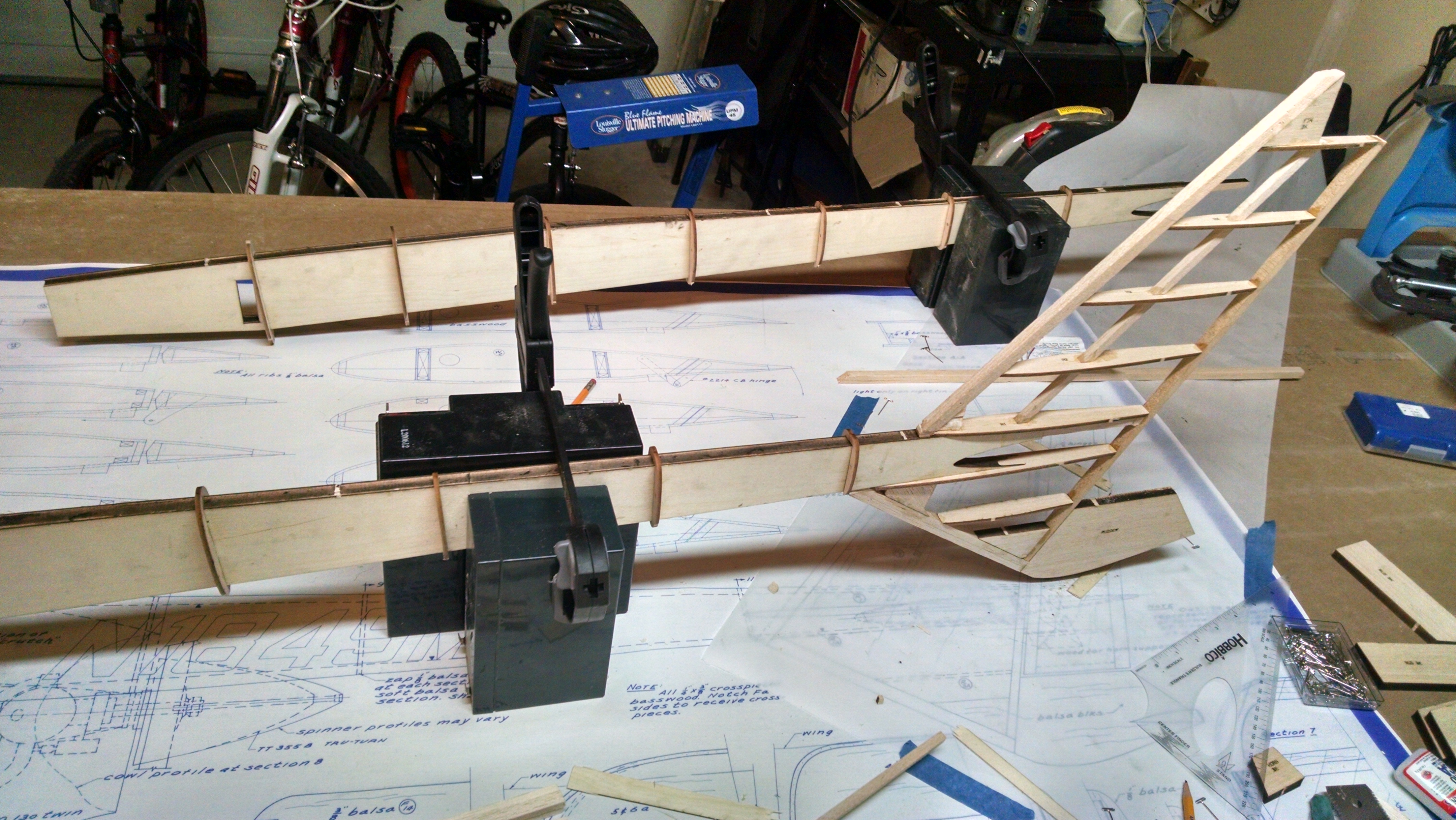

I decided to set the fuselage aside for now since some assembly steps cannot be completed until I have other tasks done. So, I have moved on to the tail booms and fins.
Again, wood missing from kit: 1/4 X 3/8" basswood. Not enough supplied for how much is required for the fuse, fins, stabs and then the wings. I'll be about three short I believe.
I'd send National Balsa another email, but I've concluded they just don't care.uploadfromtaptalk1436721483620.jpguploadfromtaptalk1436721534934.jpguploadfromtaptalk1436721562349.jpguploadfromtaptalk1436721594444.jpguploadfromtaptalk1436721640158.jpg
