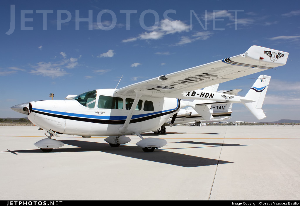

I'm still looking for a source for the nose gear, such as the one in the attached pic. Sierra sells one, but they want $270 for it. Yikes.

So, Century Jet is going to make a set of fixed nose gear for me at a much lower price than Sierra was wanting.
