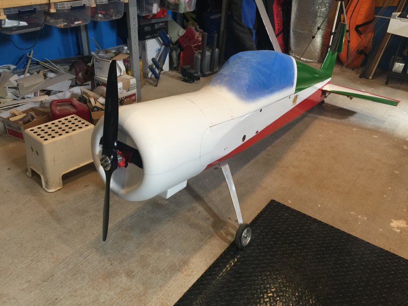

As you can see in the picture I am ready to start painting this Delts aeroplane. 1600 square inch. Will have a YS in it. But weighting to see how you do it and then see if I can get the product you use and try it. Hope you feel the big responsibility you have on the outcome of the plane "JUST KIDDING " would you please explane this 1K or 2K that you keep referring to. Thanks a lot for taking the time to help us with being able to understand painting better.

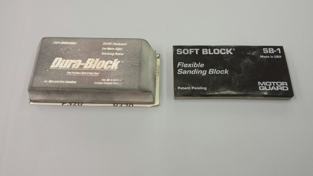

Here are some of the blocks I use. Other than these I have several oak scraps that have sandpaper stuck on them that I use constantly. The block on the left is from Dura Block. They make nice stuff and have a ton of shapes and sizes. The other is a soft curvable block for rounded areas.
