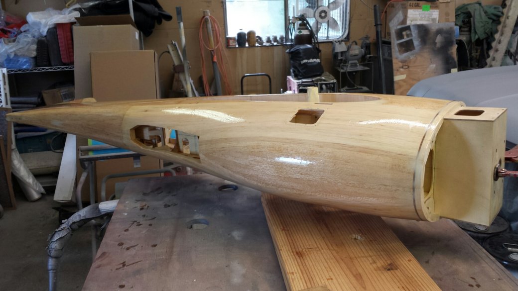

Second coat of Z-Poxy Finishing resin applied today on the fuselage. I weighed all the resin as I mixed it, then weighed what was left in each cup and the total weight of the resin applied was 28 grams or 0.98 ounces. A lot of that will get sanded off.
The second coat comes out pretty shinny no matter how much you squeegee off.

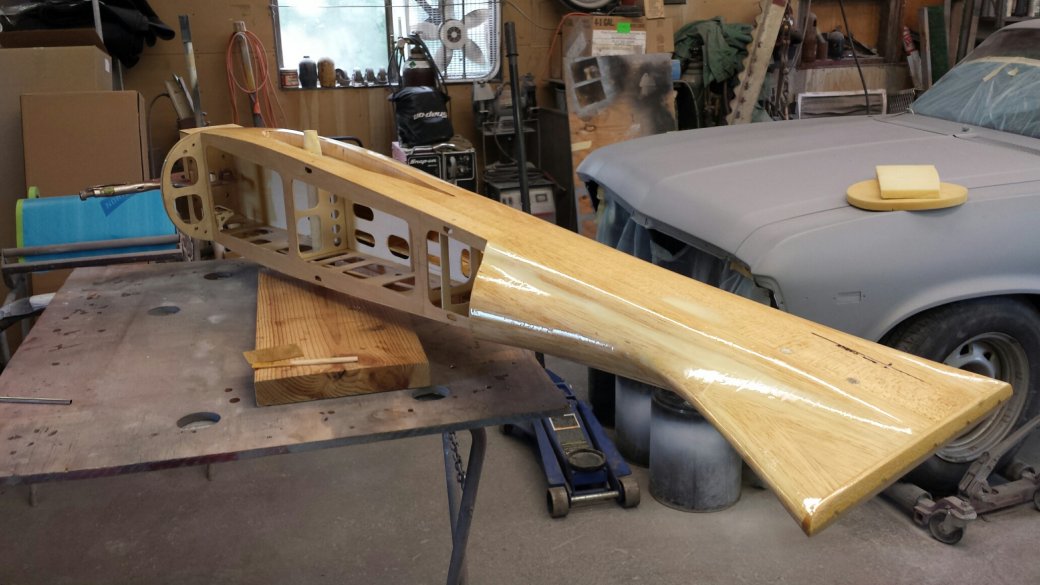

I finished sanding the second coat of resin on the fuselage last night and weighed it again.
Before glass 62.37 ounces
After sanding 1st coat of resin 65.65 ounces
After second coat of resin 66.55 ounces
After sanding 2nd coat of resin 65.92 ounces
So the weight gain from the .5 ounce glass cloth and two coats of resin after sanding was 3.55 ounces.
When I first started making and weighing test panels a few months ago I thought the tiny weight gain for the second coat of resin was a fluke on the small panels. Obviously it's not if the fuselage only gained 0.27 ounces with the second coat after sanding.

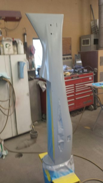

I'm going to primer the fuselage this weekend if I can.

Too late, I primed the fuse today.
