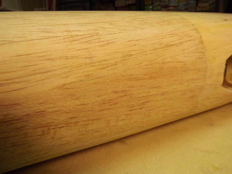

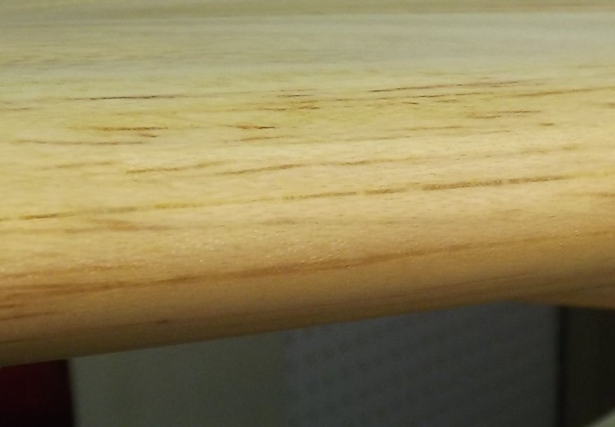

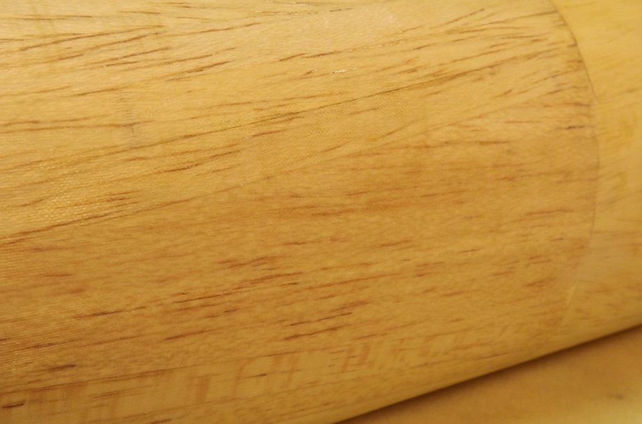

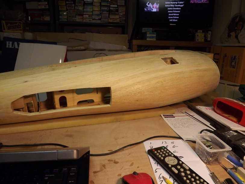

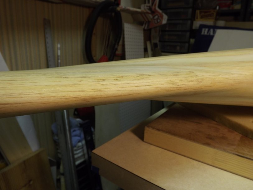

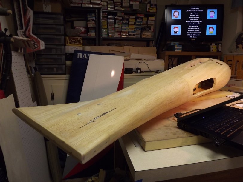

I finished sanding the first coat of resin. I'm going to try and put the second coat on this weekend.
Here are a few pictures. I tried to take some close ups of the areas where the cloth overlapped

I also meant to add that I weighed the fuse after sanding.
Before glass 62.37 ounces
After sanding 1st coat of resin 65.65 ounces
So the weight gain from the .5 ounce glass cloth and first coat of resin after sanding was 3.28 ounces.
