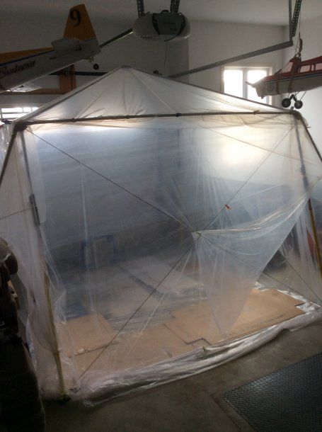

Ok boys got the paint both built again and will start to paint later to hope to get the primer done the plane has been finished and glassed the same as Jetpainter has described in this forum. See attached picture

It's a old sun shade with new legs to get it about 10 ft up to work in. If you look carefull you can just see a square box on the back it is variable speed fan with a 4 stage filter. Need the variable seed not to,suck the paint booth down. Open the garage door just to clears the fan and you are ready. It is just over 10 ft square. Plastic drop cloth all around and on the floor.
Is the fan protected against vapors? Of course that only matters if your paint fumes are flammable.

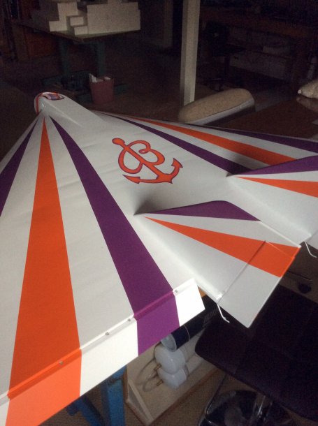

Well boys it is painted and done it needs to dry for a couple of days. Then it will be time to complete the build and and get it in the air. One thing I did learn on this paint job is. The plane was built and sheeted with 1/16 sheeting very light contest balsa over a framework. It was flat and sanded with a long flat sanding bar before it was painted. . As you can see it is not sturdy enough to hold shape never had this before. Trying to save weight but you learn something when try to do things differently. From now it will be 3/32 and will use medium weight balsa.
