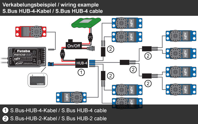

Thanks Doug, if you see him please ask where he plugged it in? I am hoping I can use the sbus on the bottom of the receiver.
dougb

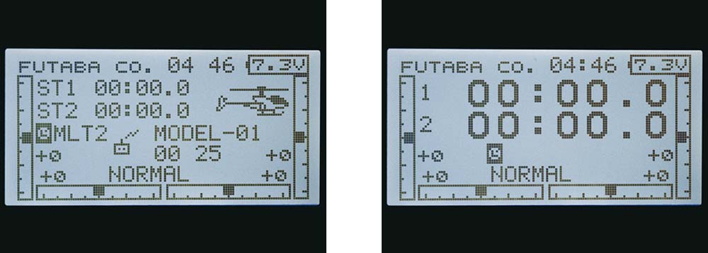

---Cons---
- The display is less cluttered on the 9503 (larger screen).
On the 8FG just tap the RTN button after it powers up and you can toggle to a less cluttered display that also greatly increases the timer numbers size for easy viewing.
