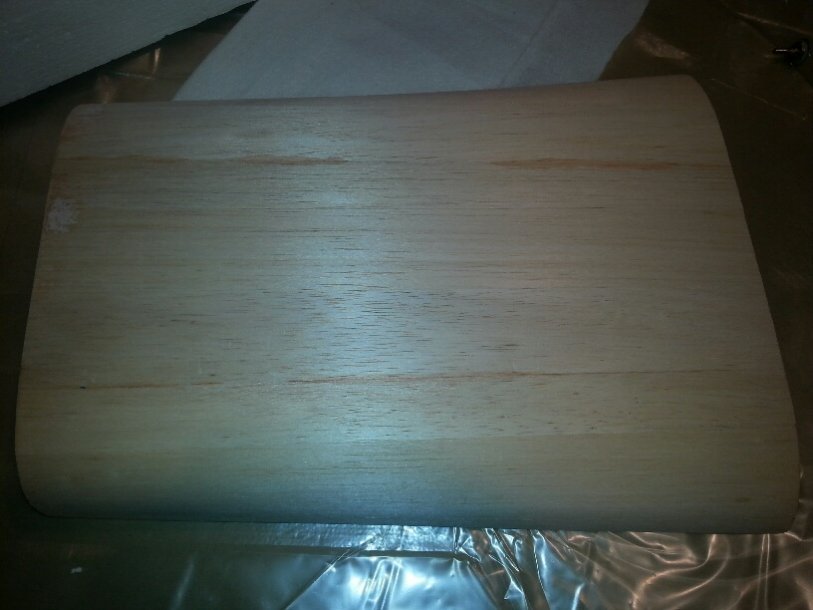

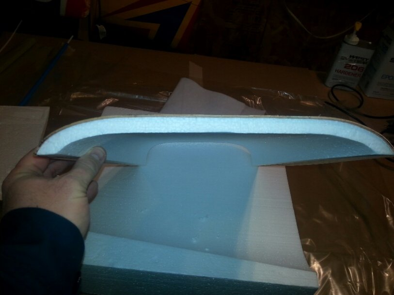

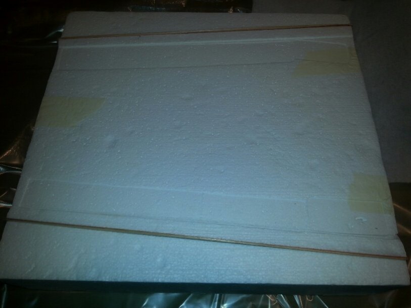

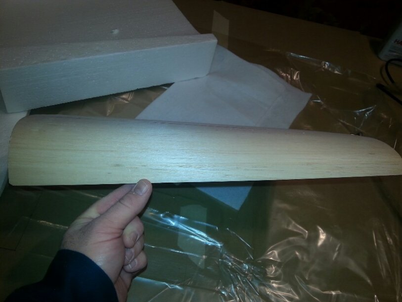

I went out before work this morning and pulled the hatch out of the shucks. I put them in the bag yesterday right around noon so they had been in the bag for 17 hours. You can see the indentation in picture where the plywood strips were on the shuck, the vacuum is a whole lot better than using weights. The hatch looks great and you can see some resin coming out of the seams on the sheeting. I did have some epoxy on the finished side of the hatch that must have been on my thumb and didn't know it when I put it in the Shucks. It definitely pulled some of the foam out of the shuck. I hit it with a sander real quick and knocked some of it off, you can see some if it towards the edge of the hatch in my pictures. I will change gloves next time in between rolling on the resin and putting the balsa sheets in the shucks.

Very nice! You will find that the resin sands easily just remember to resist the urge to sand the parts all the wat to the edge until they are in place or installed. It's easy to change the profile or get the sheeting too thin on the edges until that parts are in place.

Thanks for letting me know that, I would have sanded them flush, but that makes since what you said.

Looks great Carl. Soothing about vacuum bagged parts is the even feel different to the touch over weighted parts. Like Terry said only sand the surface that needs to mate to another surface and do all the profile surface sanding last. Kind of a dumb rule of mine but don't sand areas until close to covering that could get hanger rash.
