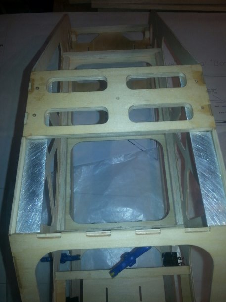

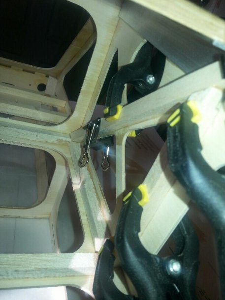

I got just a little bit of time to work on it tonight. Today is my youngest daughters 16th birthday so that takes priority tonight. I did get the landing gear plate mounted and the aluminum supports epoxied in place. I will post some pictures this weekend.
Bipenut
The landing gear mount is in and the aluminum has been epoxied. I have some of the tri stock around the firewall in and have started fitting balsa to help stiffen the landing gears area. Lillie slow on this part of the build because of using epoxy.

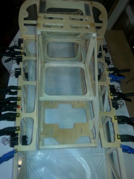

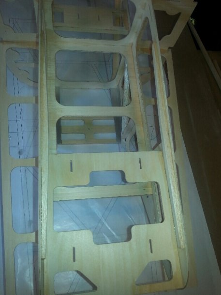

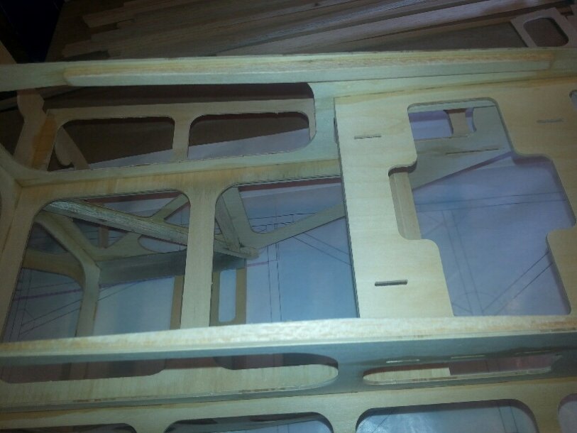

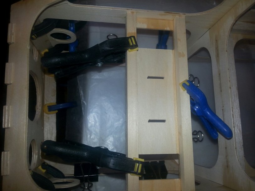

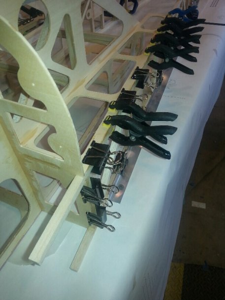

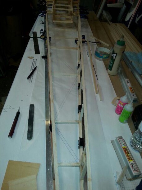

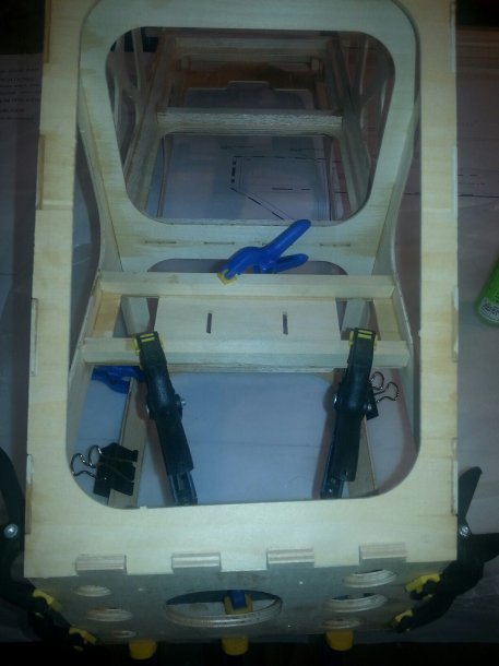

Bipenut
This morning I got the extra bracing put in going up to the landing gear mount.
The balsa bones have been shaped and glued inside the sides of the motor box above the fuel tank floor.

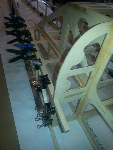

I squared up the F2's and the TG1's and glued them to the side of the motor box. Once that was done I then screwed the aluminum angle back down and got everything squared up the the motor box. I glued the sides of the fuse to the TG1's and F2's. I decided to use Titebond instead of CA for this and you also need to use a lot of clamps when doing this.

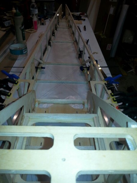

Didn't get much time to work on the plane, we had our club Christmas party today which was a very good time. I started putting in the verticals for the top. I will try and get some more done tomorrow after work.
