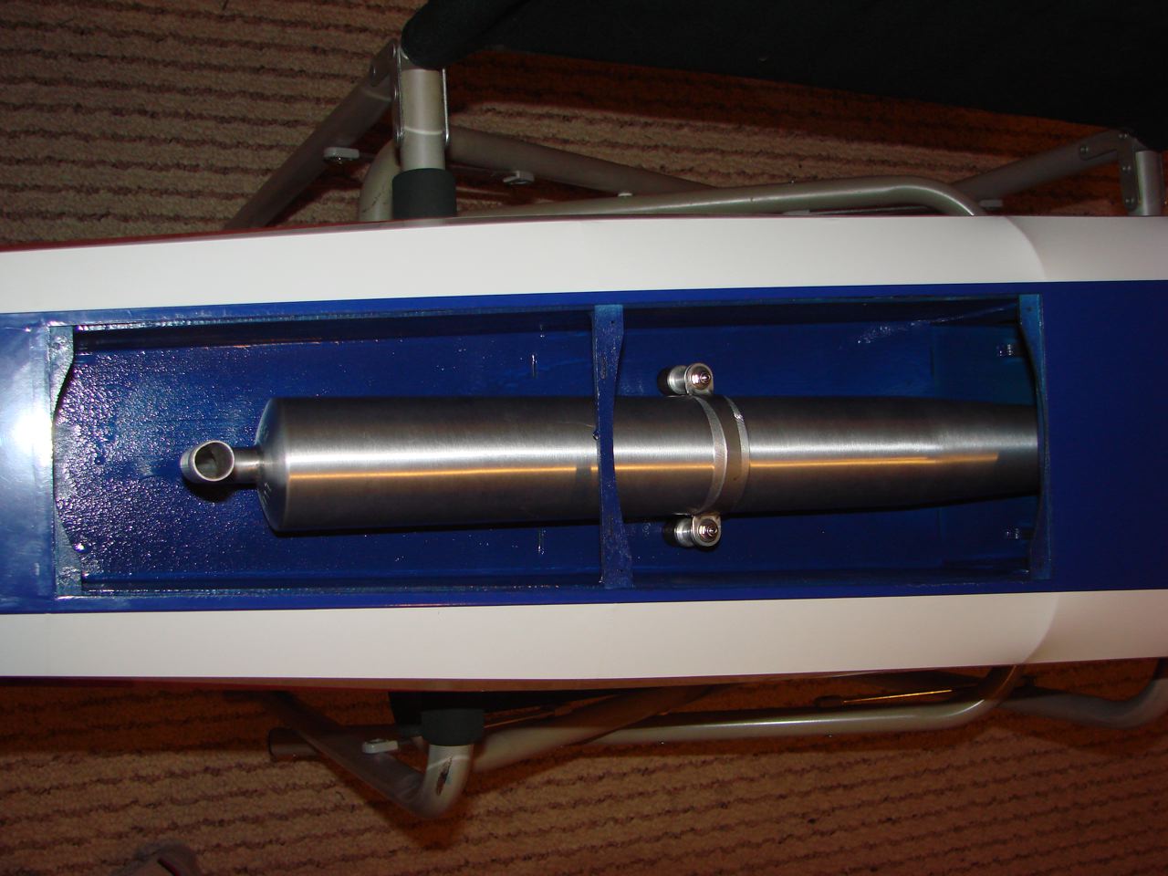

Does anyone have a picture of a tuned pipe installed in this plane? I should be getting one here soon, just wana see how most people would go about mounting it.

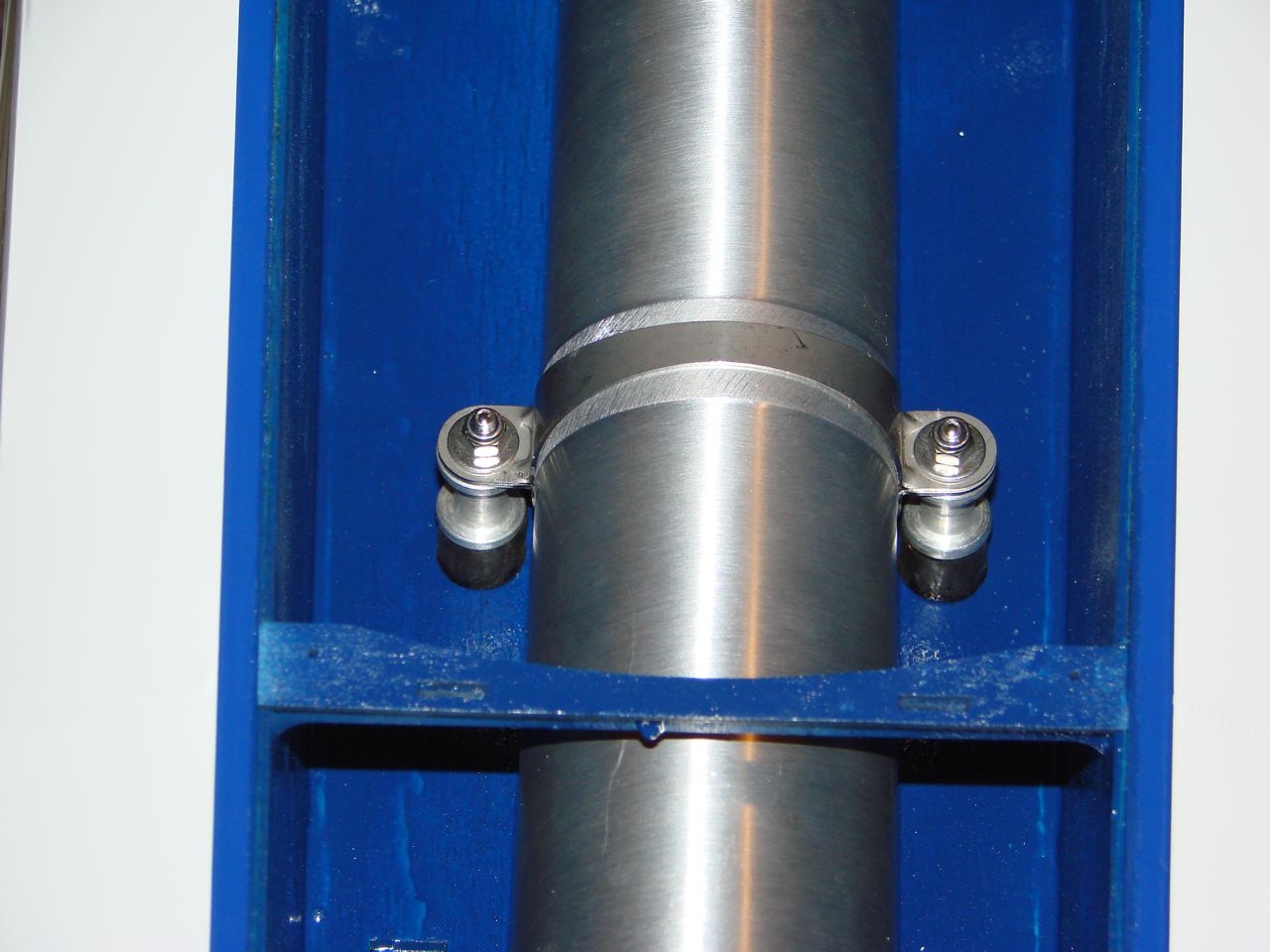

For some reason I can't find any pics of the tuned pipe installation on my Edge. (I sold the airplane right before getting the 91" Extra.)
Here is a pic of the pipe mounting system that I used on the 91" Extra. The pipe mounts exactly the same in both airplanes, but I used a standard laser-cut mount in the Edge instead of the KS comfort mount. It's a simple installation, but I would recommend running a solid header over a flex header.
