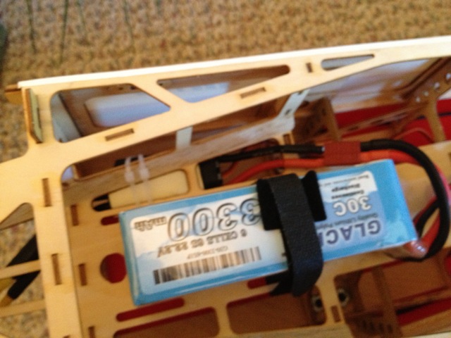

Okay I took a stab at mounting the ESC under the battery tray on the right side so basically the ESC lead comes up in the same spot. I think I like this better as the battery has air passage on all side now (but the bottom) and same with the ESC.
One mor inch of ESC battery wire would have been great.
