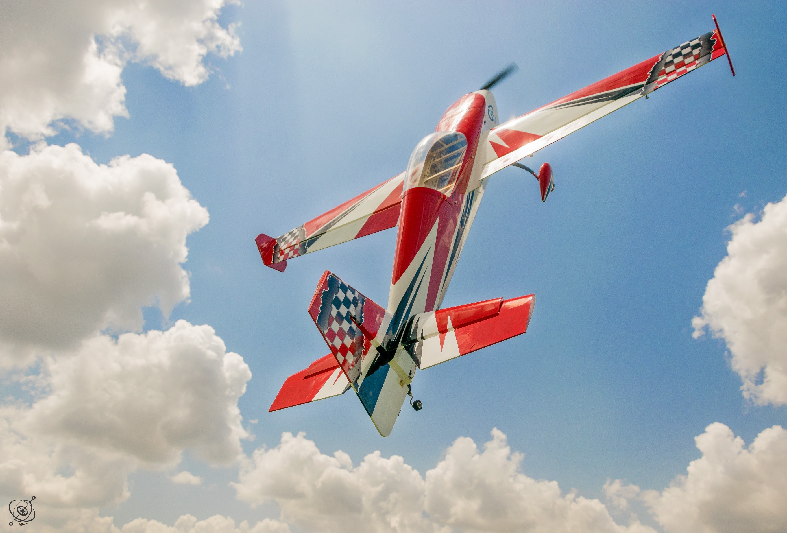

I Got this shot of my 104 yesterday while at the field. I handed the sticks over to [MENTION=413]Brian Yak Dude[/MENTION] for a thumb rest, and picked up my camera for a minute.
This was shot when he was hovering, and right as he punched out, I got underneath and shot upward.
