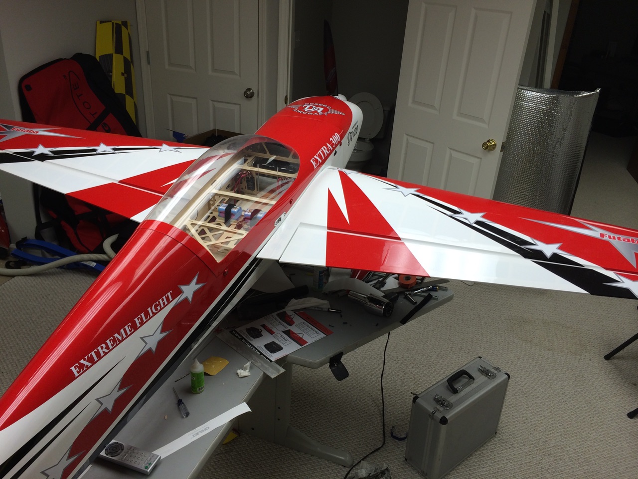

There it is.. bad thing is I gotta watch it sit for a while.. have 2 other builds in front of it.. plus don't have the funds for all the gear right now.. but I can bet you on thing it will be ready for the Kennett Mo 3dbash

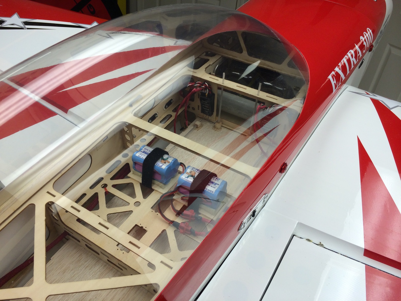

Just a quick question about batteries,I have got a regular 9 channel receiver Spektrum, along with a power expander from Red Wing RC, using 1230 Savox servos, what batteries would be good for this setup? Also what about ignition?
3dmike
I will also throw in the Fromeco Relions 7.4 Lilo batteries. I use them and they rock. I use two Relion 7.4 2600mah into the powerboard regulated to 6 v which looks like you will have to do the same with the Savox 1230's. The batteries last forever and if you go to the field with both fully charged you can fly hours and hours with out having to charge! If you get the 5200's you won't even have to give it a second thought to charging at the field!
amstd7
Thanks guys for the input, just wanted to make sure I had enough battery, btw thats an awesome aircraft bbrown!
