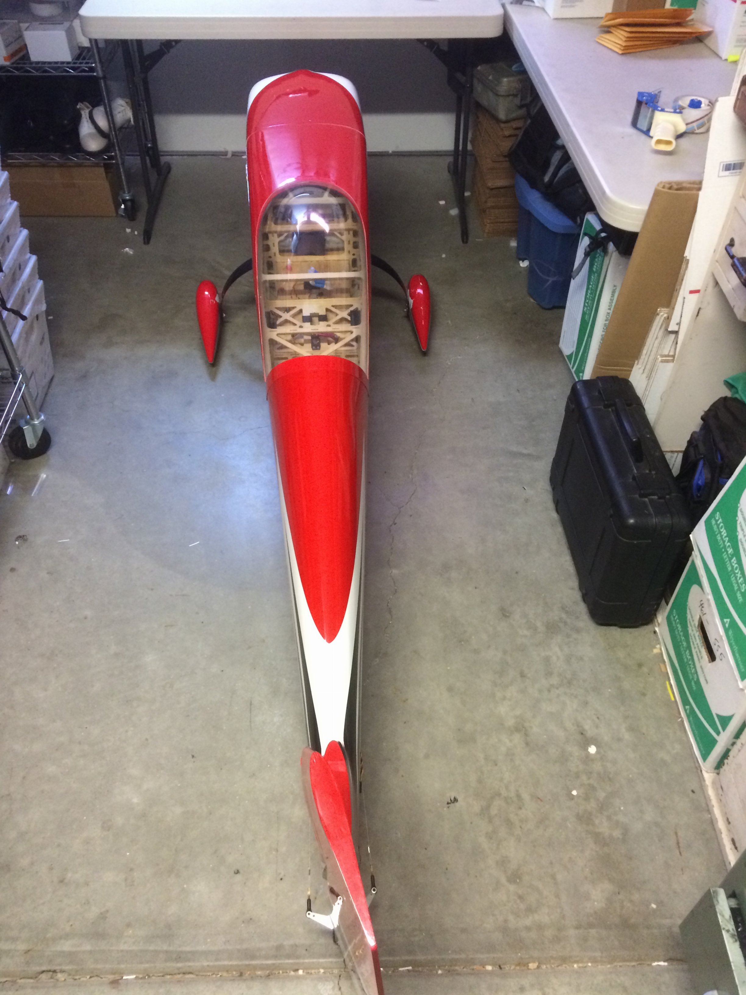

photo (1).JPGjust picked up a slightly used 104 with 7950th servos all around for a deal, only issue is the covering on the bottom of the plane came off due to smoke oil getting into the joints, is there a trick to making sure it is clean enough for the new covering to stick properly.
amstd7
Depending on the severity of the oil in the wood, you may could take and lightly sand the parts and put a coat of Coverite Balsarite from Tower Hobbies on the wood.
The part number is COVR2515. Hope this helps.

I bought a second 104 to replace my first one.
I set it up with the best components and glued everything I could reach.
On the 42nd flight, when I stopped rolling in a maneuver, the tail kept rotating and snapped off. All that was holding the tail on was my pull-pull cable. I was able to land it without damaging anything but the fuse.
I called EF and explained the story. They told me to email them pictures. I did. They responded saying that I must have had a poor setup (bad servos) which could have caused flutter, I didn't, my set up was perfect. I was persistent in making a point by calling them and emailing them for 3 weeks where I never received another email response and a lack of phone support. After 2 months of trying to resolve the issue, I was offered a SMALL discount on a fuse when it came in stock (which it hasn't, and its been 7 months).

what areas? not wanting to stir the pot, but I have a 104 on the bench and want to make sure that does not happen
In the tail.
Peel the covering off the bottom and wick CA into all the glue joint. add cross bracing. Reinforce where the cross pieces connect to the formers, and where any stringers and sheeting connect to formerss with stock, ca epoxy and micro-balloons....
also, where the last former connect to the tail with a flat plate, really get CA into that piece.

Can you say where/what you saw? Any other mods?
3dbandit
Jacob, I'm going to move this discussion over to the 104 EF thread where it is more appropriate.
I don't want to comment on specific individuals, but I did see some "differences".
Nothing was done that I didn't already mention in my previous post.
This is kinda of disconcerting... I'm giving some thought to cutting open my 104 to reinforce it now.
I'm also interested to hear any thoughts/opinions/experiences from others with the 104. Anyone else out there notice any issues in the tails?
