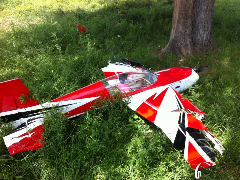

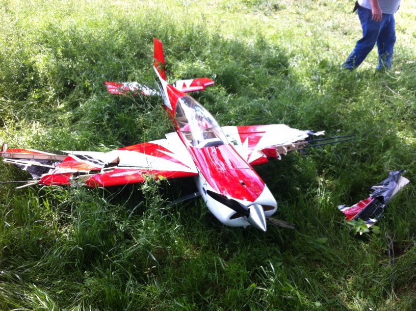

My little girl, she was about 1 years of age, i had left my transmitter (JR 9503) next to my computer. When i got home, i saw the transmitter on the floor with the antenna laying to the side. I opened up the transmitter, and soldered it back together. Then i totally forgot about it. One week later, I go to the club, and did not do a range check. I take my airplane off, and immediately once it got airborne, it went into fail safe mode!!!
The airplane flew over a lake, and at a very low speed, went into a tree, then it came down, and landed on top of a cow. This is what it looked like when we got to the cow pasture...
There was some damage to the wings and stabs, and the landing gear. But otherwise, the fuselage was intact.

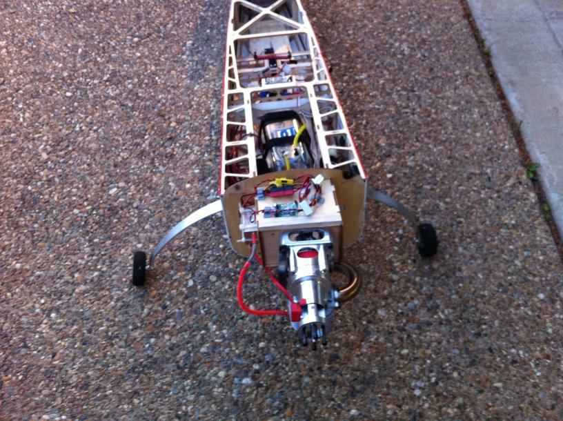

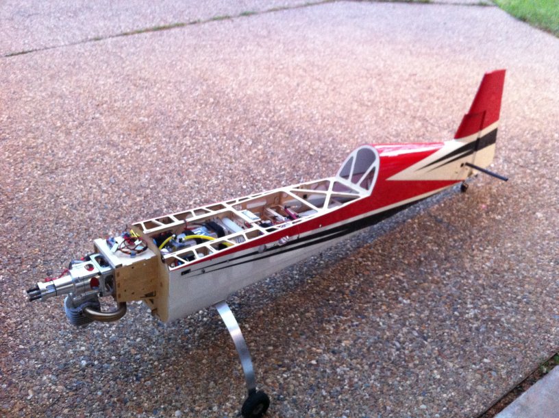

this is what it looked like when i gutted it. I ordered new wings/stabs/canopy/prop, and i sent the Tx to HH, all was good and she was back in the air. Can you believe, i have since sold this airplane, and someone else still has it!! this was about 4 years ago.
