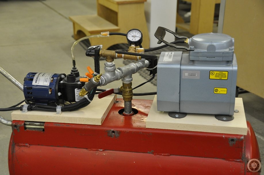

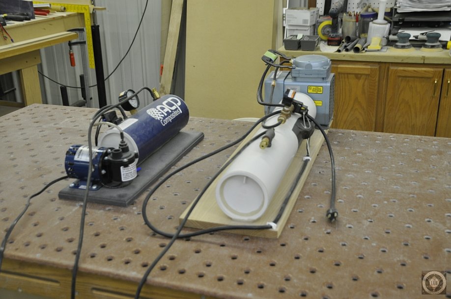

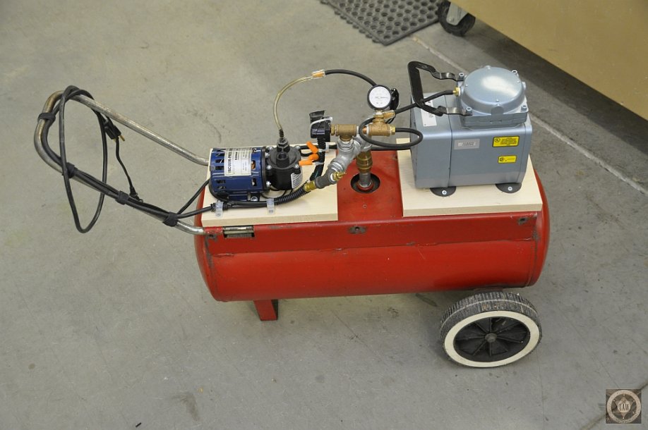

Well, it is plainly obvious that I will never build wings without a vacuum system again. So, I figured it was time that I made my system a little more permanent.

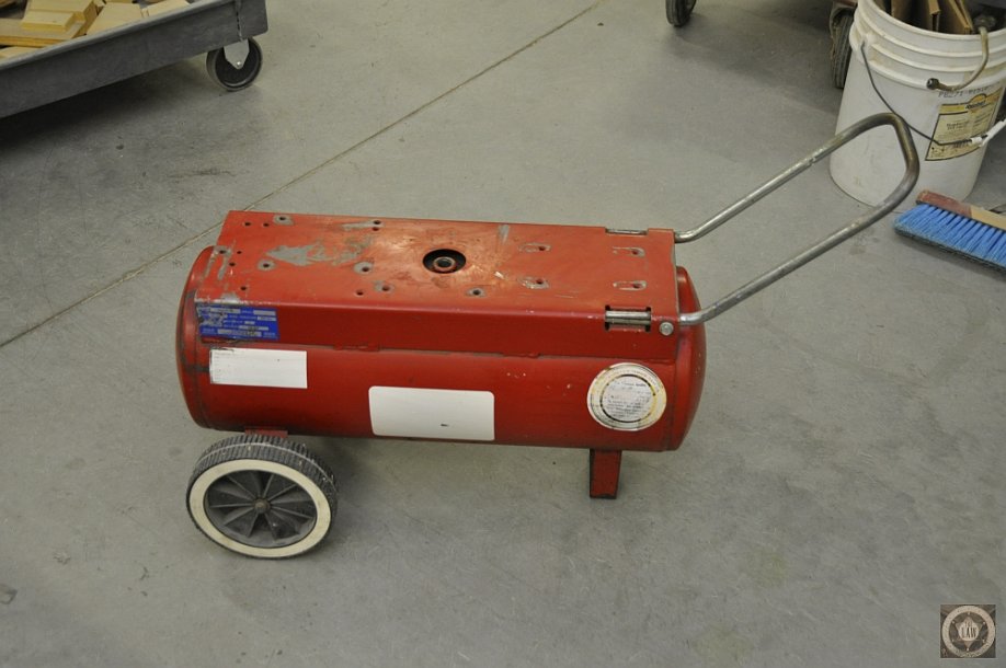

My mom had this old air compressor and the thing would literally run for 10 minutes solid just to pump up this 10 gallon tank. So all the workings were stripped off and I made a little manifold system to hook up my pumps. Now, I like the idea of having redundant pumps in case one fails or a switch fails and I have left something in a bag overnight, or I leave the shop for a few hours and return to unhook the bags. so I made the manifold with the following:
1 - ball valve to close off and maintain vacuum in the tank but disconnect all other hoses and pumps
2 - A "tee" to separate the pumps.
3 - One common vacuum gauge
4 - Duel electronic vacuum systems, one for each pump
5 - One mechanical safety valve to prevent the system from vacuum over 12 Hg
6 - One line exit to hook up a daisy chain hose to hook up four bags.
I'm cutting wings for an Extreme Flight Edge this week and will look forward to trying this baby out! It was much much easier to sequence the electronic switches the way I wanted with the pumps using a common tank.
