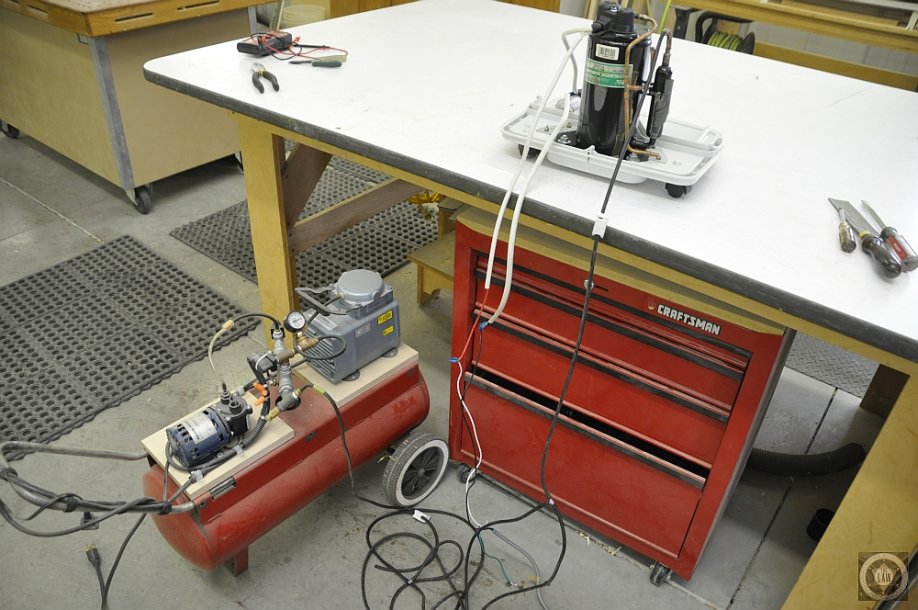

I should note, for the 4.5 hours that the tube was in the vacuum bag, my pump ran TWICE!!      10 gallon vacuum reservoir is pretty badass!!
I was going to ask how often you pumps would kick on with that big tank. How long did it take to pull the air out of the tank when you first fire it up?
Maybe 15-20 seconds. If I was not using 1/8" hose it would be way less. Even 1/4" line would probably only take a few seconds. I'll bet it will run a few more times with the wings I'm going to vacuum in the next day or two just because the foam holds a little air. I'll keep track of it when I get those going.
That is a lot faster than I thought, but you do have two pumps going. That is very cool.
