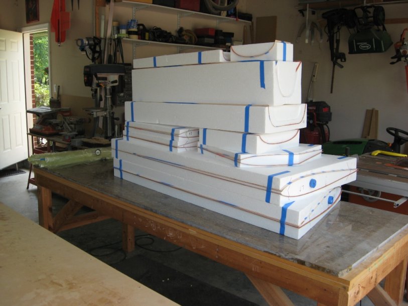

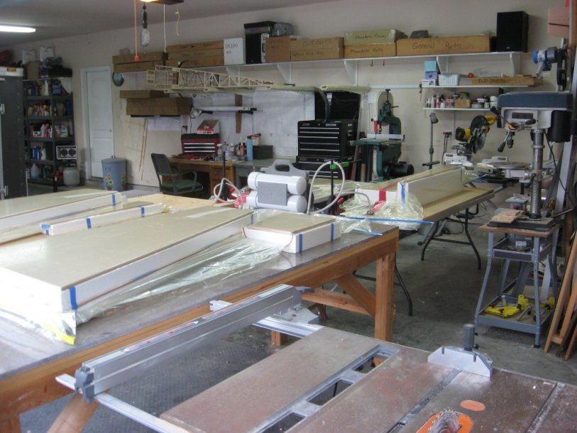

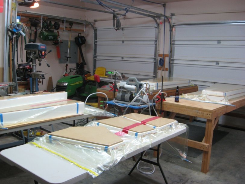

Great job explaining things Terry. Glad you finally saw the light and made the switch to bagging (inside joke)! Anyway, I know I'm coming into this thread late but saw where using multiple bags was mentioned. The attached pics show all the foam being bagged at one time for an entire plane using 4 bags. This was done using a home made vacuum press with the fittings and gate valves needed to control the individual bags.
